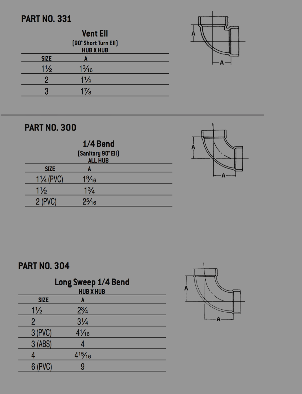

Here are the dimensions of the three common hub/hub ABS elbows. IIRC, Chinook used a normal sanitary ell there (so not a long sweep, and not a short turn either, but the middle bear). If I'm figuring it right, that means the short ell would gain about 3/4" in "height" for there to be pipe between the downturned hub and the grommet. So not the ideal gain, but better than nothing. Probably wouldn't be advisable if one is the type to fill both sink bowls to the brim and then pull the plugs simultaneously; but I think for most typical Chinook use it would be okay. This does carry the shower drain water too. However TP and other larger stuff of course doesn't take this route since it's going into the black tank. Wish it was more gain though. If Chinook had used a long sweep elbow (which should technically be used), then we could have gained more by switching to the short ell.

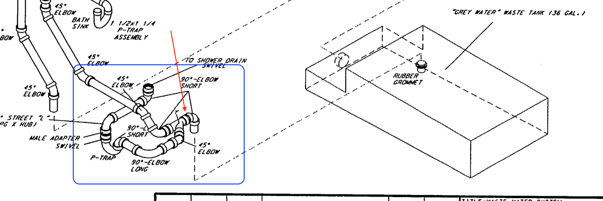

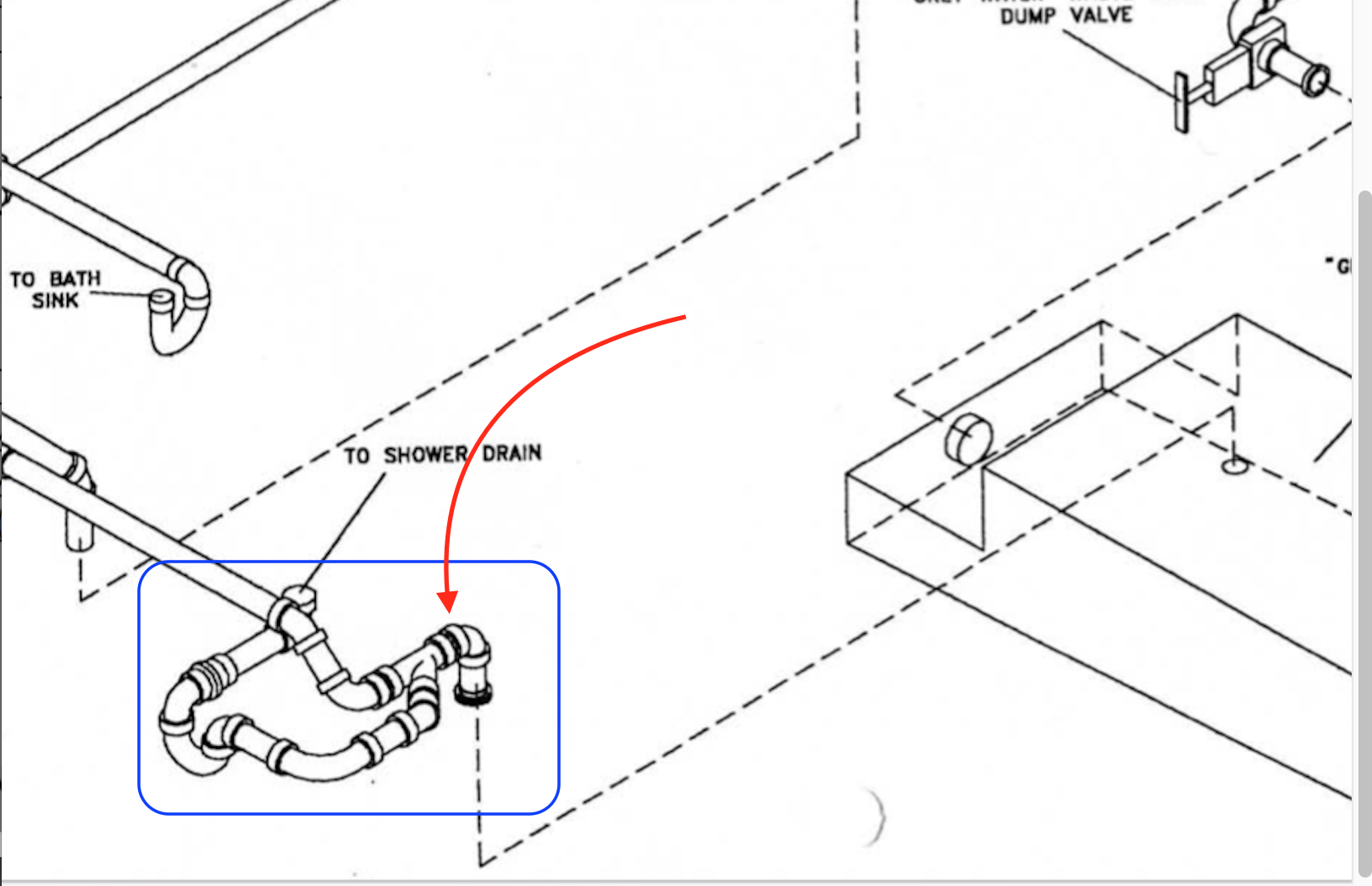

As a reminder, here is what we are working with. I note that the drain piping is also acting as the tank vent (but not via the proposed Hepvo leg, which is pure drainage).
First drawing is 1998 manual. Less cluttered as they don't show all the details of the pipe sizes. Blue area is the "mess" of pipes leading up to the crack-prone spot. Red arrow shows the exact crack spot.
Second drawing is the same area from the 2000 manual. A bit more cluttered but they show the pipe sizes and fitting types. Lastly, a very clumsy drawing showing the concept of using a Hepvo trap on the shower. Not sure this really solves the "last drain elbow to hub" height problem though. So point #3 is less impactful. But might be something to consider if dropping the grey tank anyway. I haven't fully worked this out in my mind though, so it's just musing at this point. BTW, if anyone is going to make an access hole for this project, I can give some measurements. I already made the four corner holes and cut through the first layer of flooring (which, I then found out, that the floor there - at least in a 1999 - from the top down is 1/2" plywood, 1/2" white bead type foamboard, (then I think I will find) 1/2" plywood, and a layer of fiberglass cloth/resin, tho I have not cut out the bottom plywood layer yet. I have cut the intial square out of the top layer, which I may or may not expand.

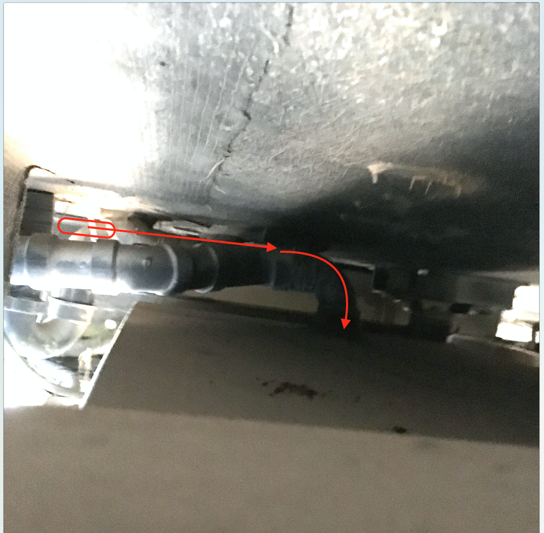

The grey tank doesn't have a "neck" that sticks out, like say you would see on a plastic fuel or water tank (or a radiator). Instead it simply has a circular hole cut in the top. Into that hole goes a large grommet. Into the grommet goes a rigid pipe of 1.9" OD. I don't think a "soft" pipe would interact properly with the grommet, which is meant to sort of stretch/lock around something hard. This is a typical waste tank entrance.
The real issue is that there is just not enough clearance between the top of the grey tank and the floor of the Chinook to do anything really easy/proper/off-the-shelf. Now, the originals seem to last 20+ years, so that's something. But, it was a slightly compromised installation. Perhaps it would have been better to have a recessed notch in the tank (as there was in the original fresh water tank where the fill entered) to accomodate the fittings. OTOH, that would put the grommet under more pressure (to leak), so perhaps that's why not on a waste tank.

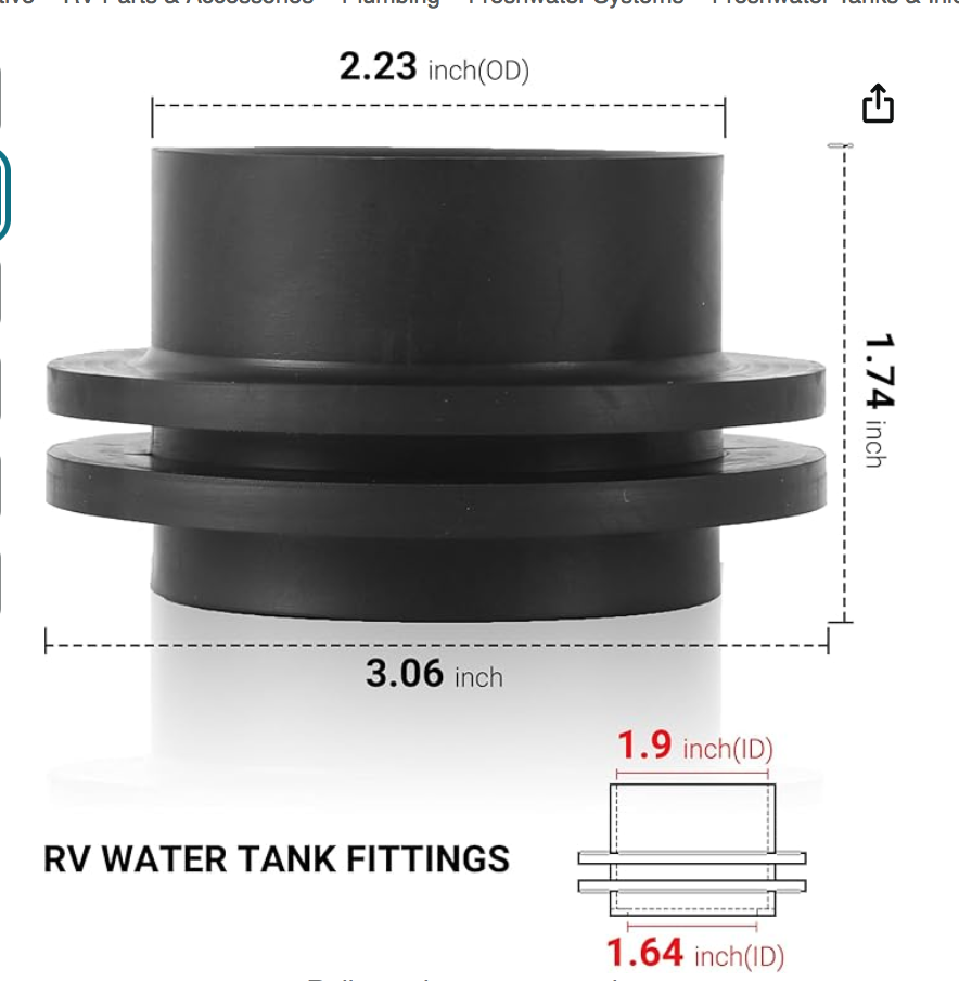

I'm now thinking that bending up a section of 1.9" OD tubing would be the way to go. Nice gradual bend, nothing wider (like the hub of the ABS elbow) to try to mash into the grommet. Then use a Hub-to-spigot Fernco at the crack-prone joint, so the tiniest wiggle won't try to crack it again. Or, same concept but with an off-the-shelf short elbow and X" of pipe glued into it on the tank side (would hold hub 3/4" further above grommet top). Same Fernco joint except with a hub-to-hub Fernco.

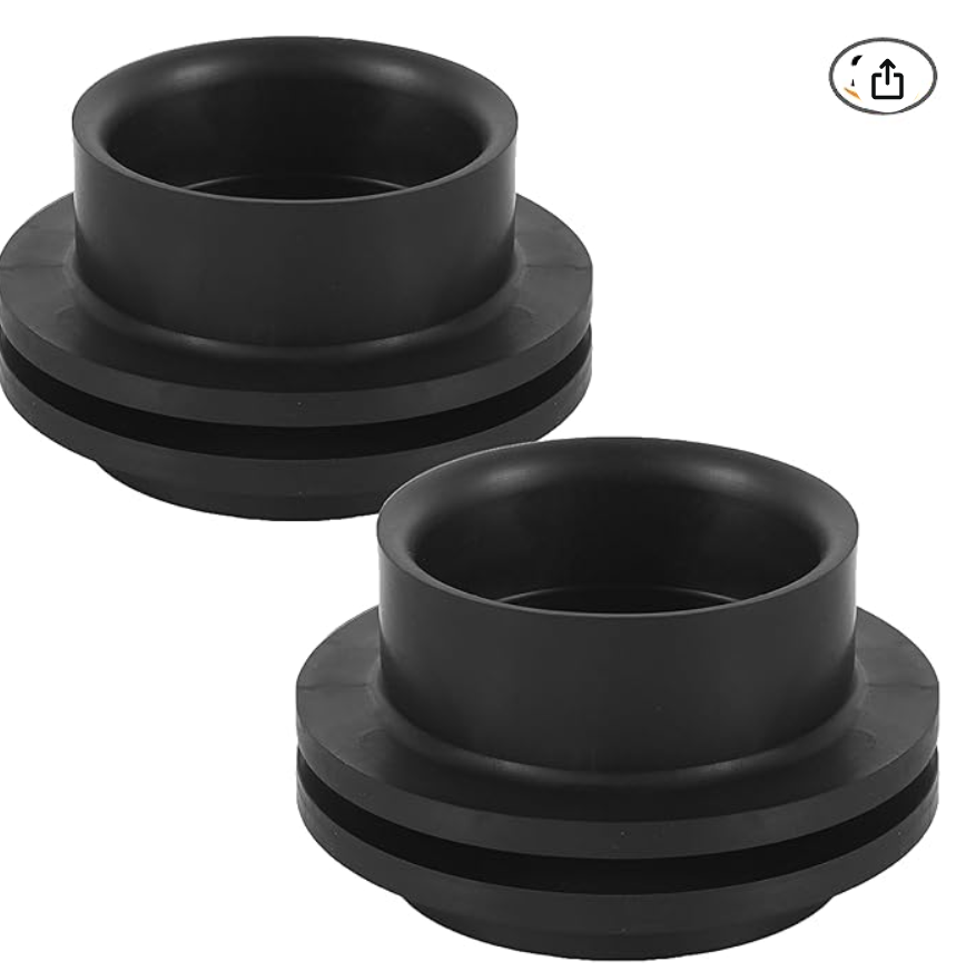

Here is what the grommet looks like. The tank just has a hole drilled through the middle of the flat top surface
Re: Grey (gray) tank leak

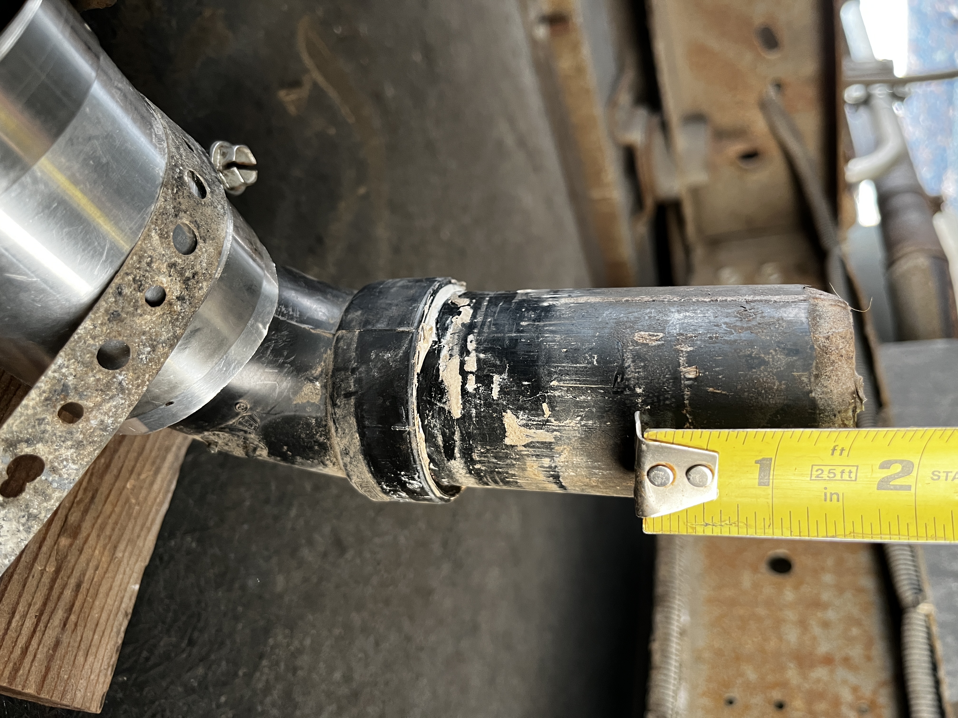

That is the grommet I used. It has a stop on the interior at 1-3/4s down. The pipe is 3-1/2" long. Your tank got bopped up, all right!
my block at the elbow is only 1/2", I need to make it thicker. The next block upstream is 3-1/4" thick. It must be thicker than that to flow properly, unless I am looking at it upside down and backwards!
you can see the friction wear on the downpipe.
I am not quite sure how a hatch will work with all the attached plumbing under there...

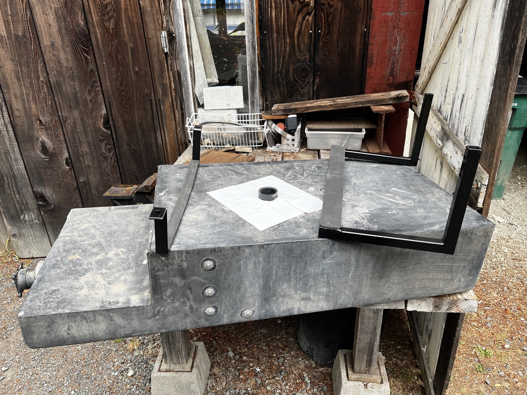

Tank is installed...
two or three people would have been better, one person....not so much
I took off that hanger strap, and no block, so there was less pressure on it, it seemed better to leave unstressed.
That entire downpipe at the end is inside the tank, the elbow butts up against the grommet, as in blu-go's post
Bill's instructions for his grommet said to use butyl caulk around grommet and tank, I did not have any, but I did have RV butyl tape, so I used that. seems very snug, and NO LEAKS!
the new ValTerra valves are worth it, I think $50 or less for both.

I left on a trip just after my last post, so never saw this. Yes, this is what I was saying would be great, BUT if the "street" side of the elbow was quite a bit longer (and then we could cut it to the perfect length, but that would be longer than the typical street elbow you linked to).
Otherwise, short of anything custom, one needs to use a normal elbow (hub x hub) and then glue a length of pipe into it, like Mendodave shows above (as Chinook did). A short hub x hub would buy a tiny bit more height, but nothing major.
Mendodave: Yay, great to hear your repair worked well.
BTW, my tank didn't really get pushed upward (it's still tight to the metal brackets just like it always was). I mean, yes it was momentarily "bopped" as it touched the grass hump, but I believe that only cracked the pipe because it's ancient ABS in a stressed position, and kind of a built in stress riser -- because there is like 1/16" inch of pipe between two glued hubs. I have some photos of the plumbing from many years ago, and that elbow/hub was already sinking into the tank grommet (just due to lack of space in the design, I think). Maybe that's what you meant though.
Anyway, it's not the greatest setup by design, but then no-one wants the floor of the rig any higher or the ground clearance to be any less. Too bad there were not Hepvos in use back then for them to have used - would have helped some.
I still have on my list to see if I can do a similar repair through my "trap door," but nothing to report yet.
