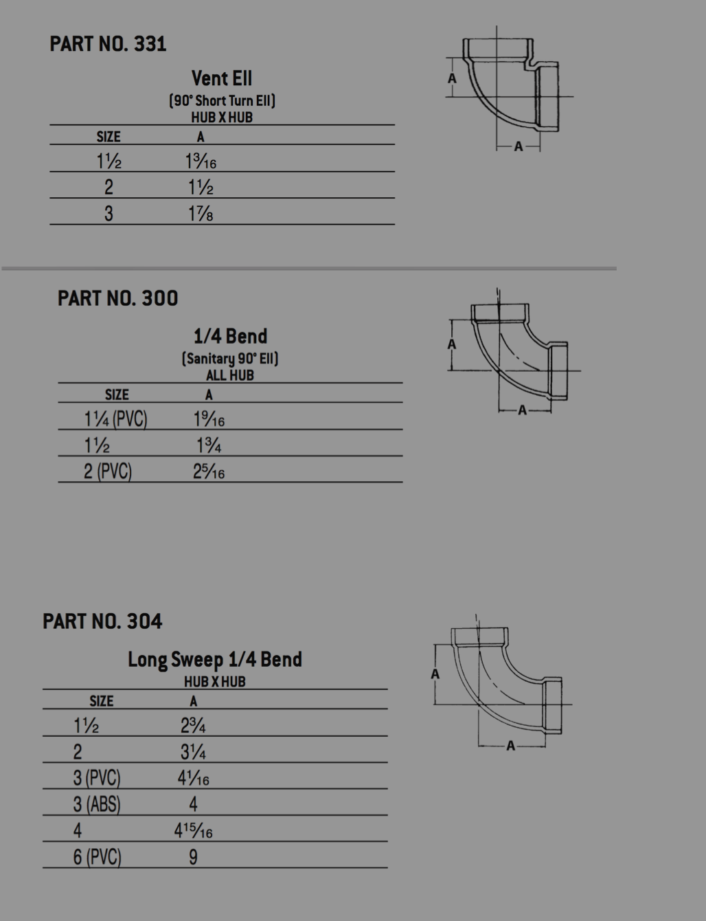

For this situation I think what would be perfect is a 90º elbow just like what was there originally, only with a hub (female) only on one side --- the side that connects to the incoming plumbing. Then on the side that goes into the tank, it could be like a street elbow (no hub, just pipe diameter) only it should be longer than normal. Long enough to go in through the grommet and then clear the inside of the grommet by maybe an inch or so [Edited to say: Or maybe only 1/2-3/4" -- I forgot this is also the vent, so any amount it sticks down into the tank is essentially lost capacity].
Then one could use a hub/hub Fernco on the crack-prone joint (which might actually be preferable to the original ABS/glue/ABS) and the other end could just cruise in through the grommet.
The "problem" with fiberglassing (and why I'm considering the short "vent" elbow instead) is that with fiberglassing it's easy to make one side smooth, but then you'd typically have more material on the second side. It has to be somewhere! But with this you don't really want extra material on the inside (water flow) or on the outside (grommet fitment). 3D printing would solve that - cool idea.
Here are the dimensions of the three common hub/hub ABS elbows. IIRC, Chinook used a normal sanitary ell there (so not a long sweep, and not a short turn either, but the middle bear). If I'm figuring it right, that means the short ell would gain about 3/4" in "height" for there to be pipe between the downturned hub and the grommet. So not the ideal gain, but better than nothing. Probably wouldn't be advisable if one is the type to fill both sink bowls to the brim and then pull the plugs simultaneously; but I think for most typical Chinook use it would be okay. This does carry the shower drain water too. However TP and other larger stuff of course doesn't take this route since it's going into the black tank. Wish it was more gain though. If Chinook had used a long sweep elbow (which should technically be used), then we could have gained more by switching to the short ell.
Maybe I'll re-visit my fiberglassing idea, with the idea of putting the extra material on the outside (where it would mash into the hub), but keeping it relatively thin and streamlined. Certainly would be an improvement over having a full sized hub crusing its way in there. Tho nothing changes the fact that there is very little vertical room to work with.

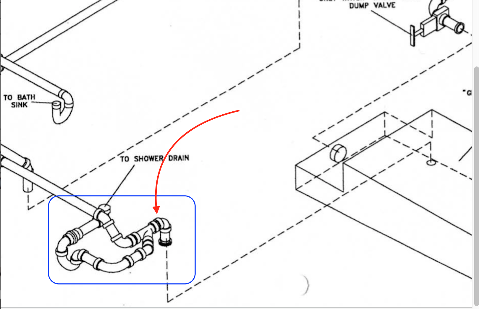

As a reminder, here is what we are working with. I note that the drain piping is also acting as the tank vent (but not via the proposed Hepvo leg, which is pure drainage).

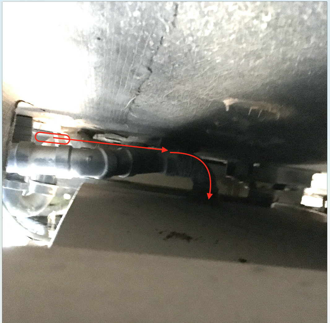

First drawing is 1998 manual. Less cluttered as they don't show all the details of the pipe sizes. Blue area is the "mess" of pipes leading up to the crack-prone spot. Red arrow shows the exact crack spot.

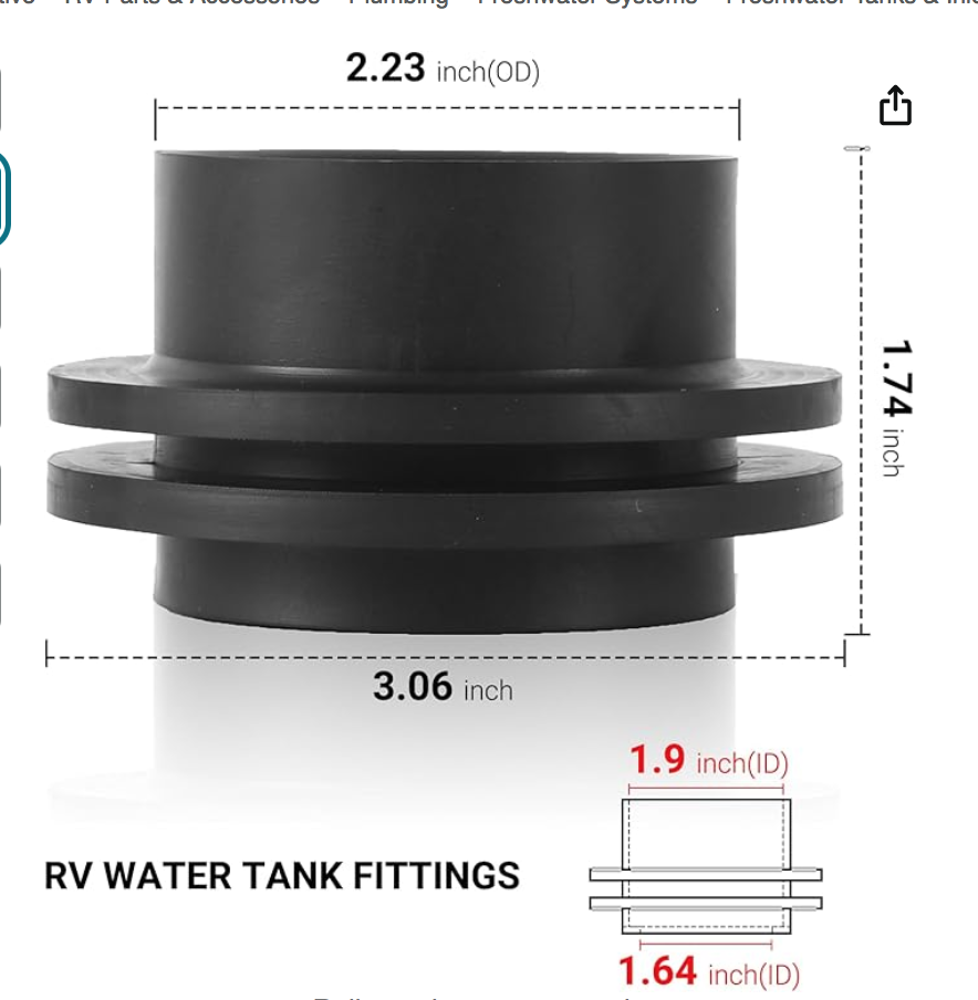

The grey tank doesn't have a "neck" that sticks out, like say you would see on a plastic fuel or water tank (or a radiator). Instead it simply has a circular hole cut in the top. Into that hole goes a large grommet. Into the grommet goes a rigid pipe of 1.9" OD. I don't think a "soft" pipe would interact properly with the grommet, which is meant to sort of stretch/lock around something hard. This is a typical waste tank entrance.
The real issue is that there is just not enough clearance between the top of the grey tank and the floor of the Chinook to do anything really easy/proper/off-the-shelf. Now, the originals seem to last 20+ years, so that's something. But, it was a slightly compromised installation. Perhaps it would have been better to have a recessed notch in the tank (as there was in the original fresh water tank where the fill entered) to accomodate the fittings. OTOH, that would put the grommet under more pressure (to leak), so perhaps that's why not on a waste tank.
I'm now thinking that bending up a section of 1.9" OD tubing would be the way to go. Nice gradual bend, nothing wider (like the hub of the ABS elbow) to try to mash into the grommet. Then use a Hub-to-spigot Fernco at the crack-prone joint, so the tiniest wiggle won't try to crack it again. Or, same concept but with an off-the-shelf short elbow and X" of pipe glued into it on the tank side (would hold hub 3/4" further above grommet top). Same Fernco joint except with a hub-to-hub Fernco.
Here is what the grommet looks like. The tank just has a hole drilled through the middle of the flat top surface

That is the grommet I used. It has a stop on the interior at 1-3/4s down. The pipe is 3-1/2" long. Your tank got bopped up, all right!
my block at the elbow is only 1/2", I need to make it thicker. The next block upstream is 3-1/4" thick. It must be thicker than that to flow properly, unless I am looking at it upside down and backwards!
you can see the friction wear on the downpipe.

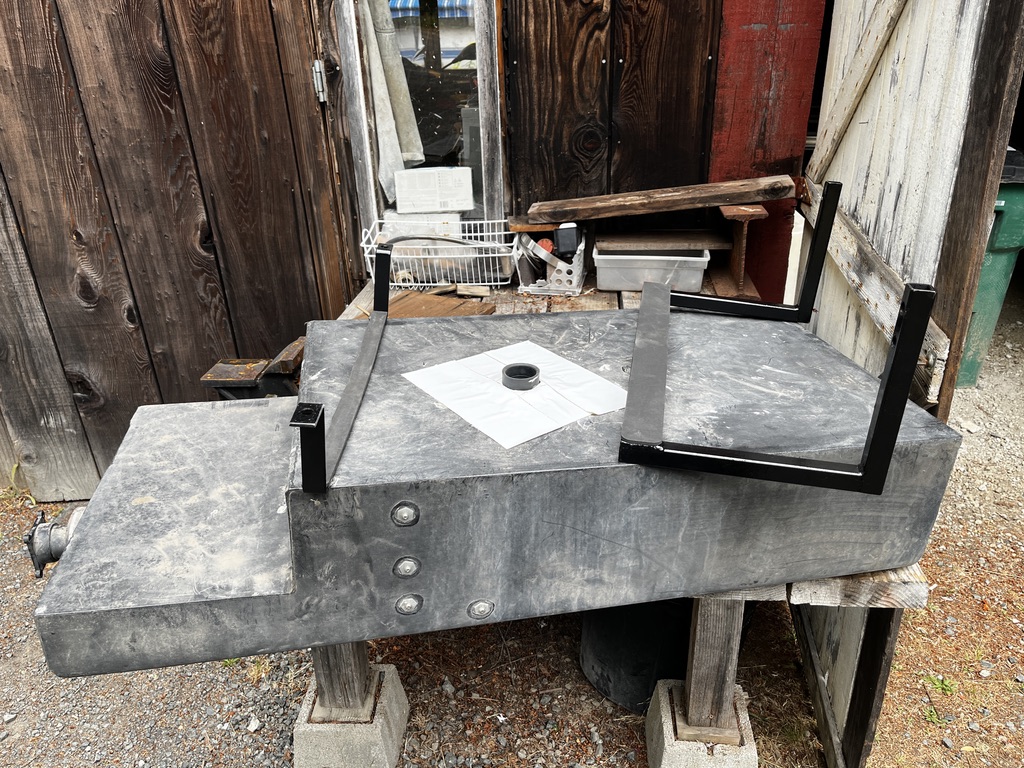

Tank is installed...
two or three people would have been better, one person....not so much
I took off that hanger strap, and no block, so there was less pressure on it, it seemed better to leave unstressed.
That entire downpipe at the end is inside the tank, the elbow butts up against the grommet, as in blu-go's post
Bill's instructions for his grommet said to use butyl caulk around grommet and tank, I did not have any, but I did have RV butyl tape, so I used that.
seems very snug, and NO LEAKS!
the new ValTerra valves are worth it, I think $50 or less for both.

BTW, my tank didn't really get pushed upward (it's still tight to the metal brackets just like it always was). I mean, yes it was momentarily "bopped" as it touched the grass hump, but I believe that only cracked the pipe because it's ancient ABS in a stressed position, and kind of a built in stress riser -- because there is like 1/16" inch of pipe between two glued hubs. I have some photos of the plumbing from many years ago, and that elbow/hub was already sinking into the tank grommet (just due to lack of space in the design, I think). Maybe that's what you meant though.
