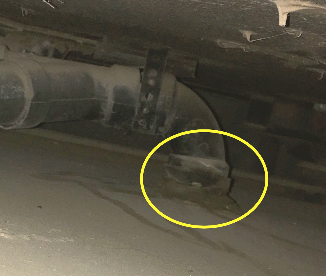

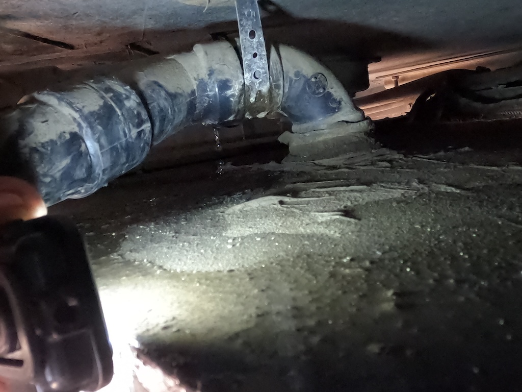

While testing for leaks I discovered a leak!
the last elbow going into the grey tank seems to have chafed through and leaks. I think it is the hanger strap.

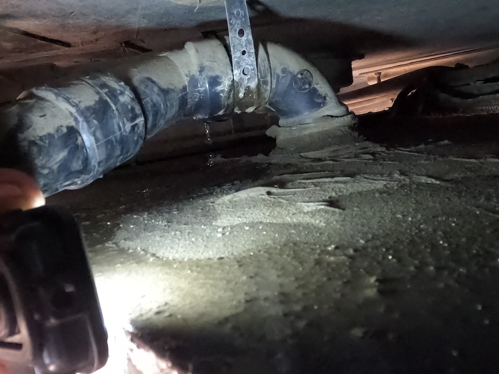

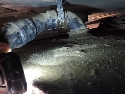

here's a drip photo, I stuck my GoPro up in there

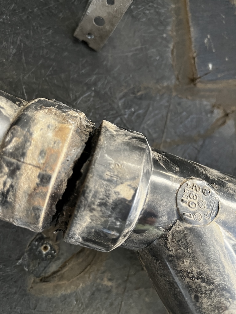

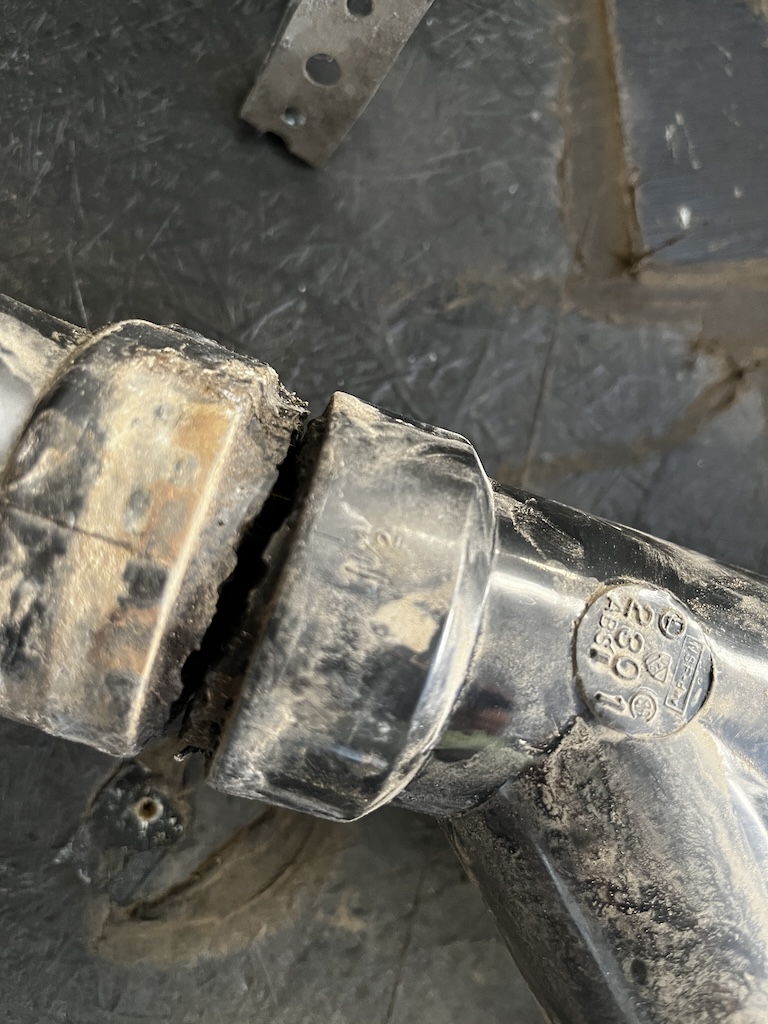

inlet pipe 3/4's cracked through.
both tank strap holders have to come off, and the 4 little bolts holding the valve in.
then just pull down.

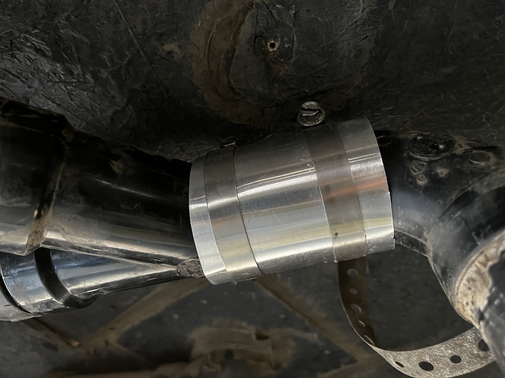

I wrapped junction at crack with Gorilla waterproof tape (gnarly stuff), covered that with flashing, and held it all down with hose clamps.
that should outlast me!

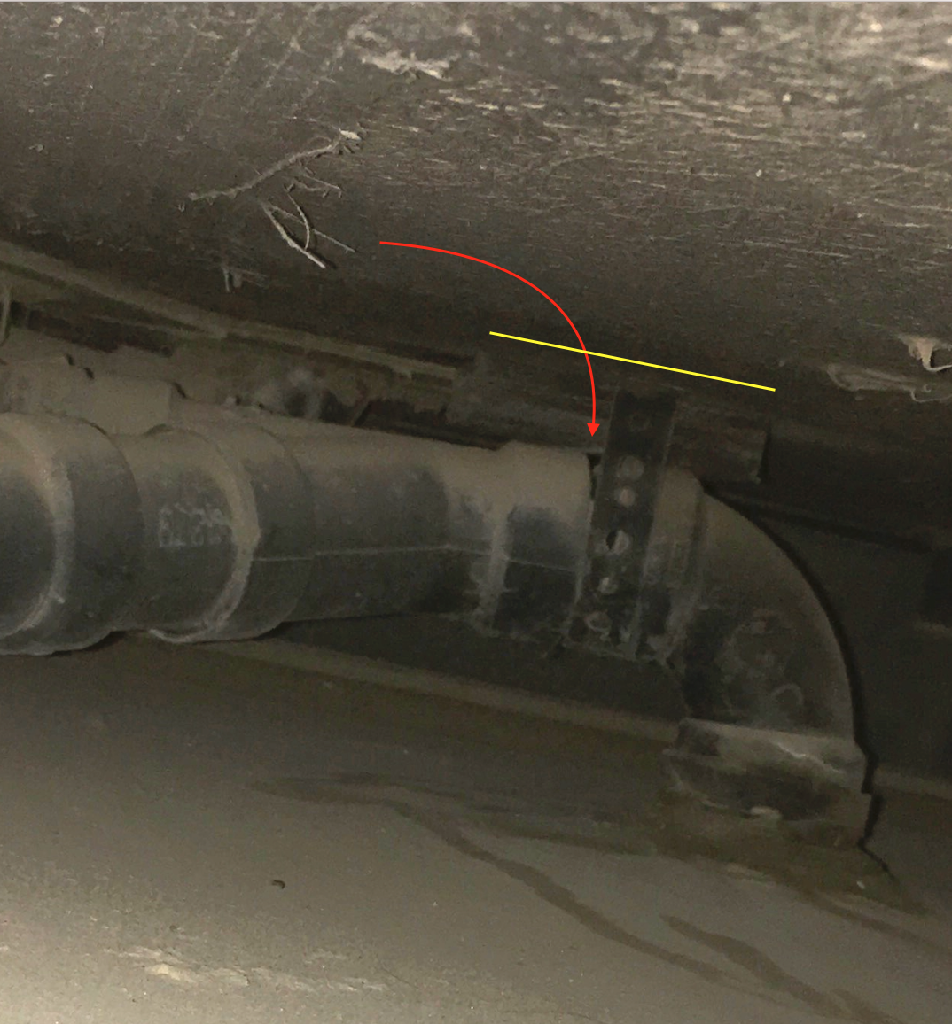

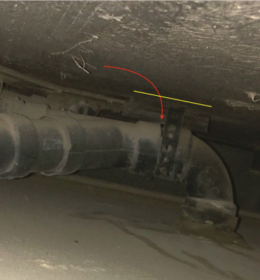

This thread caught my eye because a while back I suddenly had a mystery grey tank leak. Well, that sounds like it was completely without reason but actually I had slightly touched the tank on a grass mound while driving into a campsite. Nothing happened to the tank but suddenly water was spilling off the top of the tank instead of going into it.
I rigged up a video camera under there, then poured water down the sink....
mendodave.... look familiar?
And mine actually does have a support block above that whole hub/hub joint. But old ABS gets brittle... and the break is right where the strap presses. The hub being in the way of the whole shebang settling a bit more levelly into the grommet doesn't seem like it helps either.

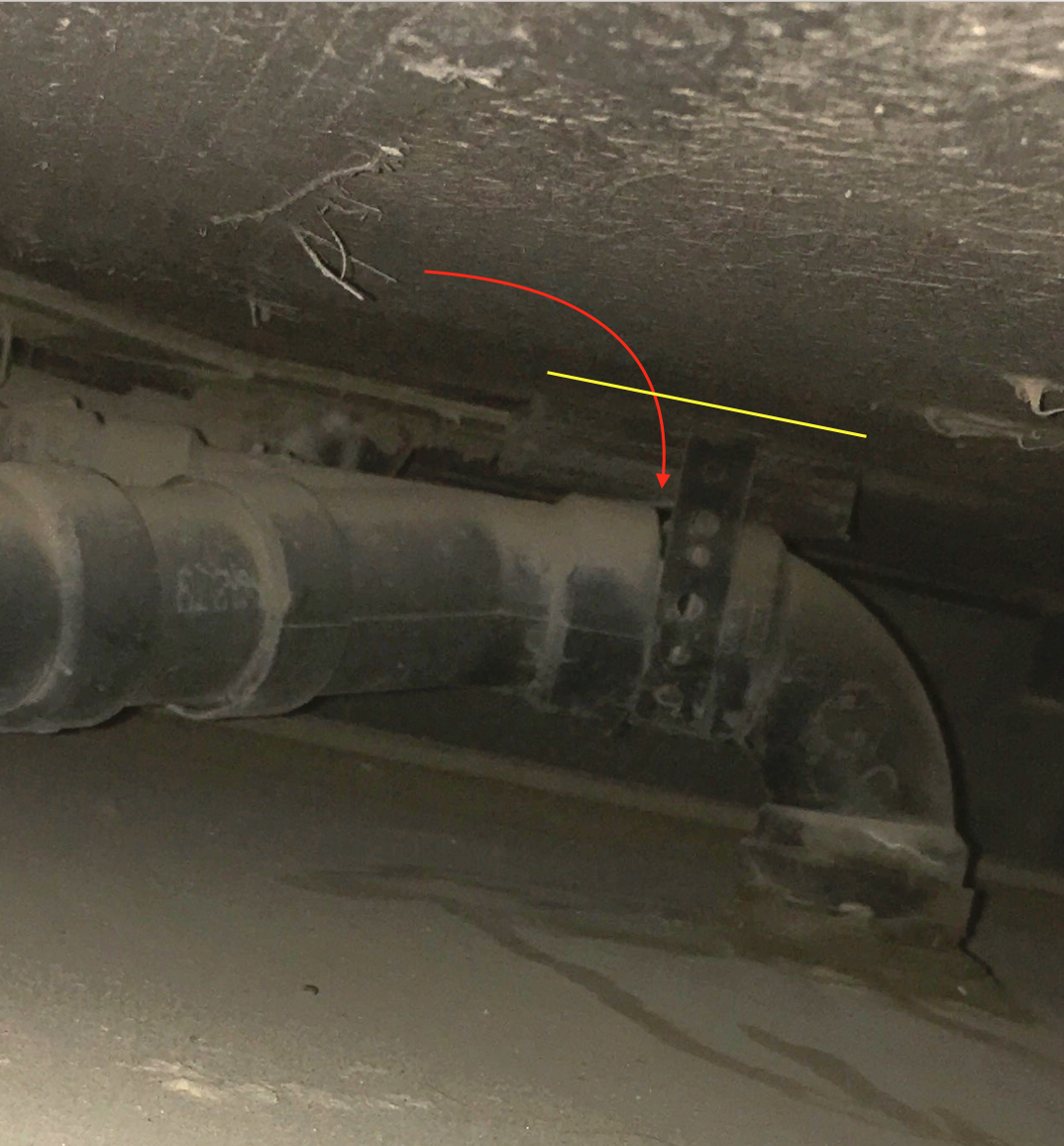

The red arrow points to the crack around the upper half of the pipe (which probably goes all the way around but it's gapping at the top). The yellow line is just above the support block.
I also see yours has another issue that they probably all have (at least mine does). That is that the "hub" part of the elbow that leads into the rubber grommet/tank hole has partially mashed down into the grommet. That doesn't seem to help the overall geometry. I looked and looked to see if there was a "street" elbow that had a longer arm on the "street" side.... to no avail. Thought about fabbing up something (laying up fiberglass) but then came up with a (tentative) plan involving a Fernco and some flashing.
Interesting to see your fix and hear that you dropped the tank. Your repair looks a lot like what I have in mind. I've been thinking about how to tackle this for awhile. It's tricky (as you know!) because the two hubs are practically on top of each other, and there's a whole "system" of branching pipes and etc. on the incoming side.
I had purchased a couple of Fernco couplers - one Hub to Spigot and one Hub to Hub. I had another type of coupler in the past that also had a metal wrap around it, but these Ferncos didn't, so I cut a piece of flashing to act similarly.

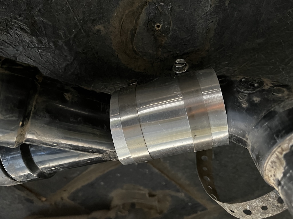

all ready to go in, we have rain coming in here and so this needs to wait a few days.
I also replaced the valves for grey and black tanks while there.

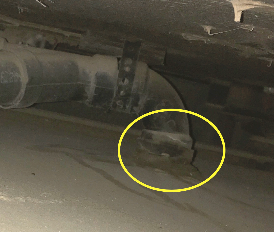

I would say it's a chunk of 3/4" thick plywood. But that said, I have a comment about that. See how on both of our setups, the hub of the final elbow at the grommet has "dug into" the top of the grommet? Well I bet it wasn't like that at first. But then over time that hub sunk (was pulled/pushed?) into the grommet so everything is lower and the geometry changes. So then the strap/block are the high point and putting stress on the area of the pipe that broke. At least that's a theory I have.mendodave wrote: August 22nd, 2024, 10:23 am Hi Blue!
I do have a question, how thick do you think your spacer there is?
I think this whole stress at the strap problem arose because they wanted to use the correct elbow (great) but then there was not enough vertical space to keep the hub (cuff) above the grommet so they kind of canted the whole works upward from the aft end to the block/strap. Then as the hub of the elbow sunk into the grommet the strap/block became a stress high point (?).
If the hub wasn't there (or the tank was lower, which obviously is not a good option), then that whole long pipe assembly could have run along level (slightly lower) and a thicker block could have been used and there wouldn't have been that weird "upslope" right at the strap block (stress point that cracked), plus the hub mashing into the grommet. But.... it's a tight spot. Maybe the whole thing could have been up higher with the use of Hepvo traps, but I don't think those were even a thing in the US back then.
I think what I'm going to do to (try to) alleviate the grommet mash is to either use a "short" Vent 90º elbow (which I think will have plenty of capacity for the volume of water that goes down a Chinook drain, though it would be insufficient in a house). OR, fiberglass a longer spigot (pipe diameter) onto a street elbow. Either method would let the elbow drop slightly (without a hub awkwardly mashing into the grommet over time changing the geometry) and at that point a slightly thicker block would be the right size, I think. So the strap is not "pulling up" on the whole assembly and trying to crack it. It would be nice if we could get it all settled, THEN put in the correct thickness block. Good luck with that though unless we could train a spider to go in there and work.
Caveat: Perhaps using the flexible joint you did, or the Fernco I plan to use makes point moot, though I still don't like the hub mashing into the grommet so might change that part anyway. And perhaps add a bit of thickness to the block so that whole set of pipes leading up to the strap is not going "uphill."

Here is what I mean about the hub of the normal hub/hub elbow mashing into the grommet. The plain new grommets (I have a couple on hand) do NOT bulge like that at the top. They are meant to have (thinner) plain pipe going through them, not a much thicker hub ("cuff") like on the end of a normal elbow.
