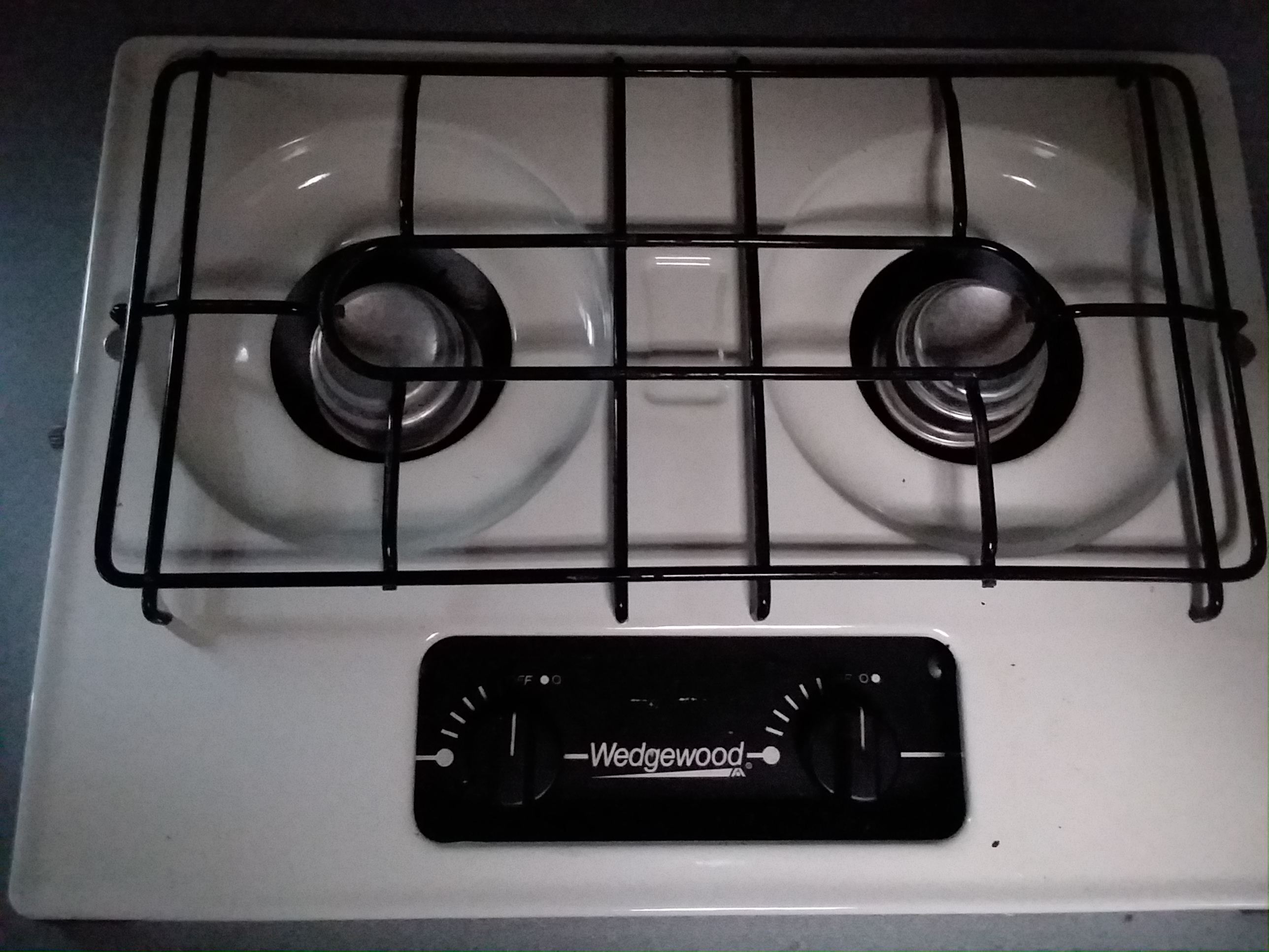

I have the Wedgewood 2 burner cook top in my Premier. Nice stove, but the grate rattles when underway, and it's pretty annoying. For a strategy to keep it from rattling, the two challenges are (1) heat tolerance, and (2) the ability to remove it easily for cleaning. I tried a few different approaches, all of which worked only temporarily (so I won't bother mentioning them). I resorted to taking the grate off each time I hit the road; it got pretty old after a couple years :( . I had some dime-sized neo magnets in my hand one day and decided to just push them up against the grate's alignment pins. Solved the problem. No more rattling, cost a couple of pennies, "should" handle the heat so long as they don't get above 600F, and it required no work or time. So simple that it almost doesn't seem worth posting, but since 2 little magnets have kept me from going nuts, I thought it might help someone else.
It's been a couple thousand miles and plenty of cooking, and it still works. If that changes, I'll update.

Good tip. I have some of those laying around and they are very powerful.

Great idea for a nagging problem. My wife refers to me as the squeak and rattle police. I am driven nuts by the various squeaks and rattles that are bound to occur when one is traveling down the road at 70 mph sitting in a 5.25ton house. Over the years, I have dealt with most of these nuances:
--felt stickies on the screen moldings where they meet the frame
--a drop of oil on the window latch where it meets the lock cut out
--quick epoxy and screw reinforcement of the wall where it meets the molding piece behind the sink and stove
--lock washers on other various screws (some hidden from view like the ones that hold the framing of the bathroom near the rear entrance hidden behind the carpeted bulkhead over the rear door
But the only fix I could come up with for the stove grates (I have two single heavy gauge pieces for my two burner) was to take them off and store them...fine, except when I forget to put them back on before going to bed for making coffee in the AM and have to get up, stoop down and pull them from one of the lower storage bins. BUT NOW--thanks to you Scott, I have a real solution!

I got replacement rubber tips for the grill legs, these might be the same http://www.rvshop.com/Wedgewood-Small-G ... 68595.html
