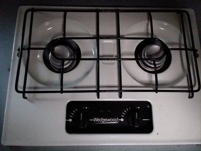

I have the Wedgewood 2 burner cook top in my Premier. Nice stove, but the grate rattles when underway, and it's pretty annoying. For a strategy to keep it from rattling, the two challenges are (1) heat tolerance, and (2) the ability to remove it easily for cleaning. I tried a few different approaches, all of which worked only temporarily (so I won't bother mentioning them). I resorted to taking the grate off each time I hit the road; it got pretty old after a couple years

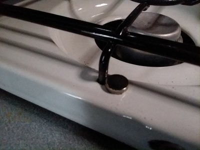

. I had some dime-sized neo magnets in my hand one day and decided to just push them up against the grate's alignment pins. Solved the problem. No more rattling, cost a couple of pennies, "should" handle the heat so long as they don't get above 600F, and it required no work or time. So simple that it almost doesn't seem worth posting, but since 2 little magnets have kept me from going nuts, I thought it might help someone else.

Good tip. I have some of those laying around and they are very powerful.

But the only fix I could come up with for the stove grates (I have two single heavy gauge pieces for my two burner) was to take them off and store them...fine, except when I forget to put them back on before going to bed for making coffee in the AM and have to get up, stoop down and pull them from one of the lower storage bins. BUT NOW--thanks to you Scott, I have a real solution!
