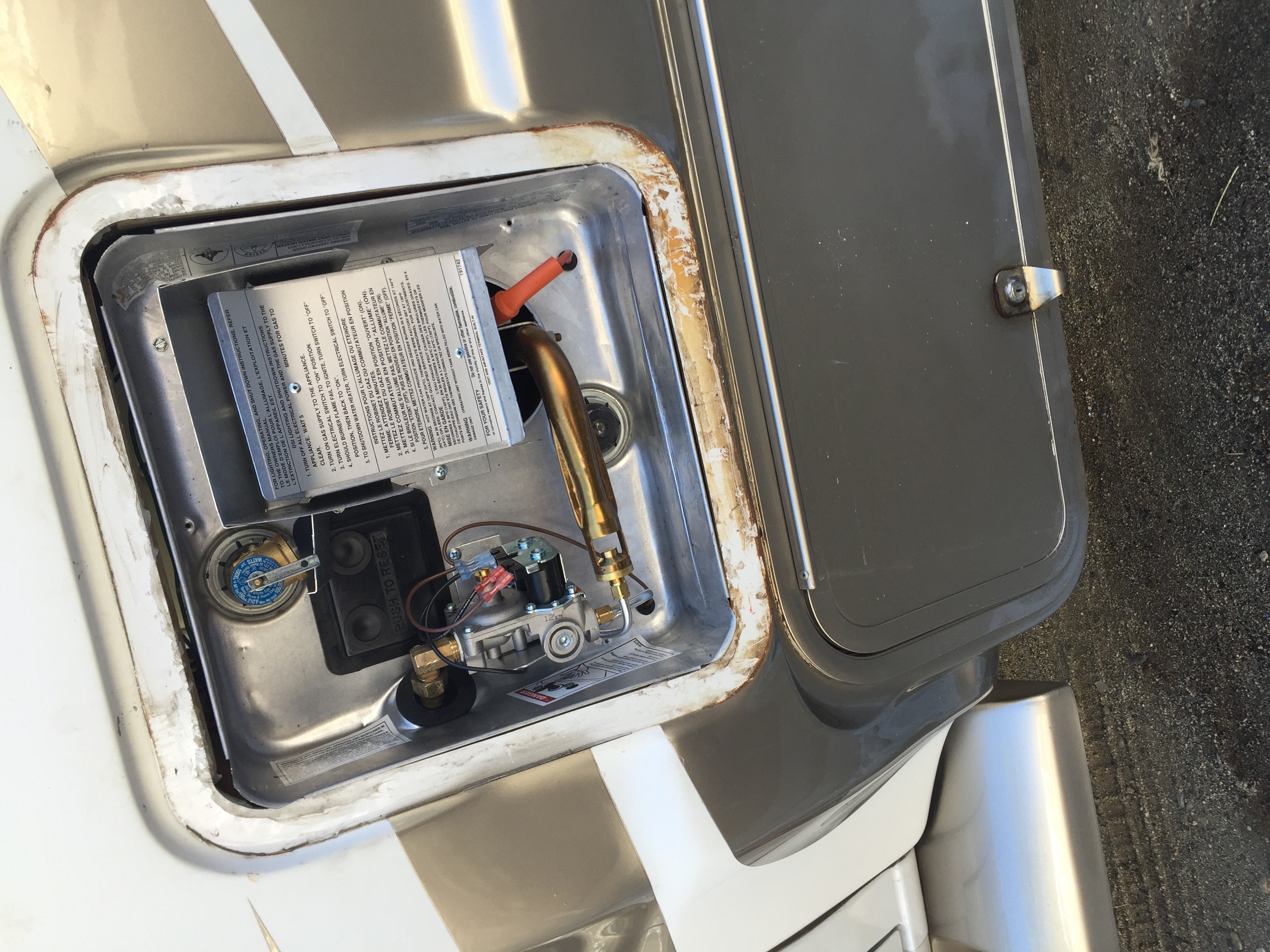

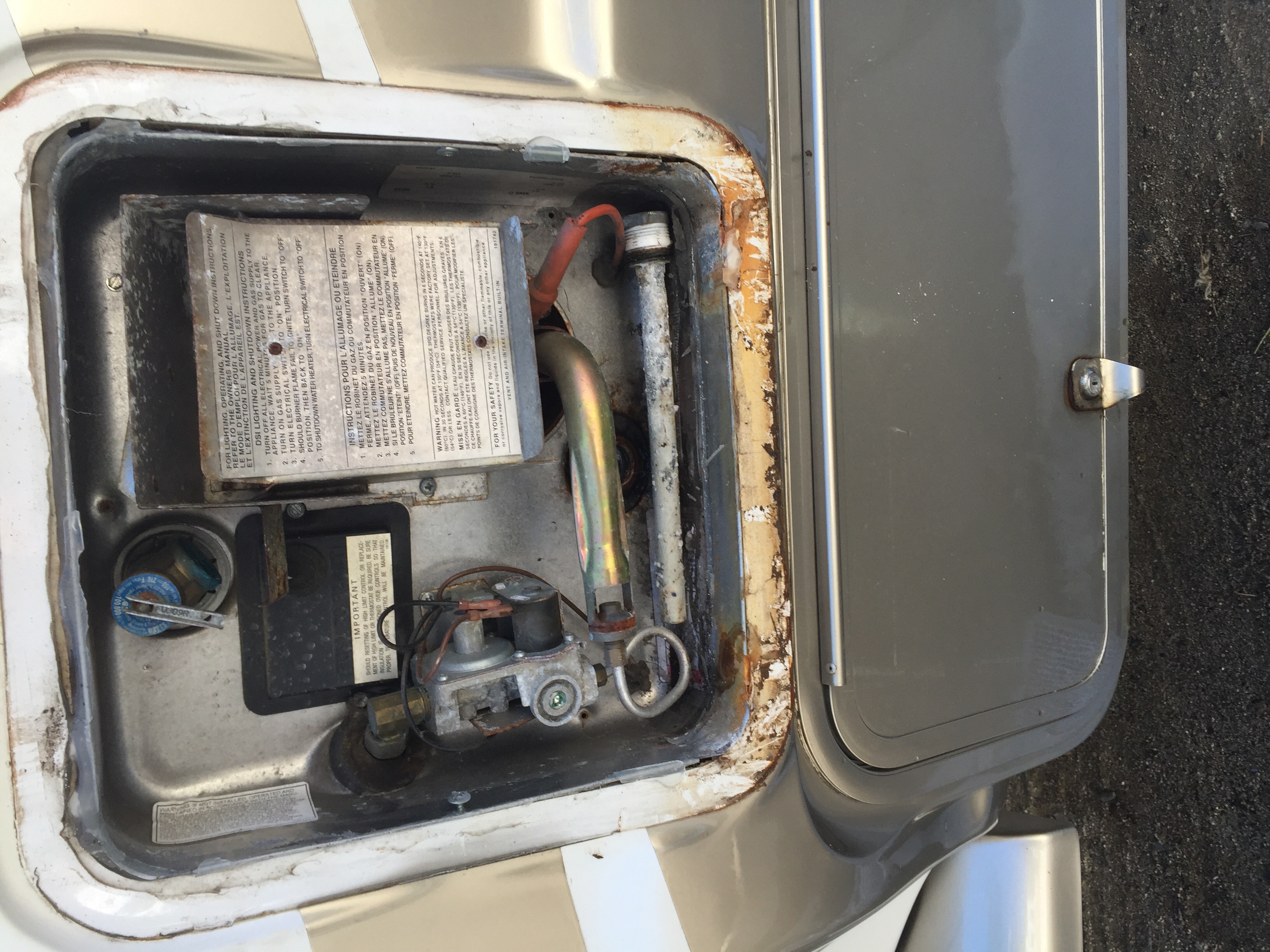

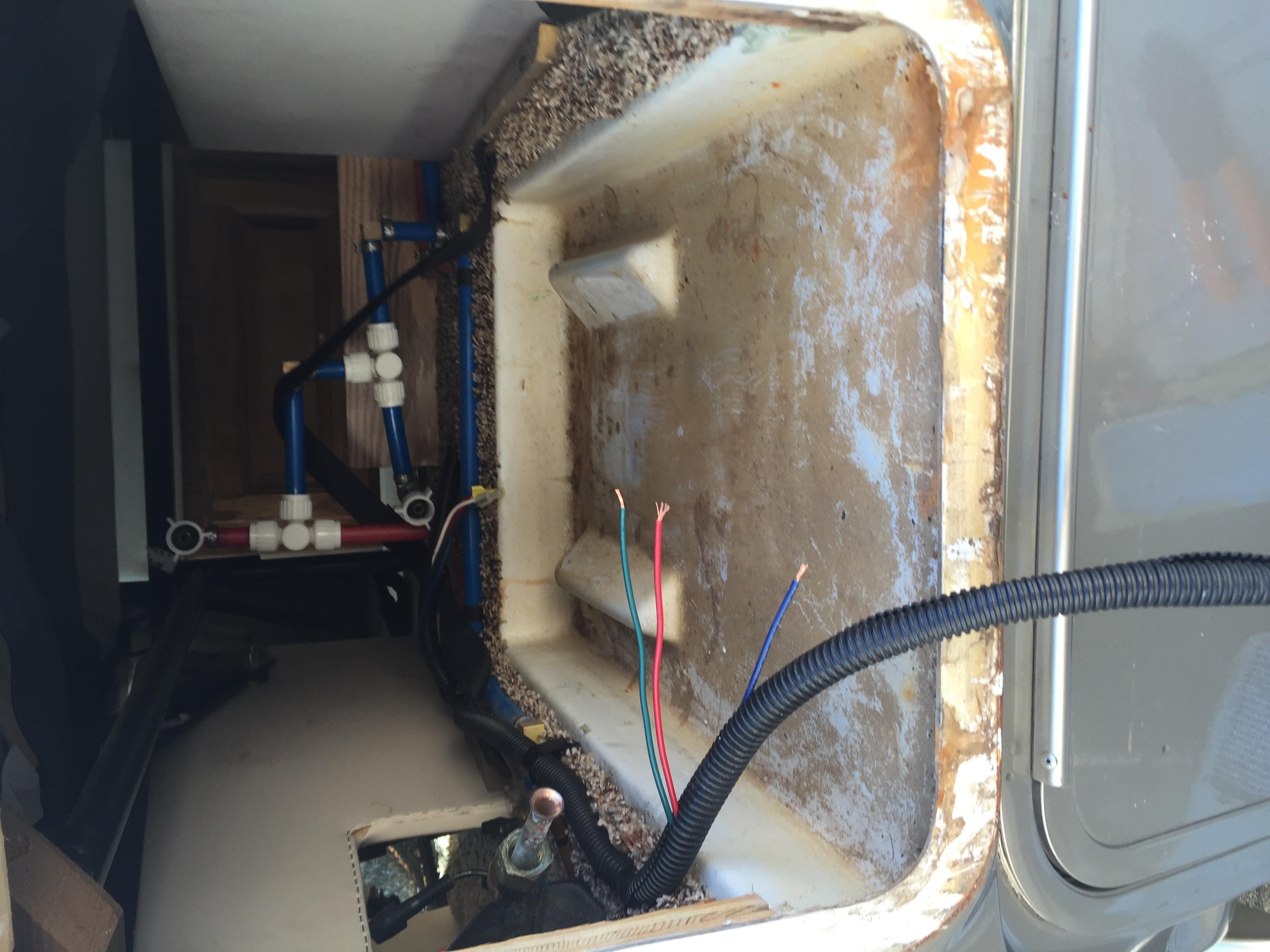

Thanks to my improper winterization, I got to replace the suburban hot water heater with a new one. After looking at the old one closer and closer, it wasn't such a bad thing to replace it.
Getting the outside flange to let go of its glue/silicone and come off was the worst of it.
