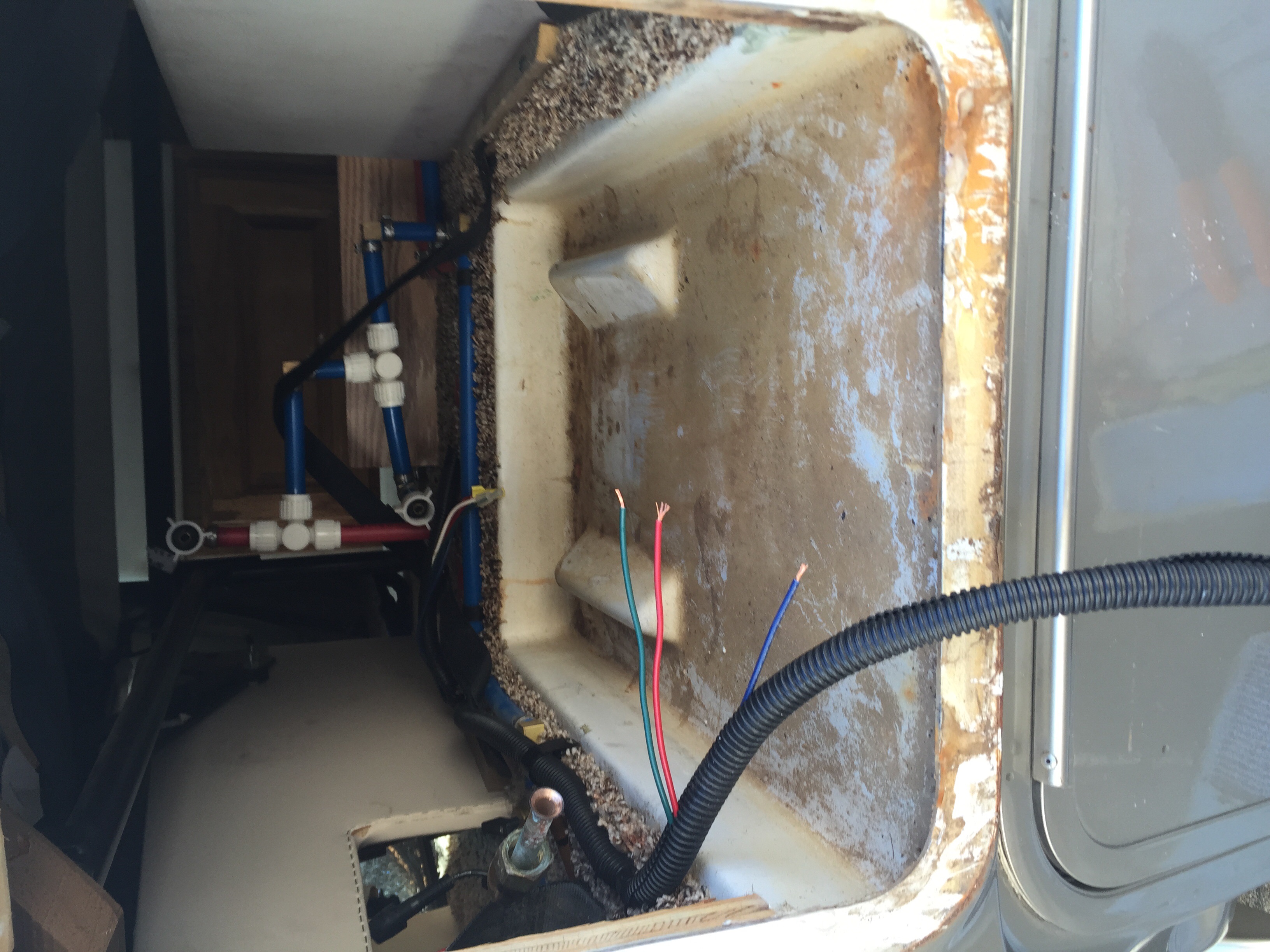

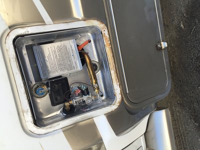

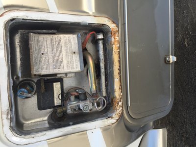

Thanks to my improper winterization, I got to replace the suburban hot water heater with a new one. After looking at the old one closer and closer, it wasn't such a bad thing to replace it.
Getting the outside flange to let go of its glue/silicone and come off was the worst of it.

Welcome Ryan. I can't say I would have replaced it before it broke, but since it did break (froze.. Somehow screwed up and didn't get antifreeze into it.. Or at least not enough) I replaced it with new. The old one had seen better days anyway, but I'll drain the tank before I start putting in the pink stuff next time just to be safer now.

I think I either got it from Amazon or maybe Adventure RV. Note that the door/flange are a separate item.
In my rig the water heater is a Suburban SW6D. This is 6-gallon, direct spark ignition (so you can start from inside rig), propane powered. The Suburban SW6DE can also be run on electric power (if plugged in) (with appropriate wiring).
