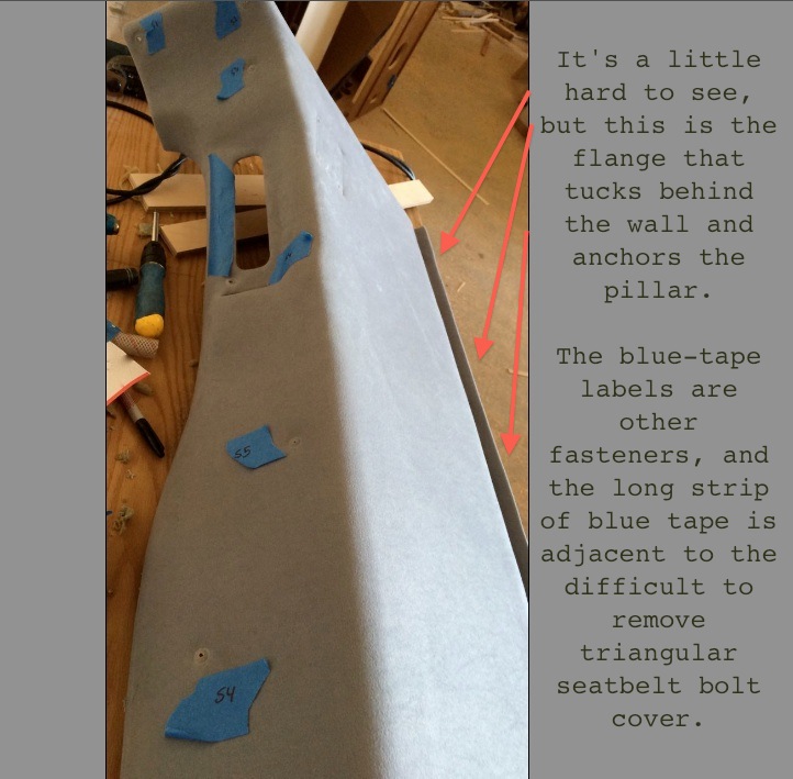

I think I wrote about this somewhere, but maybe not. At any rate, I have removed both of the pillars (along with the top center cover). I found some guidance from another Chinooker (Stephen) before attempting it.
Basically there are two "tricks."
One is that the pillar (which is fiberglass as you surmised) has a flat flange of about 1" wide running the length of the pillar on the outboard side. This flange tucks behind the wall (in this case, the couch wall; on the other side, the dining wall). You have to pry and coax the pillar out from behind that wall. The flange is not anchored at all, but just purposely trapped.
There was one additional complication on my rig on the driver's side, and that is that there was a coax cable about halfway down that was hampering things. I had to get in there with the pillar half off and deal with that, but yours may not have that. This did not exist on the passenger side.
There is open celled foam glued to the fiberglass outer wall that the pillar presses against, so compressing that may help.
Here is a photo that shows the flange on my passenger side pillar. It's the same on the driver's side.
Now, as long as you don't want to actually remove the pillar from the rig, you are done. The pillar will be removed but just won't be able to leave the rig due to the seatbelt. But in most cases there is likely no need.
Trick two came about because I wanted to completely remove the pillars from the rig. This involves detaching the seatbelt. It "would be" a simple operation but for the fact that Chinook's pillars are "puffier" than the standard Ford pillars. Hence it is difficult to get the triangular plastic piece off that covers the top of the seatbelt. You either have to devise a tool to get up in there and pinch the release (to get to the bolt behind it), or slide a wrench in behind it and turn 1/9000'th of a turn at a time until it is out. I removed the plastic covers with a homemade tool. T
After that it is simply a matter of unbolting the bottom of the seat belt where it attaches to the Ford and then re-bolting it in place after unthreading it from the pillar cover (presuming you want to drive while the pillar is off). But again, if you just want to move the pillar out of the way, you can keep the seatbelt threaded through it and no need to go through the removal of the seat belt part.

Well let's see, did you remove the forward couch trim panel? The one that has a "triangular" thing at the bottom that covers the LVD. Maybe that could be it.
Mine had a variety of snap studs and screws that held it to the side of the Ford cab (as you can see in photo) but nothing holding it to the Chinook side (because anything you screwed in there would come out on the outside of the Chinook body just behind the Ford door!). I did have that coax cable that was somewhat anchoring it though. Luckily I had removed the passenger side one first, so could tell there was something "extra" on the driver's side pillar. I had to reach in and deal with it. In my case, I had already removed all TV things (with no plans to reinstall) so I think I might have cut the coax cable then. Not saying that was necessary, but it was hung up.
It is an "OMG I am surely going to break SOMETHING" feeling getting the flange out from behind the wall.

Well i got the thing off of there finally. There was a run of wires jambed between the wall and that lip preventing it from pulling out from behind. Including an 8 awg battery cable.
