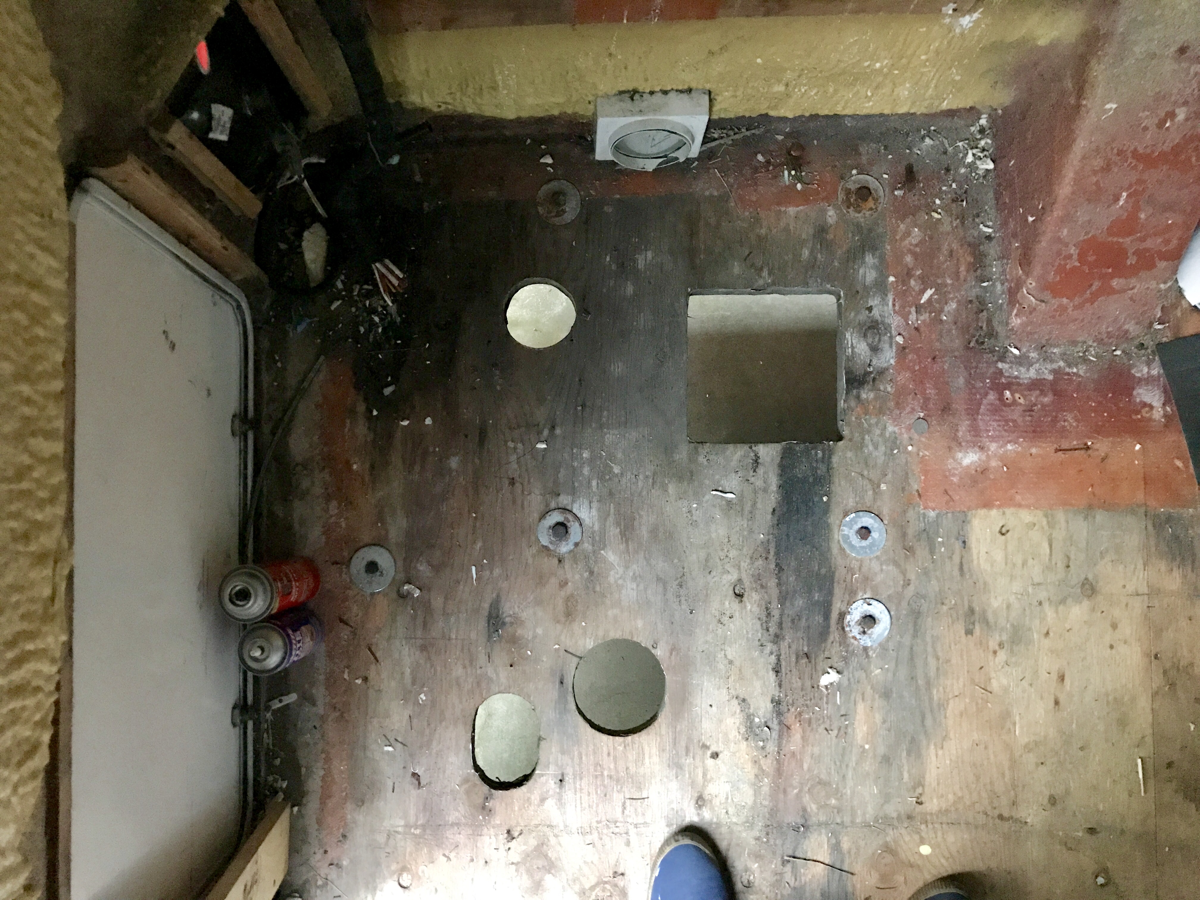

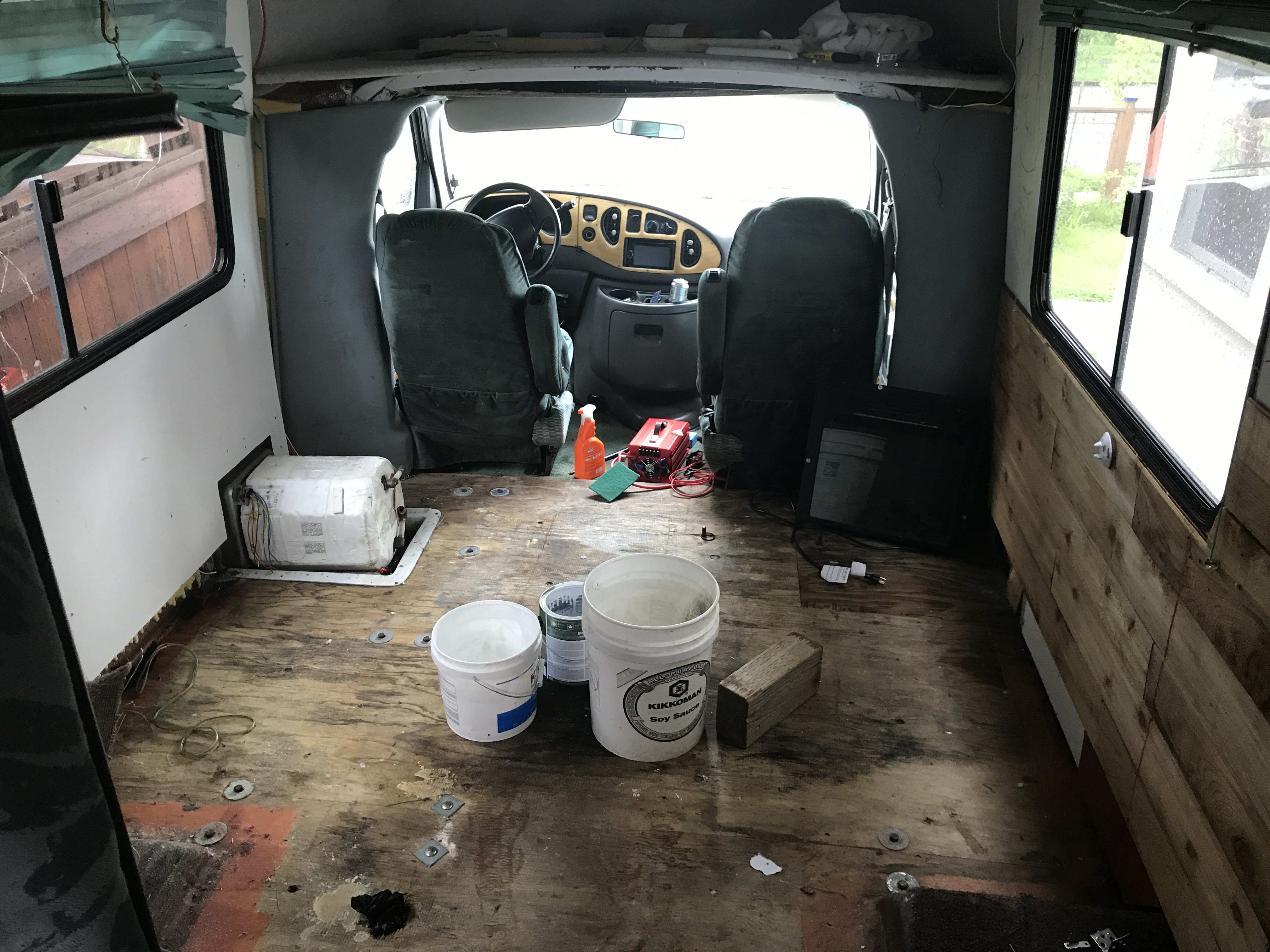

Here's a quick update, since it's been pouring rain here in Portland. Inches!
I had to place a couple buckets inside to deal with leaks from the AC area. I definitely need to seal that off ASAP. I think for now I'll go the butyl tape and poly carbonate square/skylight route.
The main water "damage" is in the center, where it has been dripping from the AC for likely some time. The plywood seems to be in good shape still, not too soft or anything. Mainly just some black staining. I ran some screws into it in a few random spots, and felt resistance so it's not rotten/mushy by any means.
Once the sun starts shining, I can really let this thing air out and then start sealing up any potential leaks.
I did notice that there appears to be a different piece of plywood in the area where the furnace would've been. Did the factory cut out the floor to fit the furnace? I see that on the other side where the floor is cut out to accommodate that water heater. Just wondering if it came from the factory with that plywood patch there, or if that was an older repair.

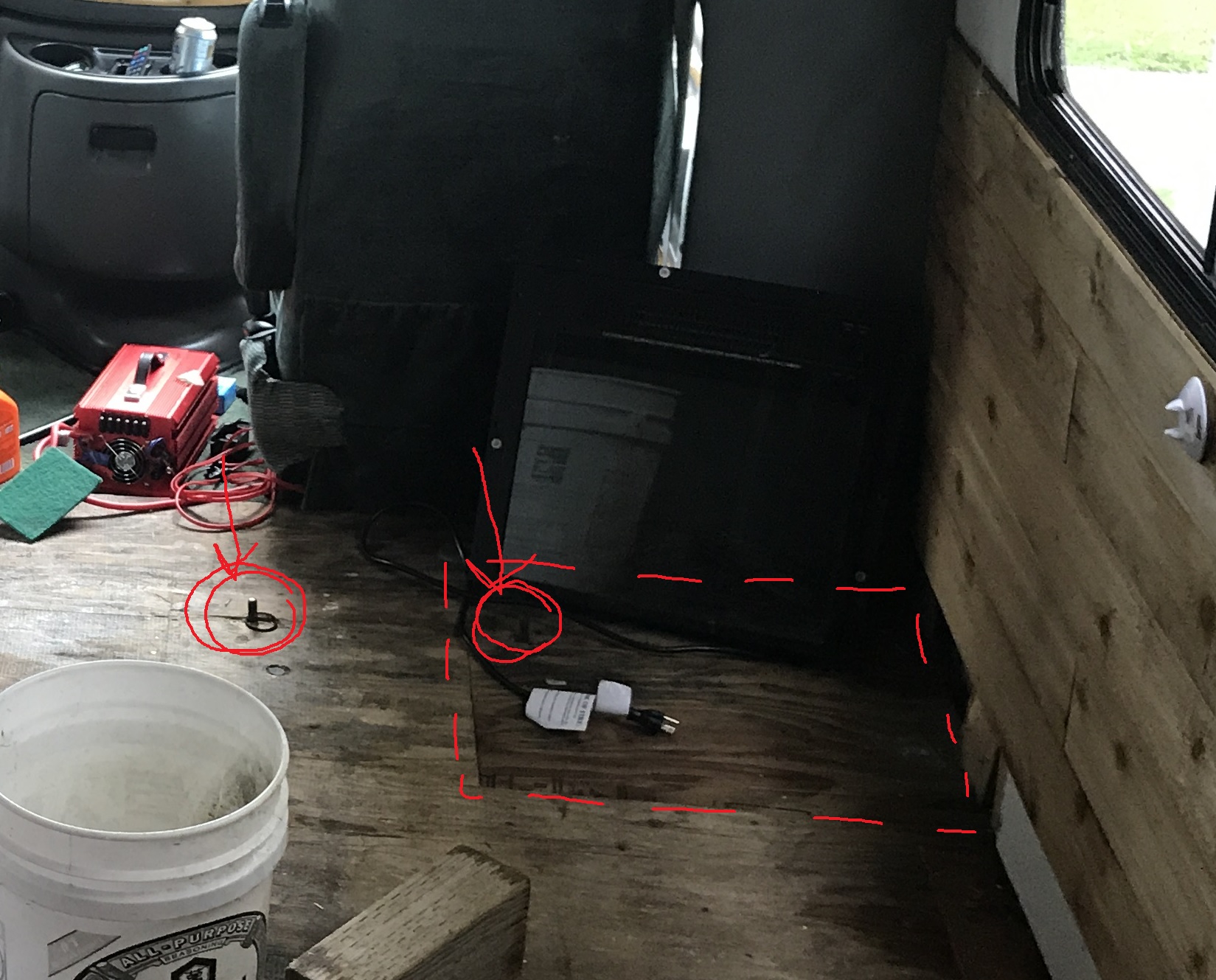

Yes on the furnace area (at least on the Club lounge layout). The floor in our era (at least in mine) is made of two sheets of plywood, one atop the other. Either 3/4" or 1" each (can't remember which at the moment; let's assume 3/4" for now).
In the Club lounge layout the furnace was underneath the forward chair's box base. Well, those chairs were already pretty high up (base plus chair bottom). Too high for me. Anyway so to fit the stock Concourse furnace under the forward base, the floor was cut out so there is only something like 3/8" - 1/2" left. One whole layer is out, and the other layer was "delaminated" to make it thinner. Even so it was a real bear to get the furnace out from under the box bench! (There is a thread in which I removed my furnace that has photos.)
Not sure if it was the same way in the dinette layout. The dinette seat cushion may have been thinner and allowed room (?).
On the leak under the Air-con: If you do find the upper layer to be more rotted than you thought, you could cut out the top plywood layer, then fiberglass a new piece in. The bottom layer will make it easy. You could do a similar thing in the way of the furnace if you want a flat/full strength floor there.
I also made a thread for the Air-con "skylight" in case you want to see how I went about it. Others then added their mods to the same thread.

I don't know if my Premier was club or dinette. The dashed red line in this pic is the "patch" that is flush with the rest of the floor. I circled a couple bolts that are sticking up, there are some more, and some holes where some are missing. Maybe those are for the rotating club chairs?
That T&G is nailed to the stock wall paneling but it's all coming out & some insulation added behind. I need to hit reset on this thing...
