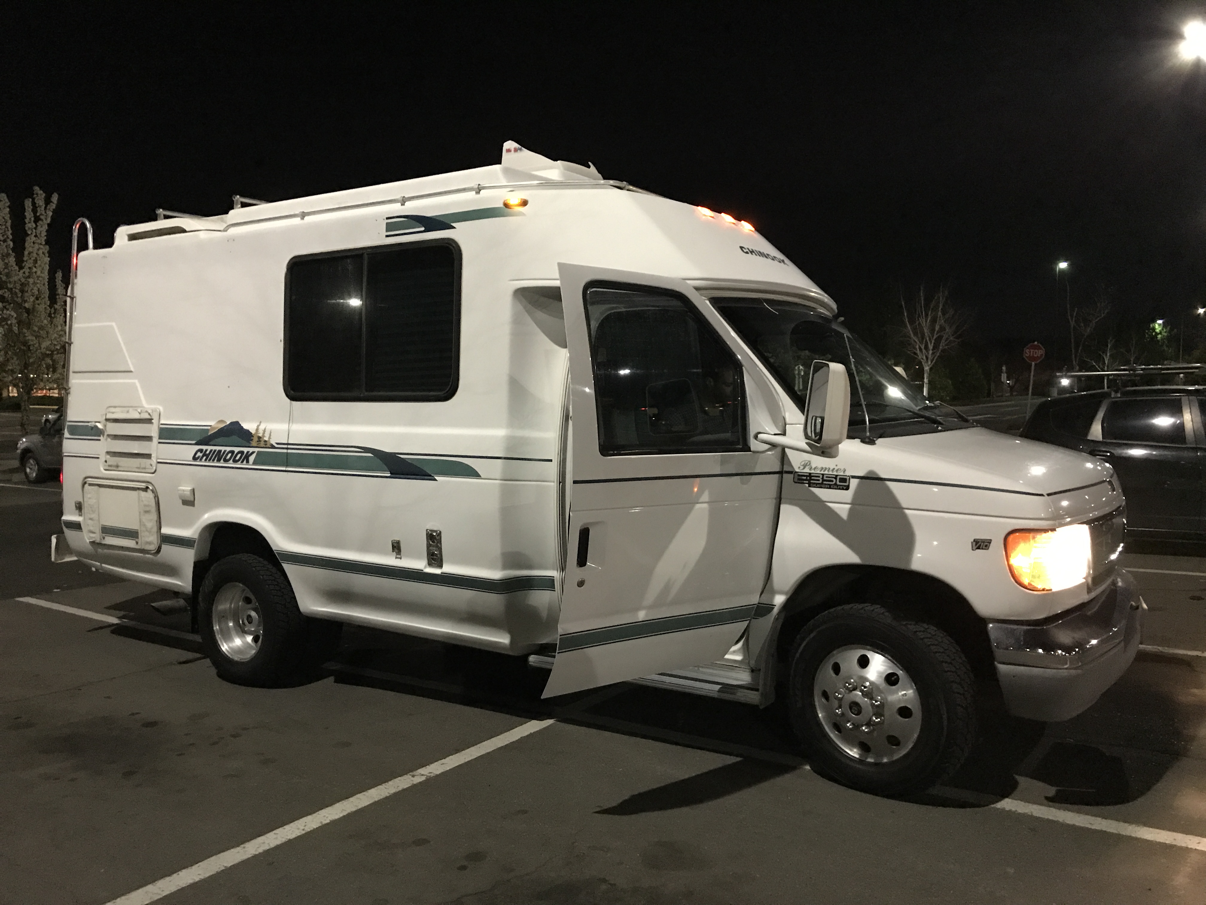

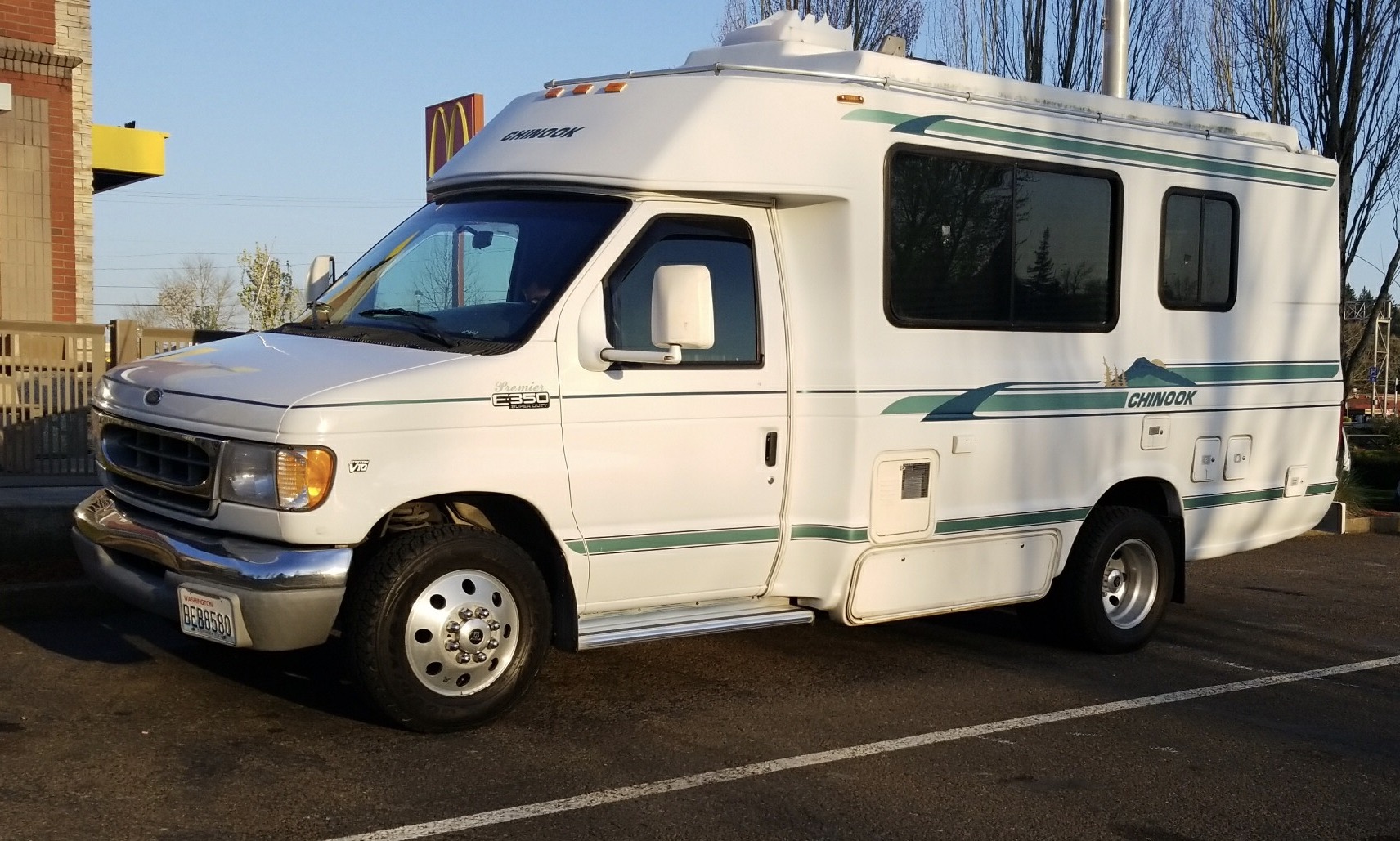

So... I just bought a 2000 Chinook. Seems to drive well, and I just got it home to the driveway. Next stop is to have it tuned up at the shop.
Then the fun will begin! You see, this Chinook has NO interior. Nothing. Actually, the hot water heater is still there, but I think that's it. Most all tanks/plumbing/wiring/etc. has been removed. I don't know the backstory, and will probably find out more as I start fully gutting this. The previous owner bought it gutted, and added a basic level of carpet/comfort. I'm assuming this suffered water damage in the past, and someone gutted it to "fix" it, but never finished up. So my project is going to be to convert this into a halfway-decent camper. I'm thinking fairly simple stove/sink/heat setup. Solar panel on the roof and maybe a 12v fridge cooler.

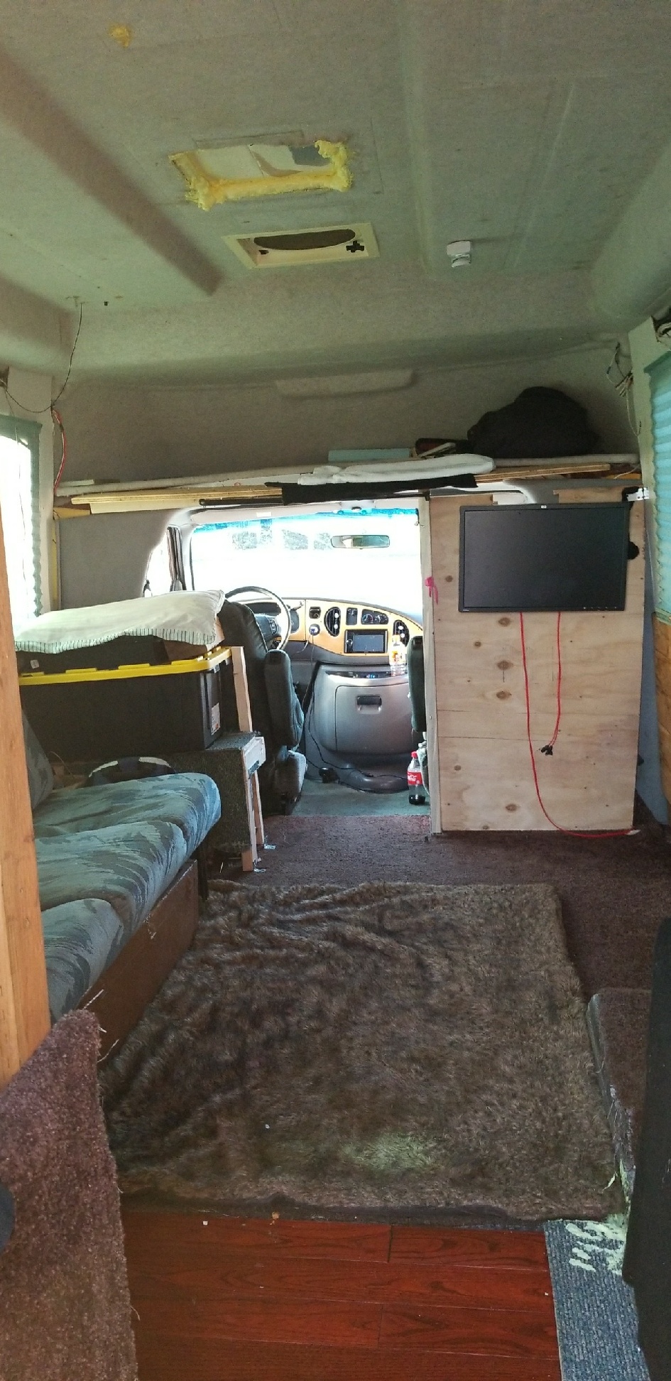

Wow, thanks for the welcome and all the info. The rig's at the shop today, getting a used vehicle inspection. I'm hoping it comes back in good enough health. I'm imagining some $ in repairs, but hopefully there's nothing too major. I don't want to invest the time & money into this build and then find out it's got a major issue.
I'll take some more pics to show what I'm working with, but there's basically NOTHING left inside! No bathroom/shower/generator bulkhead/etc. I think all the tanks are removed from the bottom. They even took the awning off...?! There's probably a barn full of chinook stuff somewhere that got tossed when someone couldn't figure out what "random ol' RV" it went to...
