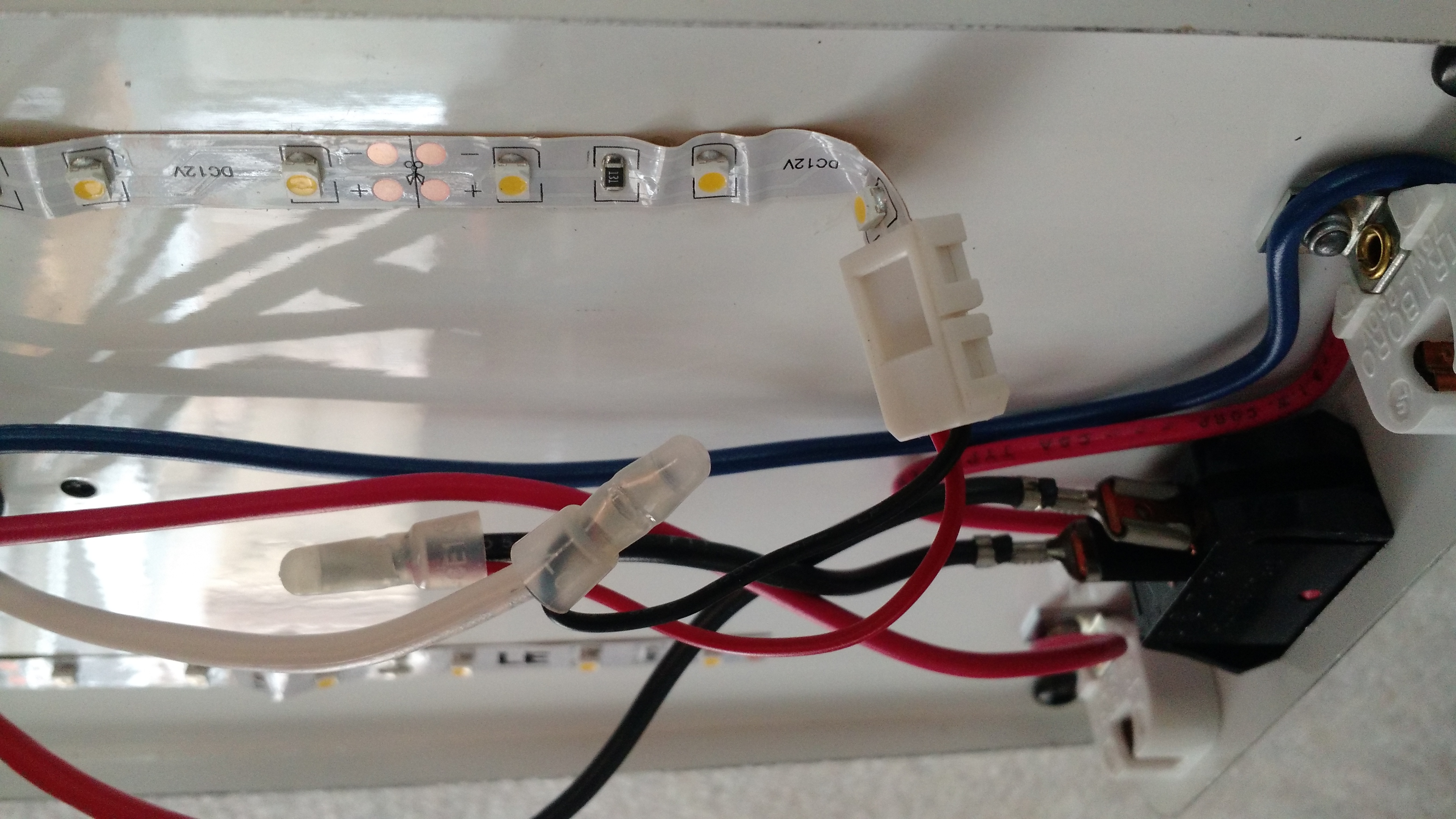

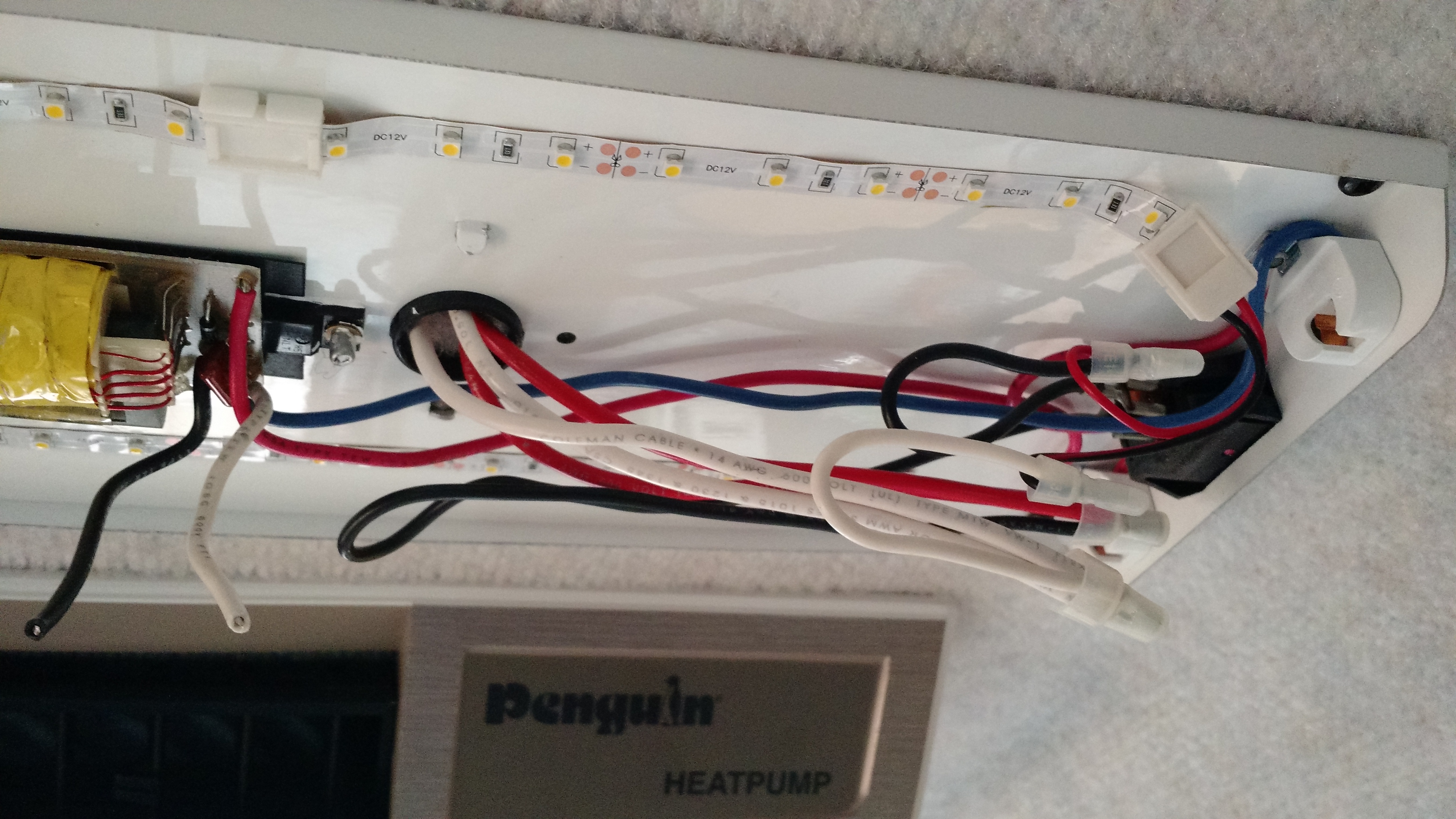

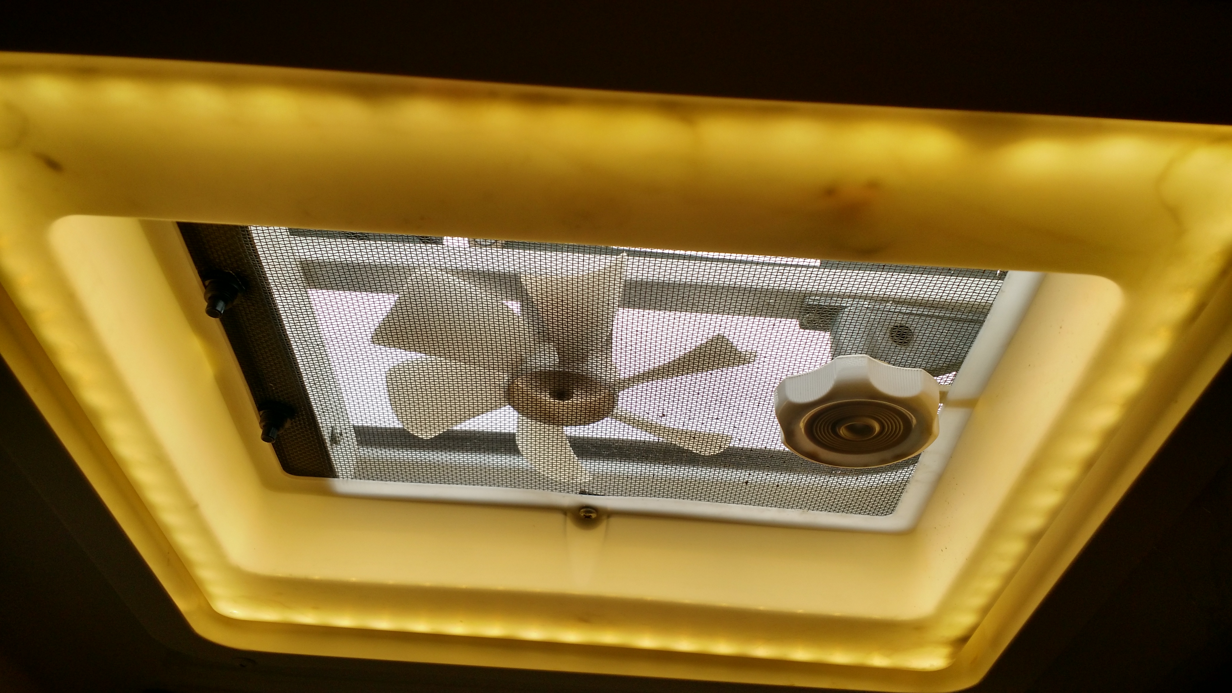

I'm going to attempt this mod for my Thin-Lite ceiling lights and ordered the LED strip lights and connectors from Amazon per your post. After some consideration, I decided to try this "cheap route" to see if it will work for me. If not, will spend $$$ for the LED tubes. Could you provide more detail and possibly better pics or diagram of the "wire modifications and connections"? Thanks!
The LED strip replacement is actually pretty simple. The LEDs come in a 16 foot reel, and can be cut to length with scissors at special marked cut points (every third LED spacing). The jumper cables clamp onto the strip at the cut point, and connect a red 12V+ wire and black (ground) wire to a LED strip. As purchased, the jumper cables are designed to connect two strips together, so there are connectors on both ends. You cut a jumper cable in half to get a pigtail connection to a LED strip. Then you connect the red pigtail wire to 12V, and the black pigtail to ground, and the LEDs light up!
The LED strips have an adhesive side, so they can be stuck to the light fixture where the fluorescent tubes used to be, so you can cut a strip for each bulb position approximately the same length as the bulb, and use a jumper cable to connect the two strips at one end of the fixture.
The light fixture has is powered by a pair of wires:
1) 12V+, which is either red or black coming from the ceiling (my center fixtures had red wires, and the side fixture I looked at had black).
2) Ground, which is generally a white wire in the Chinook wiring.
The 12V+ wire runs to the switch in the fixture. A black wire from the switch (switched 12V) is connected to the black +12V supply wire from the ballast.
The white ground wire is connected directly to the white ground wire from the ballast.
All you have to do is cut the black and white wires from the ballast, and connect them to the LED strip pigtail. The only confusion is that the pigtail black wire is ground, and the Chinook white wire is ground, so you connect the white Chinook wire to the pigtail black, and the black Chinook wire (switched 12V+) to the pigtail red. It might be possible that red and black are switched in the pigtail (some mirror image effect from cutting the jumper cable in two), but if so just swap them to find out which way lights up the LEDs. It does not harm them to wire it backwards, but they don't light up if they are backwards.
Even though the ballast and fluorescent wiring is not used, I just left it in place, since it is all disconnected from the 12V system. Then it is an easy matter to switch back to fluorescent operation if desired, by reconnecting the white and black ballast wires.
I used the "warm" yellow LEDs, which are not as bright as the fluorescents, and I only replaced the two main fixtures in the ceiling center, because these were the only lights I would leave on for any appreciable length of time. I left the rest as fluorescent, since we rarely use them, and when we do, it is for reading or working, and the brighter light is preferable in those situations. The power savings for lights we rarely turn on is not significant.
I also used some of my leftover LED strip to replace the bathroom incandescent bulbs (in the original bathroom fixture). The incandescent bulbs are problematic, because not only do they consume excess power, they are so hot that the light fixture cover gets burned and discolored. For the bathroom, I taped the LEDs all around the square translucent light cover, and they produce the correct amount of light with hardly any power consumption. For this wiring, I cut the 12V wires leading to one of the old bulb sockets, and crimped on spade lug receptacles. Then I crimped spade lugs to the LED strip pigtail, so the wires can be disconnected when the light cover is removed, since the LEDs are attached to the cover, not the fixture itself.
Finally, for completeness, I replaced the incandescent bulbs in the refrigerator and closet with automotive LED bulb replacements, which was simply a bulb change. This is good for the fridge as the LEDs don't produce heat.
Attached are a couple of close-ups of the LED connections in the main light fixture, and a picture of the bathroom LEDs in operation.

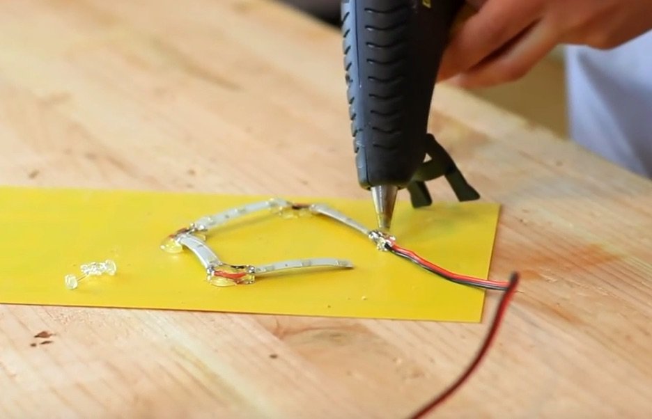

For bonus points you can remove the fixture and use a hot glue gun to "stitch" across the LED strip lighting to help hold it in place. Some of the adhesives aren't that great, and the added heat of an enclosure can cause them to droop. This also helps if you're trying to stick LED strips to a material that isn't very smooth, like plywood or fabric.
Re: LED Tube Question
That's an interesting idea. When I was looking at how to re-do the incandescent rope lights in the Concourse upper cabinets, I was considering strips, but never really saw a good way to fasten them (it's in a corner, without room to just do a normal flat mount with straps). I pretty much knew that the included adhesive wouldn't stick to wood for long.
Have you done the hot glue method? Any special kind of glue? To wood?

You can buy easy to cut aluminum channel w/ snap-in diffuser. The channel can be screwed in, led strip stuck to, then diffuser snapped in.
I've done a bit of work with LED strip lighting and soldering together sections in funky ways. Usually this is on painted wood of some sort, with an eventual translucent milk plex over it. Hot glue is a good backup. You can also just put it on the adhesive side of the strip lighting.
Just the normal craft store stuff works fine. It's like duct tape with 101+ uses. You can even waterproof wiring connections with it!
