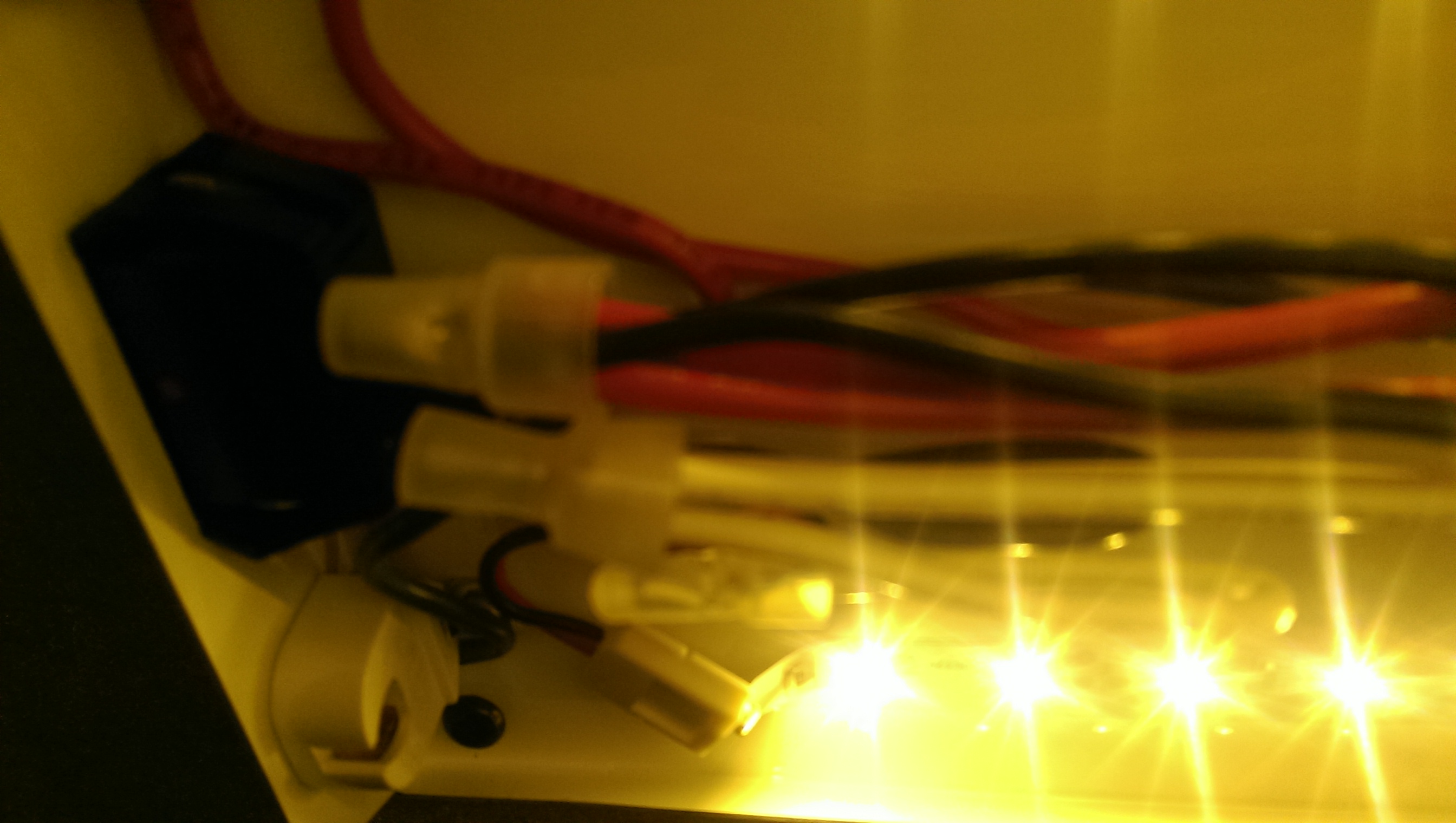

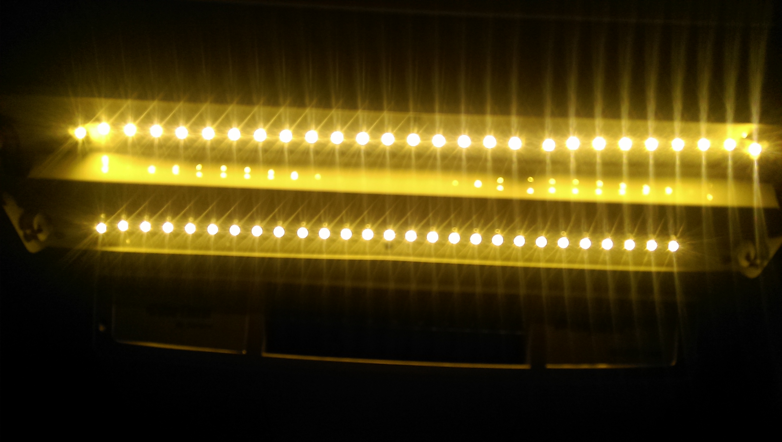

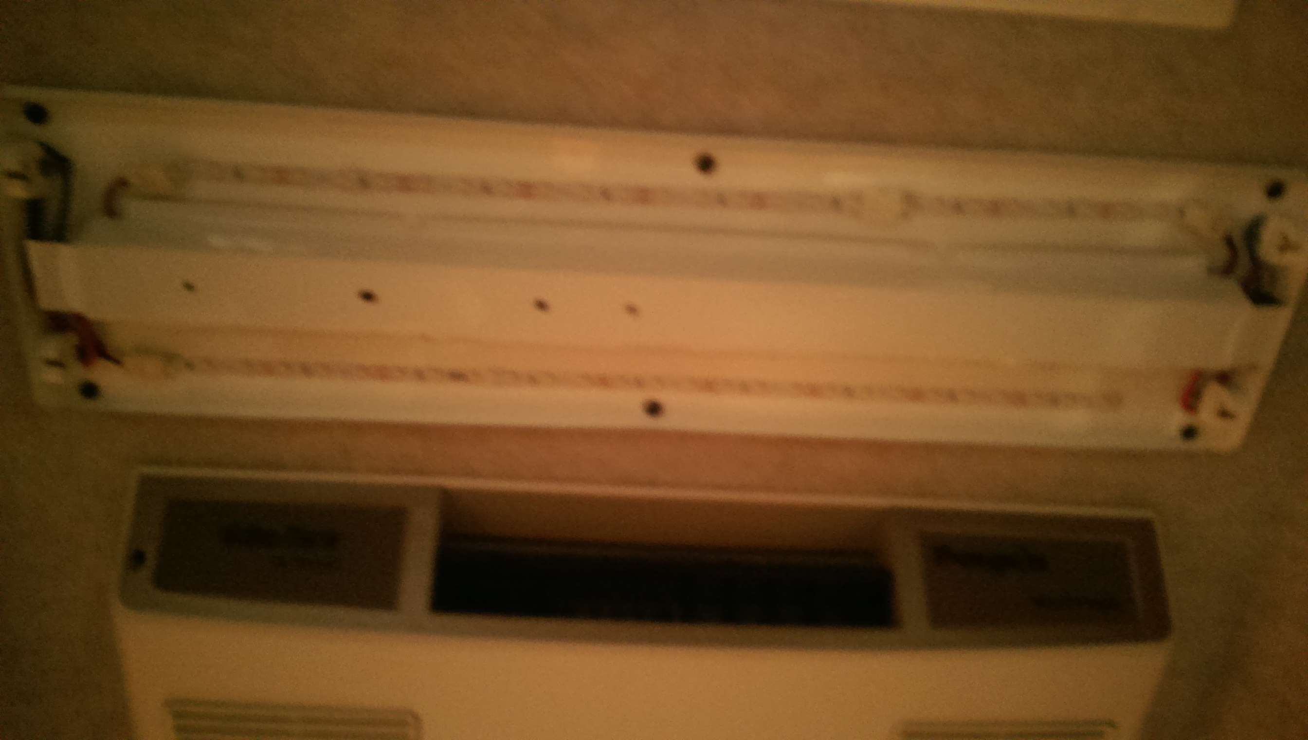

I replaced my main fluorescents with LED strips, and it was really cheap and easy. Here is what I bought:Skillet wrote:Blue: You still happy with your lights? I'm starting to look at the bulb replacement now and wanted to see if you would do anything different. Or if anyone else has replaced their fluorescents with LED's and would like to add to the discussion before I spend a some money.
16 foot reel of LEDs:
http://www.amazon.com/gp/product/B00HSF ... ge_o05_s00
Jumper cables:
http://www.amazon.com/gp/product/B00QJB ... ailpages00
I used my crimper to connect the jumper cables to the 12V light cables in the fixture. You just cut the strips, add jumper, and stick the strip to the fixture (self-adhesive). Then cut the ballast wires and connect the jumper wires directly to the 12V. There are several you-tube videos showing how to di it. Total cost about $20. I did the two ceiling fixtures I use the most, but I have enough parts to do them all later if I want to.
One more picture of the completed assembly coming.

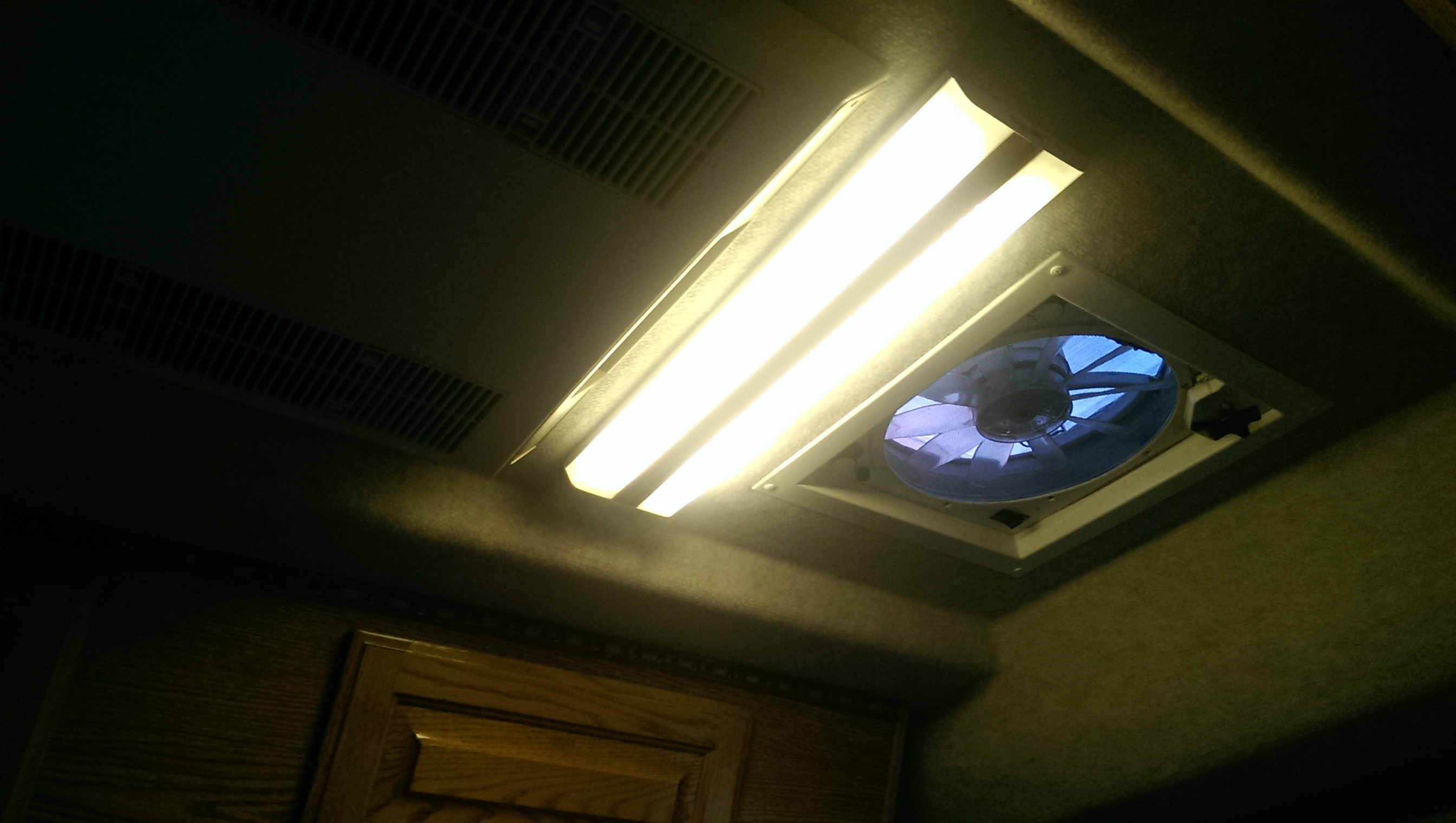

Re: LED Tube Question
One more picture of the completed assembly.

I'm going to attempt this mod for my Thin-Lite ceiling lights and ordered the LED strip lights and connectors from Amazon per your post. After some consideration, I decided to try this "cheap route" to see if it will work for me. If not, will spend $$$ for the LED tubes. Could you provide more detail and possibly better pics or diagram of the "wire modifications and connections"? Thanks!
