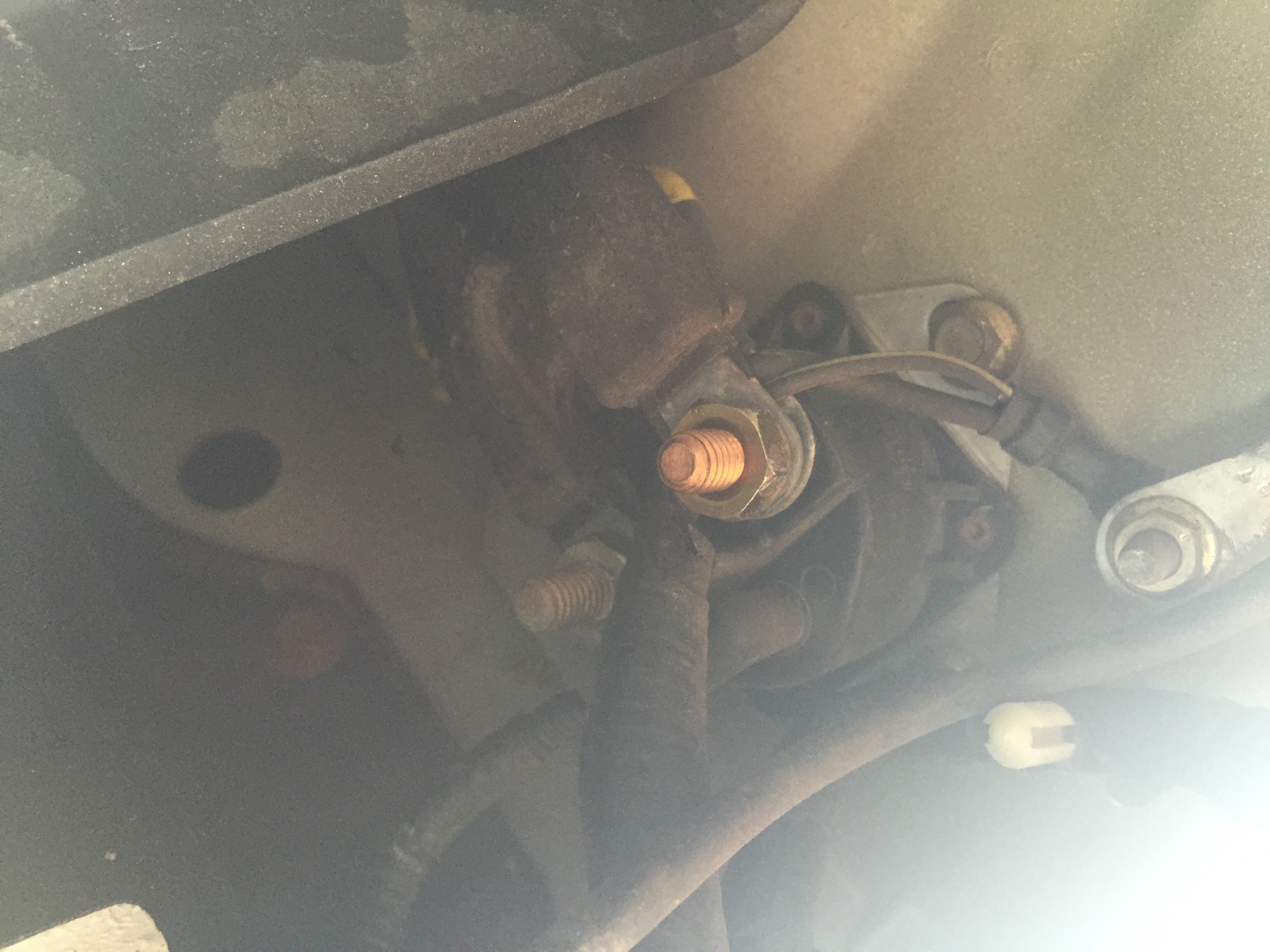

I tend to lie around underneath the rig from time to time (in this case I think I was planning out my new/larger wire run from start to house batteries). While down there, I look around to see if anything looks amiss. In winter of 2014/2015 I was looking around and saw this delightful little number...
This is factory Ford wiring, and you can see the huge split in the negative cable with a nice bunch of green wiring inside it. I figured out that these were essentially the Ford start battery cables (the corresponding positive looked fine). My first thought was to just get new battery cables, but then when looking into it I found out that it's no longer "just" cables, but is instead a complete "harness" and would be rather involved to remove/replace. Also the rest of it looked fine.
Anyway, the reason I'm mentioning it here is that I think the "thing" with the two gold canisters (one small, one large) that these two wires go to is the starter. If you follow down roughly where the passenger side exhaust runs, you'll see it sort of just aft of the front wheels. To the passenger side of center (as I remember it - it's raining now so I'm not going out to check).
I didn't have any starting problems ever, and I can't tell how much this affected things because as a part of the whole project (new wire from start to house battery, removing recalled Surepower 1315, etc.), I also replaced the start battery. After this ugly negative wire was fixed, and the new start battery was in, it DID turn over and start really really fast, but I can't be sure what caused the difference. And before that I wouldn't say I ever thought there was a problem -- just that after it started like "crazy fast."
But maybe something to look at? A problem like this with your wire could cause a starting issue even if the battery was good.
For some reason I don't have any photos of the "after," but what I did was splice on a new section of marine grade wire, and then put on a new lug. I also improved that nasty bend that caused the split (or contributed to it). As I remember it I pre-bent the lug slightly to effect that. Then I put heat shrink over the connections. I have a big crimper and used FTZ lugs and dual wall heat shrink, so I felt it was better than new, even spliced. If I remember correctly it was 4AWG wire, but I don't remember the stud size for the ring terminal (easy to check thought if removing the old one).
Getting under there with the giant crimper handle "wings," plus holding all the parts and pieces in place while making the crimps was fun (not!). Good times :mrgreen:

Here you can see the wire loomed pair of "battery harness" cables coming back. The positive connection looked fine.
Another view of the compromised negative cable.
Somewhat of an overview showing the negative cable and some of the undercarriage.

Blue~Go's pics are helpful to identify the starter and solenoid. The large gold "cannister" is the starter motor itself and the smaller one is the solenoid that gets energized when you turn the key to complete the heavy-duty circuit that carries the large starting current.

So that is the starter/solenoid. Glad I wasn't totally off base. Thanks for confirming.
My first suspicion is, like yours, always that "oomph" isn't getting through somehow. Poor connections, etc. Plus those are usually the easiest/cheapest/least parts intensive to check and correct. Then move on to other items on the list.
Even though I never had any no-start issues, I can't think that that hunk of corroded wire on the negative cable was doing me any favors. Since I wasn't solving a particular problem, I didn't do one variable at a time and it just so happened that correcting that wire was done at the same time as putting in a new (and much better) start battery. She did come to life in a very very sprightly way after that though -- like instead of a turnover or two, it was "ZING!" and started :D

Just in case it wasn't clear (and I can certainly see how it might not have been, by my photos), the starter is actually under the rig, not under the hood (which, being that we have vans, probably makes it roomier!). It's actually a ways back from where you'd think it would be. In other words, to see it, shimmy under the passenger side of the Chinook on your back under where the original furnace was (to avoid the running board) and then look up and a bit forward.
