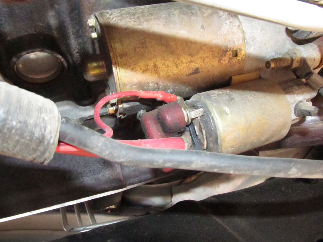

I tend to lie around underneath the rig from time to time (in this case I think I was planning out my new/larger wire run from start to house batteries). While down there, I look around to see if anything looks amiss. In winter of 2014/2015 I was looking around and saw this delightful little number...
This is factory Ford wiring, and you can see the huge split in the negative cable with a nice bunch of green wiring inside it. I figured out that these were essentially the Ford start battery cables (the corresponding positive looked fine). My first thought was to just get new battery cables, but then when looking into it I found out that it's no longer "just" cables, but is instead a complete "harness" and would be rather involved to remove/replace. Also the rest of it looked fine.
Anyway, the reason I'm mentioning it here is that I think the "thing" with the two gold canisters (one small, one large) that these two wires go to is the starter. If you follow down roughly where the passenger side exhaust runs, you'll see it sort of just aft of the front wheels. To the passenger side of center (as I remember it - it's raining now so I'm not going out to check).

Blue~Go's pics are helpful to identify the starter and solenoid. The large gold "cannister" is the starter motor itself and the smaller one is the solenoid that gets energized when you turn the key to complete the heavy-duty circuit that carries the large starting current.

3. Starter / solenoid connections (shown in Blue~Go's pictures) clean and tight

Just in case it wasn't clear (and I can certainly see how it might not have been, by my photos), the starter is actually under the rig, not under the hood (which, being that we have vans, probably makes it roomier!). It's actually a ways back from where you'd think it would be. In other words, to see it, shimmy under the passenger side of the Chinook on your back under where the original furnace was (to avoid the running board) and then look up and a bit forward.
