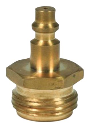

Here's a simple fitting (I think this is what BG mentioned a few posts ago). I've never used one and can't vouch, but it has 5 stars and is straightforward. One end on your city fill, other end directly to the compressor. I would probably use this, then shop vac the traps, and maybe put an extra generous slathering of plumber's grease on the toilet seal to keep it soft.

Scott wrote:Here's a simple fitting (I think this is what BG mentioned a few posts ago). I've never used one and can't vouch, but it has 5 stars and is straightforward. One end on your city fill, other end directly to the compressor. I would probably use this, then shop vac the traps, and maybe put an extra generous slathering of plumber's grease on the toilet seal to keep it soft.
https://www.amazon.com/Camco-36143-Bras ... stem+flush
Thats the fitting I have. Works great. (Had a cheap plastic one but gave it the heave.)

If you use the pictured fitting designed for RV's note the small air opening used to restrict air flow. It works as a built in regulator. My compressor usually is at 90 psi and I have never hurt a pipe. I do always have at least one faucet or drain valve/petcock open at any given time as well. I never try to "pressurize" the pipes.
