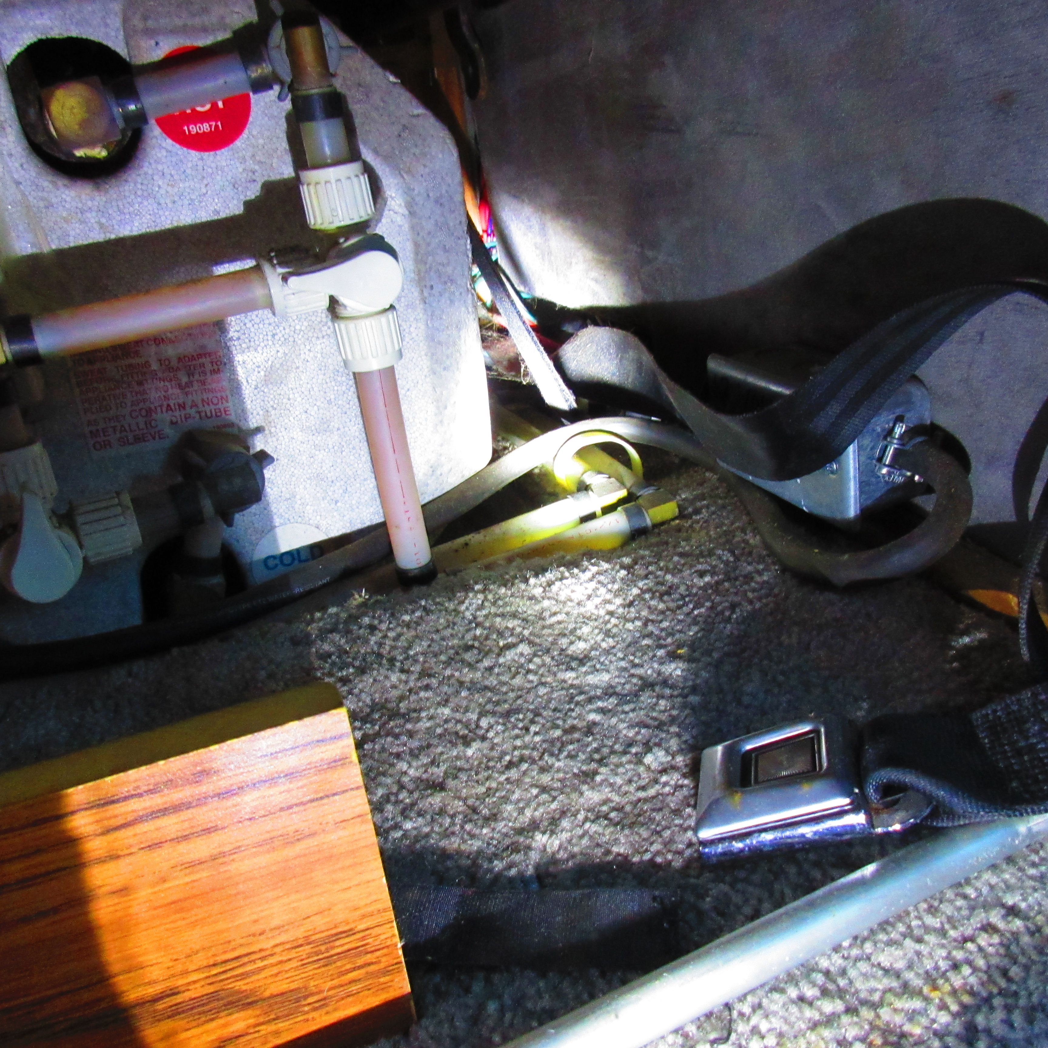

I'm trying to winterize my 1998 for the first time. One of the petcocks by the drivers seat is broken so this is what I have done so far.
I opened the other petcock by the drivers seat and the one under the couch. I then closed the valves to bypass the water heater.
Pulled the anode rod on water heater and flushed it. Put three gallons on RV antifreeze in the main tank and ran the outside shower,bathroom faucet,toilet,and kitchen sink pink.
Also poured a little antifreeze in the shower drain.

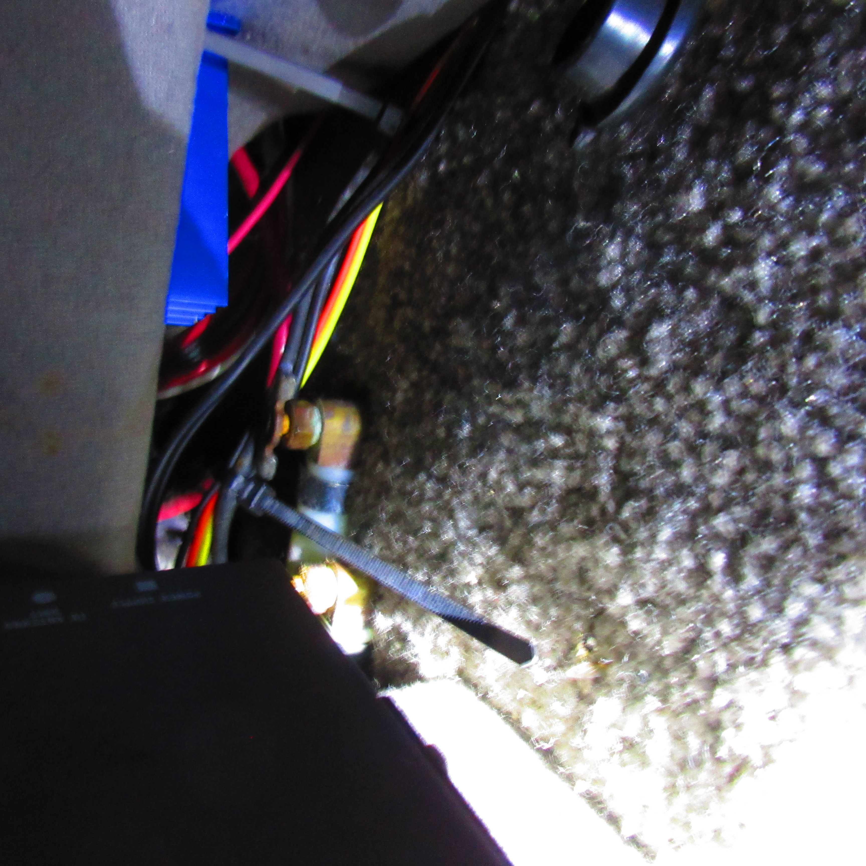

My question concerns the fact that I couldn't drain the one line because the petcock is broken if the antifreeze will make it back there, the line doesn't look pink but its hard to tell?

I bet there is still fresh water in that line. I had a white valve break open due to a line still having fresh (ish) water in it. It was a cheap repir item and didn't flood or anything. What temps are you anticipating? Could you not replace the petcock "guts" with a wrench? Looks like the assembly unscrews. I would do that before attempting a full replacement due to mounting issues.. or maybe just taking a wrench to it will help winterize it.

I was thinking about taking a wrench and slowing unscrewing the nut on the housing. Do you think the water will start coming out of the top or will that open the valve so the water can go out the bottom of the coach?

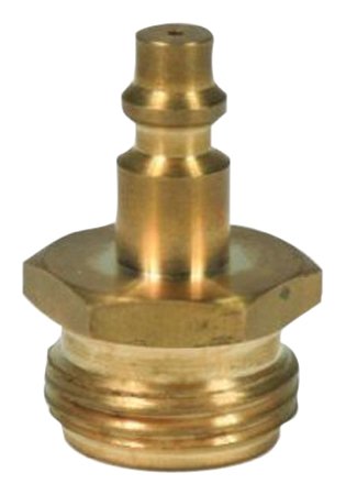

Many people winterize by pressurizing the system with air first (you can get little nipples that fit on the water fill for this purpose, I believe). Then just putting antifreeze in the low points (traps, etc.).
I've done this method in my Chinook and multiple other RV's for many years and never broken a pipe. In my first trailer I used to use antifreeze in the FW tank but the process was a pain and the taste.....

There are adapters that plumber used to pressure test plumbing with an air hose nipple.
http://www.supplyhouse.com/Mr-PEX-37001 ... gIQ3vD_BwE
I guess you can put a garden hose fitting on it, or get one that come with the right female thread (if one exists).
