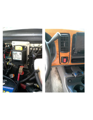

Hi all. Nice to meet you. I have lurked here for quite some time while waiting for the right Chinook to come along. I must say, I'm amazed at the wealth of information on this site. Some of the members like Blue~Go are so dedicated to helping, one must wonder when they find the time to work on their own projects.
New to me, a Chinook Destiny. Not my first motor home but definitely, my first Chinook. All went well on our return ride home except no charge getting to the house batteries which seems to have made huge paperweights out of them. They will only hold slightly over 10 volts. Appears a PO removed the smart charger solenoid. Taking Blue's advice I have installed a Blue Sea 7622 with slight modifications to the wiring because of space limitations as to where I can install my MBRF fuse next to the chassis battery. I am still waiting for the fuses to arrive so, everything is not completely tied down yet.
Attached is a picture of the 7622 installed along with the remote switch. I am also including a PDF file showing pictures taken along with a copy of the wiring diagram from the 2003 Destiny manual and a modified copy of Blue Seas' wiring for the ACR. The name plate on the fuse panel below the galley indicates I have a Todd Engineering LC30. which I assume means it is designed to be installed in a coach with 30 Amp service. I would hope it's more than a 30 Amp charger.
According to the Chinook wiring diagram, it looks like all I need to do is remove the old converter/charger, wire a new one to the house battery circuit and plug it into the back of the AC panel. If I'm correct, the AC is already wired to that panel and I shouldn't need to do anything with it. I haven't stuck my hand way back into the cabinet yet but, I hope to find that the charger is at least screwed down rather than just laying there.
I'm looking for some guidance from someone who can confirm what I am actually looking at and make a few suggestions on how I might proceed. I haven't decided what kind of batteries I'm going to install yet so, would like to use a charger that will work with either AGM or flooded. The next question would be, if I install AGMs, will they survive when being charged from the old solar panel setup?
I guess that's enough for the moment. I will graciously await replies from anyone versed in the subject.

Hello Trouble :D Congrats on your new Chinook! And welcome.
I'm on the road at the moment, so only have time for quick posts; but I just wanted to let you know that your post wasn't forgotten.

I took a look at your .pdf - thanks for putting that together. A few things in the schematic and photos look a bit different than the Ford/Premier/Concourse, but same basic idea. Good job on getting the 7622! I can't quite tell, is it on the firewall by your start battery? It would be nice to have it not in the engine room (heat/moisture), but I understand all can't always be perfect. Maybe not a totally kosher use of an MRBF, but considering most rigs either don't have fusing, or have fuses with a too-low AIC rating, I'd say you are in an improved situation.
I didn't easily find a manual for the Todd LC30, but based on the fact that the Chinook diagram shows a 30 amp fuse in that line, I'd guess it might be a 30 amp charger.
As far as your other questions, I'd start by asking you a question (erm... questions :D): Do you have a use-case scenario for the rig? Primary use? Secondary use? What's your traveling style? Boondocking? Full hook-ups? Do you like to "not even know you're not at home" with all the mod-cons? Or are you a "hard tent" camper? Or somewhere in between? What are you looking to get out of your power system? How much are you willing to invest (time and money) into a system that will work really well vs. say (at the other end of the spectrum) keeping things relatively inexpensive and replacing batteries more often?
My own scenario is that I boondock most of the time, and while I definitely want a certain level of power (computer, compressor refrigerator, fans), I'm not an "I don't even want to know I'm not at home in the suburbs" type of camper. I like to be able to camp in the shade. Sometimes I do road trips; other times I sit in one spot for some weeks. I'm used to watching resources from boating (power, water, etc.) Knowing I have a decent setup, how it's wired, and being able to see what it's doing is something I value -- and while I'm not rolling in clover, I don't mind spending the money for a good setup. This is just one example of a fairly focused use-case scenario.
Re: New Owner With Charger Problem
You know what? I just went back to your .pdf to take a look at something, and realized there were more pages after 1 and 2. Duh! Nice .pdf with lots of detail.
Some of the annotation ran slightly off the page for me, so I wasn't sure if you were labelling something or asking about it, but I did see the question mark on "LVD"? Yes, that blue finned thing is the LVD. In Chinook's original scheme, it serves not only as an LVD (although by the voltage at which it disconnects, your batteries are already in the ER...) but also as a sort of electrical roundhouse for a bunch of small functions (house on/off switch, buzzer to remind if generator is one but on/off switch is off, etc.). I removed mine when I re-wired, so I got familiar with it (labelling all the wires, deciding if/how I wanted various functions, etc.).
I can see that various components are in different places on your rig, but mostly they are the same ones as one the Concourse/Premier of the era (mine was very similar). The one different thing I noted was the Todd charger and the fact that it looks like (by the diagram anyway?) the charger and the load center (DC fuses) are separate. These were all in one "brown box" in the Chinook/Premier. Just a detail.

Yes, I mounted the 7622 in the engine compartment above the A/C and just behind the start battery. #2 cables were right there on an old starter solenoid that was wired to the "Boost", but not wired to the "key on" circuit, hence no charge for house batteries. I left the old solenoid there with only the control circuit from the "boost" wired to it. If I had mounted the fuse holder on the battery instead of the ACR, there wasn't enough clearance to put the nut on the fuse terminal.),
