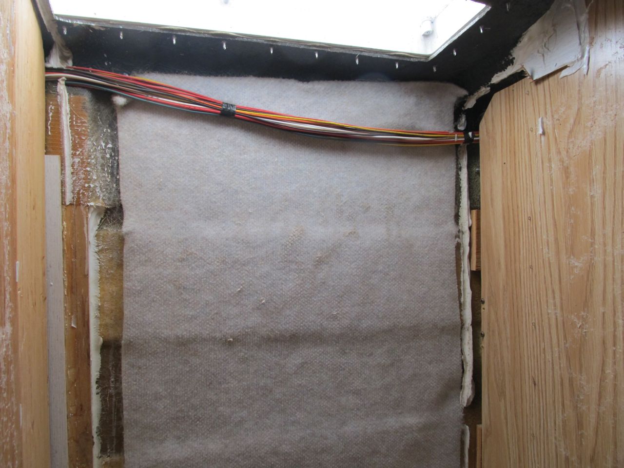

On a related topic, an area I'd want to check in all Chinooks is the wiring bundle running outboard of the refrigerator high up (continues on above the dining window). Reason I say that is that the DC wire bundle (around a dozen or more wires at that point) ran right behind the refrigerator fins, and it looked like they had rubbed or heated :shock: The cause looked to be proximity combined with lack of securing. The insulation was still intact, but who knows for how long? There was no loom there, and since there was nothing convenient to attach the bundle to (as it went across the 'fridge area) it was just kind of hanging there (note: "was" - I changed it).
Along those lines, the rest of the wiring running over to, and up the passenger side was all tidily encased in loom and secured. The equivalent run forward on the driver's side (above the couch window) was not in loom. As if maybe they ran out.... Didn't cause a problem on that side (nothing to chafe on, and it was still P-clipped), but I added loom for the tidy factor.
Here are a couple photos of the wiring bundle that ran behind the 'fridge, as seen just after fridge removed. You can see the marks from (I believe) the refrigerator fins on the wiring insulation. The wall was just fiberglass outer shell with the carpet used on the roof glued to it (marine hull liner type material). The horizontal "bars" are stiffener pieces, as is the tabbed vertical ply on the left side of the photo. Note that in these photos I have already removed the thin pieces of caulked "wallboard" that ran along each side at the outside wall to seal the refrigerator compartment off from the inhabited part of the rig.
