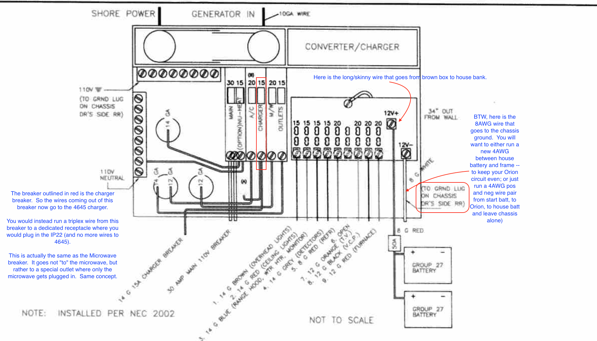

Re: Batteries and Charging
Okay, while I hunt down photos, let's start with this. I took the diagram from the 2004 Concourse manual, since I think your "Premourse" is newer, right? You may not have the floor heat they show, but whatever.
I called out three things here:
1) The charger breaker which has three outgoing wires that feed the 4645. You would instead run three wires to a dedicated outlet where you would plug in the IP22. This is the same as the Microwave breaker is now. It doesn't actually go "to" the microwave but rather to a dedidated outlet where you plug in the microwave. IIRC they used a receptacle with only one place to plug in (not two) which is a nice touch.
2) I show where the long skinny wire heads from the brown box to the batteries
3) Noted is the 8AWG white chassis ground connector. That's fine for the system as-is. With the Orion you are running 4AWG so you want the entire circuit to be 4AWG. Two choices:
a) Run only a 4AWG positive from start battery, through Orion, to house battery (fused on both ends). Then count on the frame (chassis) to be the negative "wire." But of course there are then two weak links you have to fix. The 8AWG white chassis ground is no longer large enough, so you would run a 4AWG black or yellow wire from the house battery negative to the frame (chassis). Then similarly check on/upgrade the same little link that goes from start battery negative to Frame (body).
b) Run a 4AWG red/black PAIR of wires from start positive and negative, through Orion, to house positive and negative. Chassis not involved so original 8AWG wire is fine as is.
"B" is nice and clean and you don't have to mess with that little start battery pigtail. But more cost in wire.

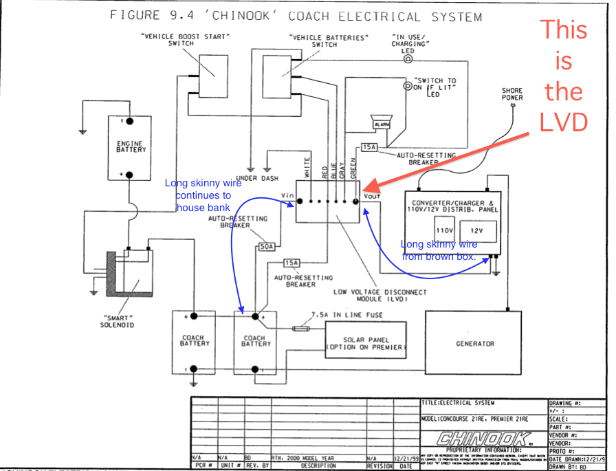

Okay, so here is the LVD drawing. I'm going to look through with the idea: Is there any good reason to keep the LVD?
1) It cuts off the batteries at 11.8 volts. This is too low if you want to actually protect the batteries from over-discharge.
Alternative: Victron BMV (shunt) allows you to set low voltage alarm, so you have an alarm again. You can set it for whatever voltage OR percentage of SOC you want. So I say in this way the LVD is obsolete.
Here is the drawing below. On this drawing I've only highlighted where the "long skinny wire" comes in and goes out. So as far as that is concerned, if we decide there is no reason to keep the LVD, the long skinny wire that will now be a shorter, fatter wire would no longer need to be joined at the LVD. Instead it would go straight from the brown box to the house battery positive main fuse (which you will be adding - MRBF if you have the extra height you need). This also negates the very crappy auto resetting breaker thingies underneath the coach body, which you could just get rid of.
I'm just going to notate it in stages or else it would get too cluttered. Here it just points out that one wire:

Here is the third annotated LVD diagram. This part is a little more complicated. In my view this is nothing to keep, but it brings up how you would RATHER it be.
Let me put in the diagram and then type more below it.
Okay, so why is this complicated or why does it even exist? Well oftentimes you'd have a wire feeding your loads (DC fuse block), and then another wire taking power from your AC charger (IP22) to the batteries.
But Chinook decided not to only have a looooong skinny wire, but give it two jobs! It carries the (4645) charger power to the batteries, AND it carries the power from the batteries to the loads (via the blade fuses in the right side of the brown box).
Now in ye olden dayes, it was customary to think you had to be charging, charging, charging your batteries ALL THE TIME. Even when parked. Even when stored. Always.
Okay but if you turn off that little switch in the cab overhead (to turn off the loads), then, surprise, you are also cutting off the charging, maybe unnkowingly. So there there is a whole complicated set of LVD wires and a buzzer to tell you not to do that! So if you are charging, and you turn off that switch, you get a buzzer to tell you to Stop That and turn it back on (correct me if I'm wrong but I am 99% sure this is how it worked).
Were it me (and it was, ten years ago), I would say this is not the way to go. Here are two options:
Well let me back up and say you should always have a main battery switch. A real one. Meaning a nice, chunky switch right next to the house bank. This allows you to cut the batteries off from everything instantly if there is a problem. Or turn them off in storage. Or whatever.
Okay, so option 1 is to keep just the one wire (really a set of wires but the negative is the chassis ground). Put your battery switch on the house bank. I think it's going to be pretty obvious to you that if you turn that switch off, thereby cutting off that (now shorter, fatter) wire, that you won't be charging the batteries. So no complicated little buzzer system needed (of course it's less obvious what you are doing when you are sitting in the cab poking tiny matching rocker switches).
Option two would be more complicated and likely not needed, but it would be to have two separate wires (this is more usual but not more necessary). One wire goes from the batteries to your loads. One wire goes from the charger to the batteries. Now you can cut off loads and still charge. I'm not sure how necessary that is though, and you would want either a second switch or a two-position switch. You know your uses better than I do.
A note is that AGM batteries will keep their charge in storage MUCH LONGER than flooded cells do. So I posit that if you turn your loads off (main switch), there is not need to always be charging charging charging. You could make an argument that it's not even good. (I would agree)
With your shunt/app you will be able to see how the batteries are doing. If they need charging, turn the switch on and charge them.
I say your uses because if you leave your rig unattended for 8 months out of sight out of mind, maybe it's different. But then would you leave a battery charger ON for all that time out of sight out of mind? I wouldn't!
So in summary, I see zero use for the LVD in your case. It's just more complication and the low voltage alarm doens't come on until the voltage is really low and there is no adjustment. I can tell you that the alarm from the BMV 712 is very easy to hear! And you can set it for SOC % or voltage.
(That said I would like to see if the Smart Shunt has an alarm, because otherwise I think the BMV 712 is better- the head just connects with one click of a "phone cord" so it's easy if it would work better. I'll have to look at the Smart Shunt manual.)
Please let me know if you see anything I have missed. It's been over ten years since I gave the LVD the boot (have not missed it once).
