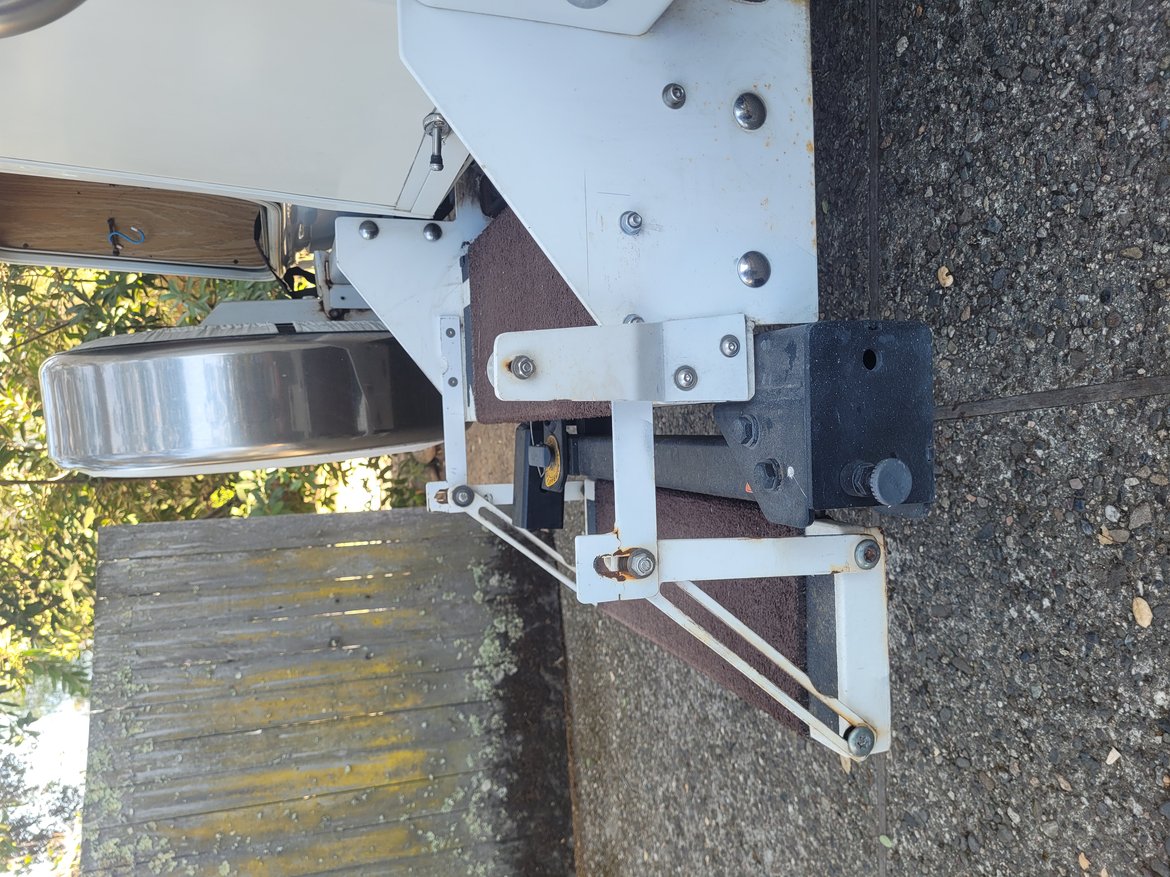

I have the Thule Swing Away with a Kuat double bike rack. Yes, I made modification to the step so it will fold up and down. I will photo and post later today. Should be noted the modification did adjust the hight of steps about one inch.

Some photos of manual step modifications. I believe the modification raised step height 1.5 inches from ground. I am out of welding practice. Therefore, no comments about weld quality.

Re: Rear Entry Bike Rack options?
Thank you! Your photos really help!
