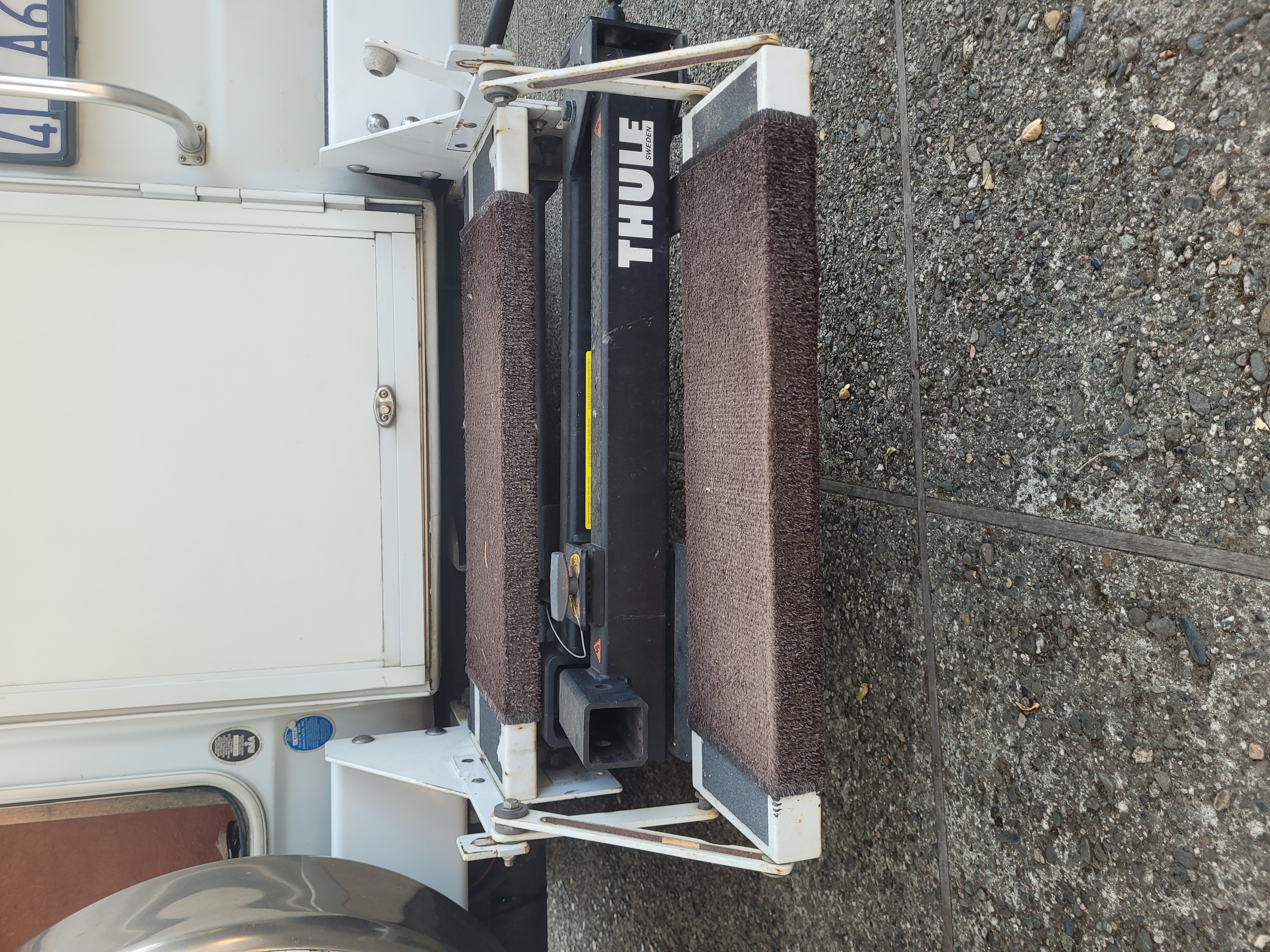

We got a Thule swing away hitch and a 12" extension and it works great. Only issue are the stairs...they don't quite line up with hitch. I'd be interested to learn if anyone modified their steps to accomodate a swing away hitch.

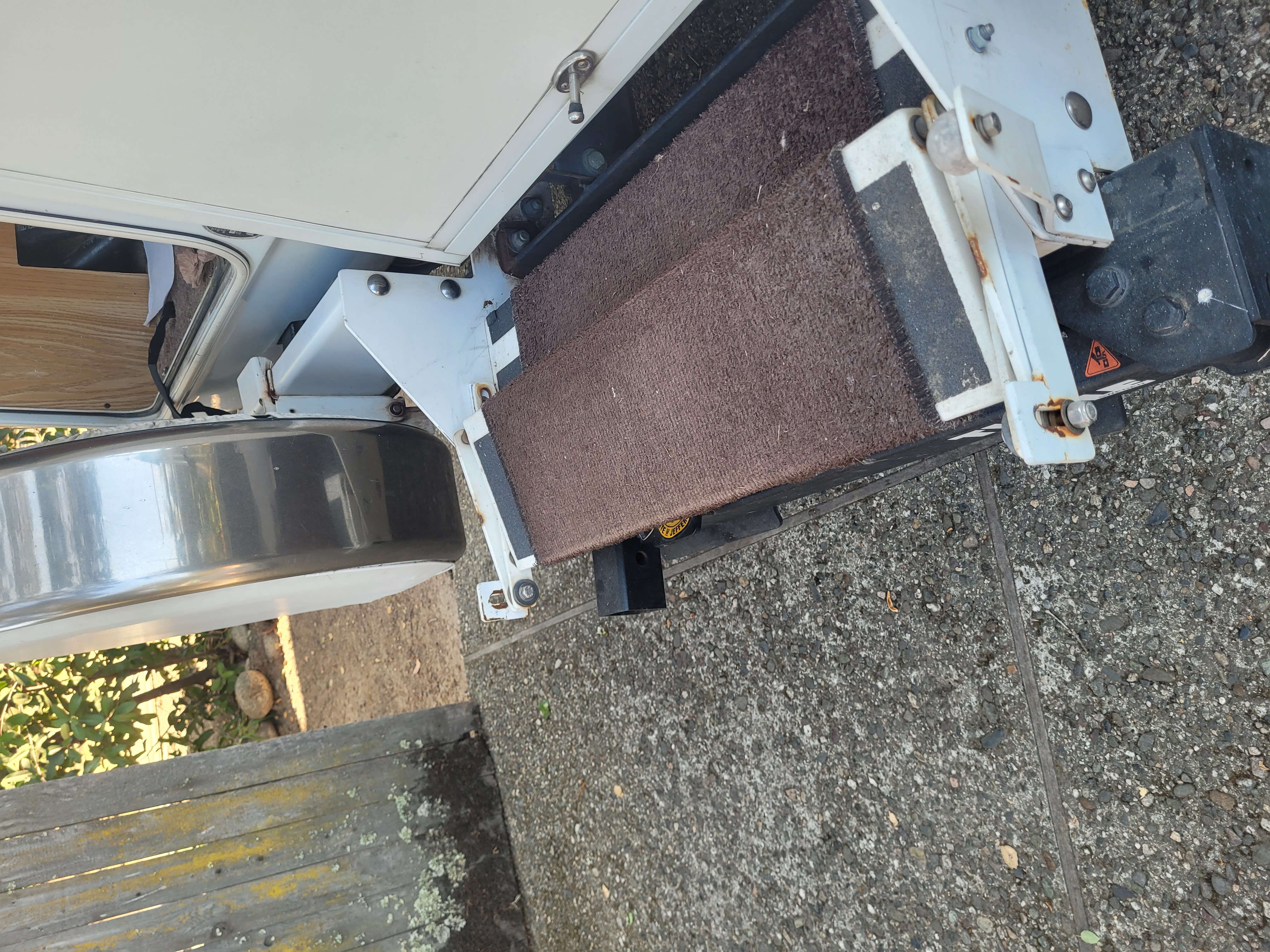

I have the Thule Swing Away with a Kuat double bike rack. Yes, I made modification to the step so it will fold up and down. I will photo and post later today. Should be noted the modification did adjust the hight of steps about one inch.

Some photos of manual step modifications. I believe the modification raised step height 1.5 inches from ground. I am out of welding practice. Therefore, no comments about weld quality.

terance13
Posts: 77
Re: Rear Entry Bike Rack options?
Post by terance13 »
Thank you! Your photos really help!
