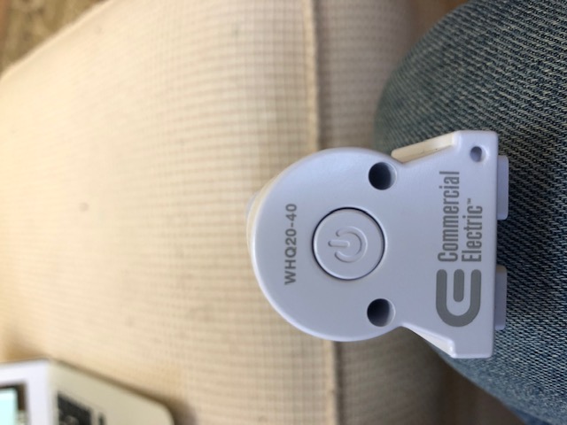

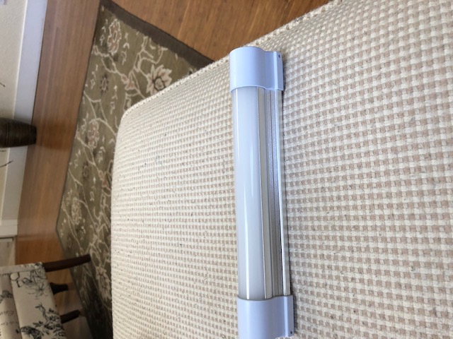

Michael--I had same issue with my fan blade, and decided to do a "quick and dirty" upgrade--replaced just the fan blade (Heng's JRP 1002R Jensen Fan Blade counter clockwise rotation) from Amazon. Then for lighting, I used two portable led rechargeable work lights with magnetic base that I mounted on either side of the medicine cabinet...like bathroom vanity lights (pic of lights attached). I have a third light like this that I have mounted magnetically to the hood vent of the stove--oh so much better than that crappy original...and none of this draws from house batteries!
Clay's suggested solution is probably more elegant, but this set up works just fine for me. Got the lights at Home Depot.
