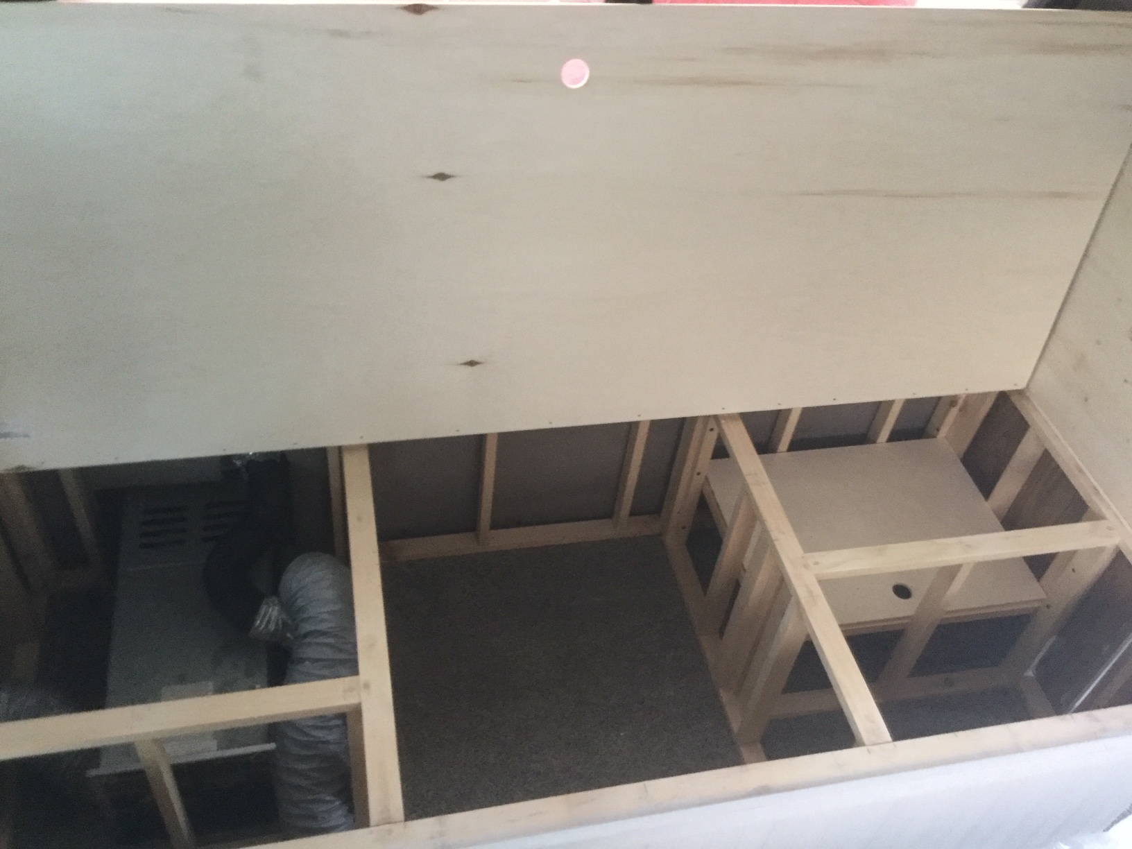

All done building! Everything has been disassembled, glued, reassembled, trimmed, filled, sanded and is now paint and clear coat ready. Mattresses to still cut down and fit more perfectly and two tiny pieces of moulding to install now that final measurements can be taken. This was a massive project and I have to say, I'm glad it's over. Everything remaining will really start to pickup steam and won't be anywhere near as complicated going forward so I am excited to get to start something that isn't white that you sleep on

You know Blue, the more I look at your twin bed configuration photos, I'm noticing two air vents...I'm wondering if the "sealed" twin bed frame vs. the more "open" couch configuration kind of keeps moisture contained a little more and it might be wise to add in a few access points to keep the air moving?

Dano... re: Blue's "twin bed" photos, I think the vents are in place more for the LPG water heater. Leak detection, safety and all that. Much the same as for the furnace side. More air circulation would be a definite benefit since it's a tight box compared to the jack-knife sofa set up. (IMHO) I would at least add an air return vent grille to the cab side of the box, facing the drivers seat. In the same way you did for the passenger side.

Thanks for the confidence compliment, sometimes you get so involved you lose track of whether things are looking good because all you hyper focus on is a nail head! That's a good point about the hot water tank. The bed frame ends about 12" from the wall although you can't see it so there is actually a reasonable sized opening right beside the tank, I think that will work just like you suggest so I think I'm good!

I agree with Hoosier on the reason for the vents. Another one is that as the water in the water tank vs. the air warms and cools, the tank will sweat at times. Don't want that moisture to just sit under there.
