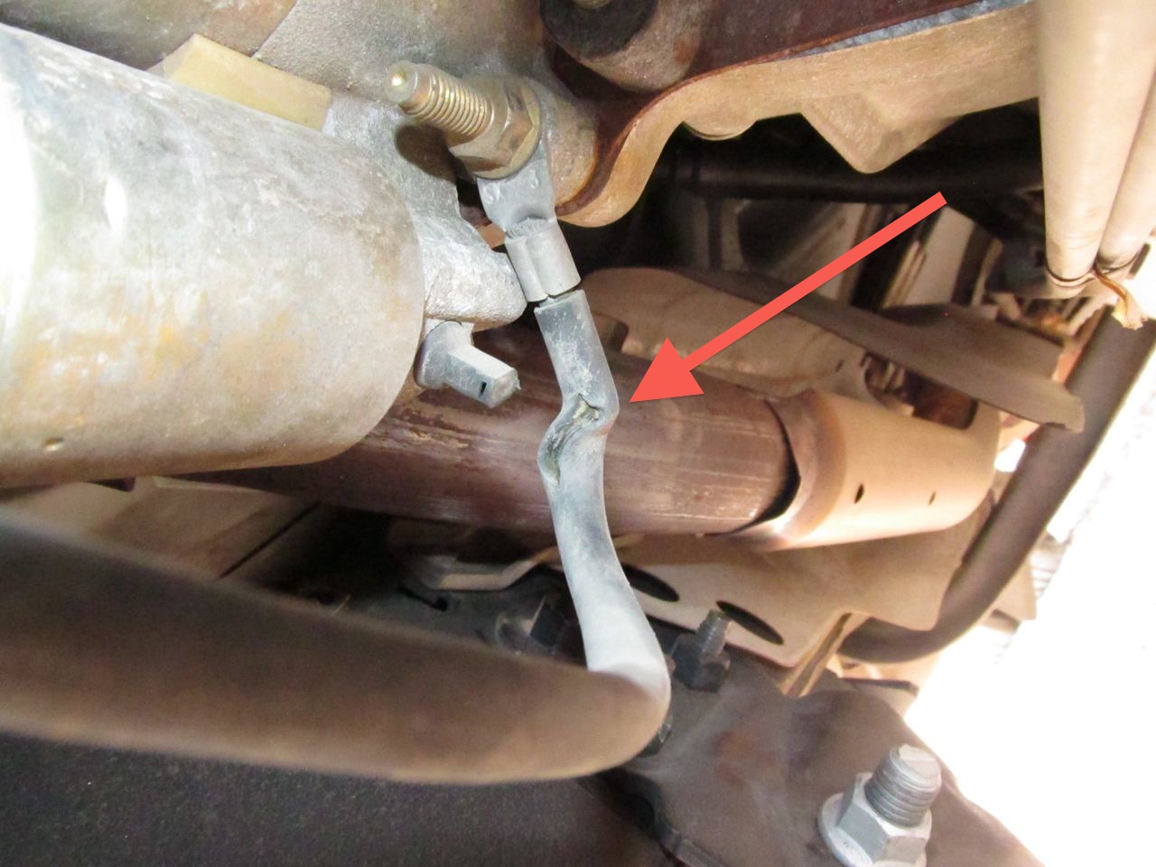

Sounds like you know how to diagnose things, but just in case: A few years ago I noticed that the negative Ford cable that goes to the starter had an awkward bend just before it attached to the starter (courtesy of Ford, not Chinook). Right at the bend, due to stress I imagine, the wire insulation had completely cracked, and the crack was facing forward (as you drive). The copper wire inside was completely green. I replaced the last 6" or so of the cable and terminated it in such a way as to avoid the awkward bend (was fun getting under there with the big crimpers that have like a 5' wingspan...)
I hadn't had any trouble starting, and annoyingly for the sake of research I replaced my battery at the same time (which is why I was inspecting the battery cable harness), but I can say it turned over MUCH more quickly after I did the work. Gee, I hadn't realized it was slow.
Here is a photo: Red arrow points to the problem spot on the stock Ford negative wire; silver "can" off to the left is the starter.
