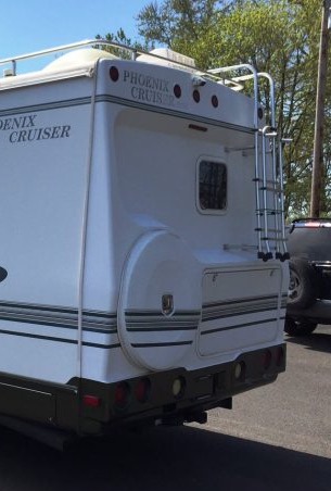

After toying with a variety of options for getting the spare off the bumper I'm thinking of just not carrying a spare. I know some of you already don't carry one but I'm interested to hear some of the reasons why you don't and what you would do in the event of a flat.
I've considered moving the spare to the front but I'd prefer to shorten the rig and not have anything protruding beyond the bumpers. I'm considering mounting the spare above the rear storage compartment by reinforcing the rear wall with plywood and/or metal plates to mount a spare carrier but I'm wondering it that's a sound idea given the weight of the spare. I have seen some older Class B's with this type of mounting but I don't know if there's metal frame to attach to or not.

Nope, no metal frame, but hmmm... what if we modified the rear storage compartment to take most of the spare, something like this:
Ah, never mind. The bath sink gets in the way, methinks.
For some reason I feel like there might be enough room to store it underneath the chassis on the forward driver side, but need to go look when all this rain stops.

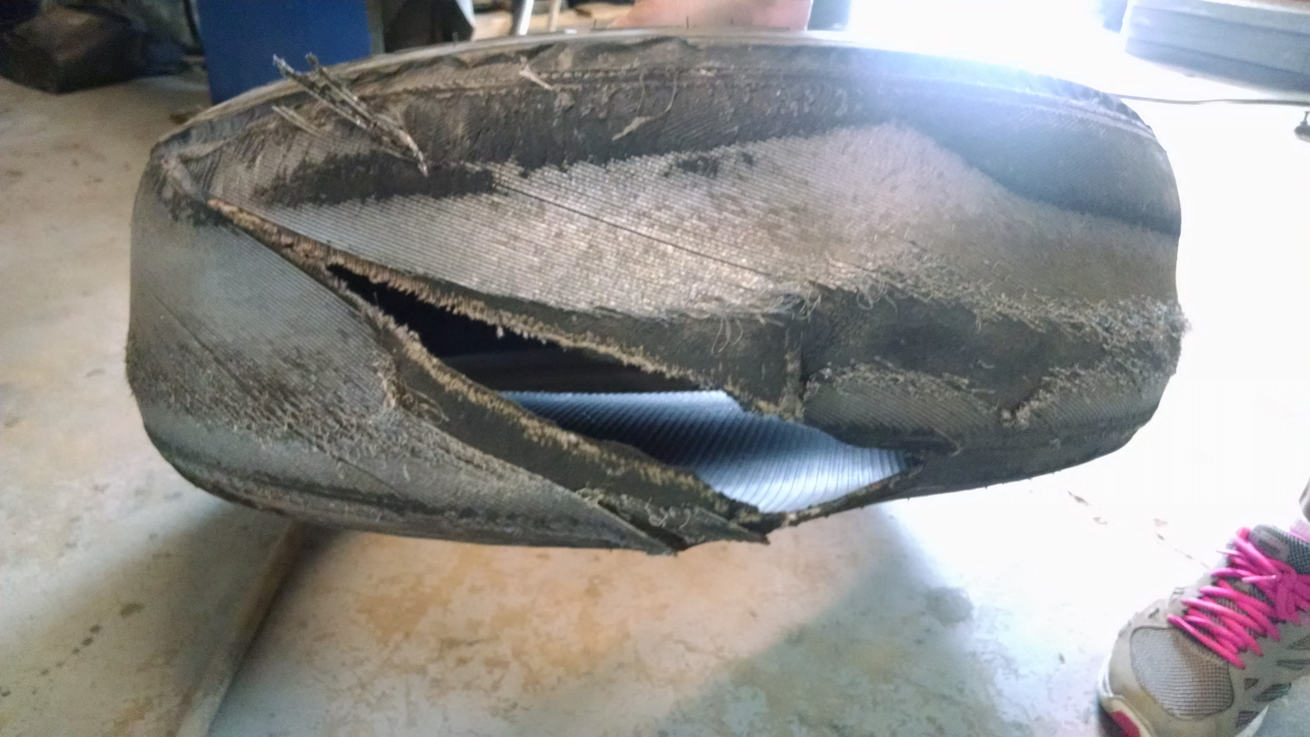

I had a flat, blowout, delamination at 70 mph on the highway in Utah. It was scary and I'm extremely thankful that it was on the rear duallie. I abruptly realized that the spare that came with my rig (probably not original) was not rated as a duallie and wouldn't carry the load. We limped 15 miles (very slowly, maybe 20mph tops) to the nearest town and got a used tire that was better than what we already had. If you've been through Utah, you know that we were lucky to be that close to a town. Much of our trip was nowhere near civilization and not in cell coverage. As soon as we got home, I had a new set of Michelins along with a matching spare. I've used the jack once for an unexpected flat on a dirt bike, I'm not comfortable jacking such a heavy vehicle, I'm not convinced that I could turn the lug wrench with enough torque even though I'm a reasonably competent shade-tree mechanic.
That being said, I'm not leaving home without my properly rated spare and basic tools.
