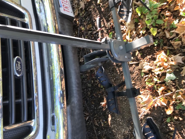

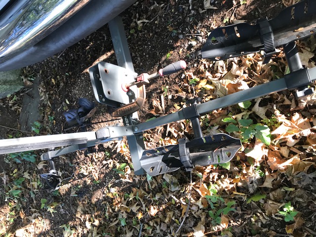

Jim...I also run with bikes on front. We have a 2004 Premier on an E-350 super duty Ford chassis. I mounted a Curt 2" front hitch that was spec'd by etrailer specific to the E-350 cutaway rv. I just took a look underneath, and the damper (at least I think it is the steering damper--hydraulic attached to steering linkage) is definitely there...the hitch is mounted at either end directly to the frame...nothing required to be moved/removed as far as I can tell.
Our bikes are Copenhagen Wheels (high-tech electric assist) and they weigh 44 pounds each. The rack that I use (and like) is a Swagman Dispatch. It is rated for 45 lbs per bike. To take any road sway out, I use a 2400lb torque "C-clamp on the vertical hitch housing fins to augment the bolts it comes with. I further modified it a bit by dropping the top bar that extends out so that it rests on the bar that goes into the hitch. This required drilling new holes in the vertical fins...no big deal. By dropping the level of the bikes in this way, I get better visibility from the headlights (still have stock headlights, but will probably move up to something brighter from Vantage Optics (vantageoptics.com) in the near future.
To protect the bikes while traveling, we use SKINZ covers (skinzprotctivegear.com)...great product.
I've done at least 10,000 miles with the bikes mounted--NO ISSUES. TOTALLY SOLID.
Here are a couple of pics of the rack.
