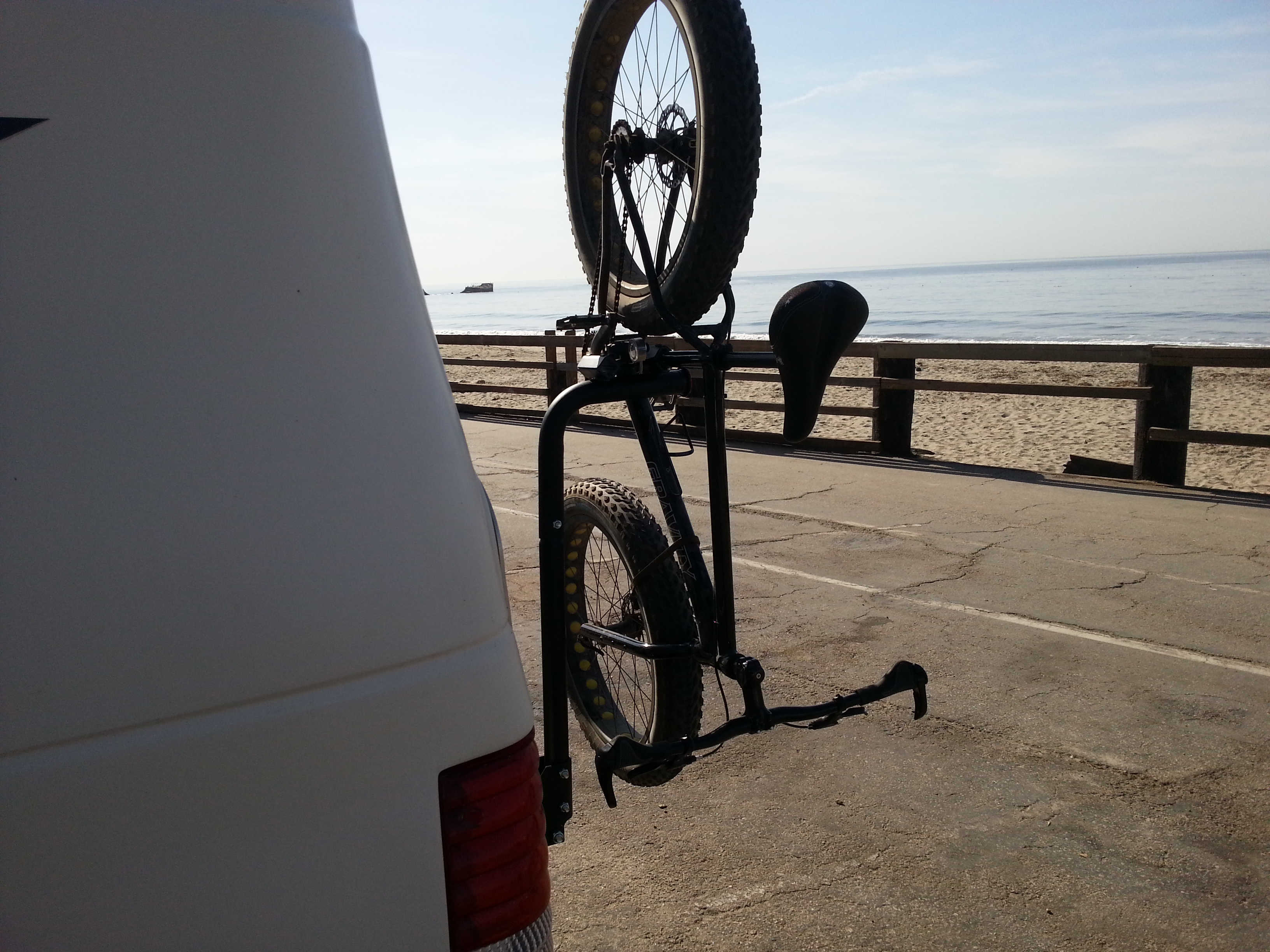

I have a Husky double rack. Very sturdy. It has the swing down feature, but I seldom use it since we can slink out the back door when the bike is mounted vertically. If I remove the front tire and rotate the bars, it sticks out much less.
