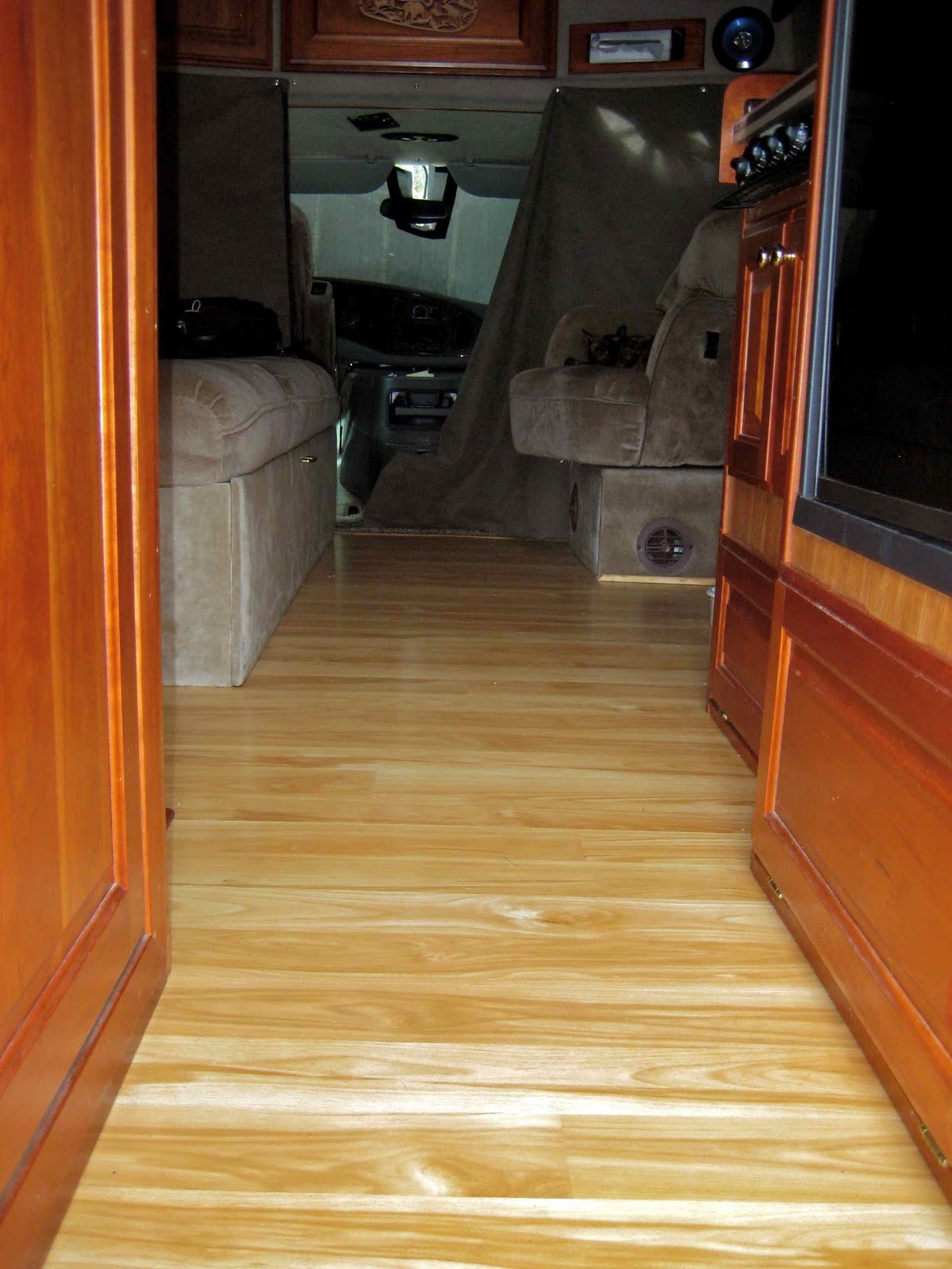

Glenn did put laminate planks cross-wise in his Chinook (since sold). It probably was easier but he also liked the look. I prefer the lengthwise look myself. He did mention that after a year or so water seeped down into the cracks and there was a little buckling (maybe by the sink or the cat water bowl?). In his next camper van he went with sheet vinyl - all one piece.

So you can see what you think, here is a photo of a Chinook (the above-mentioned) with the crosswise laminate planks.

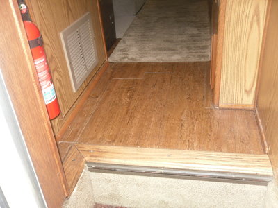

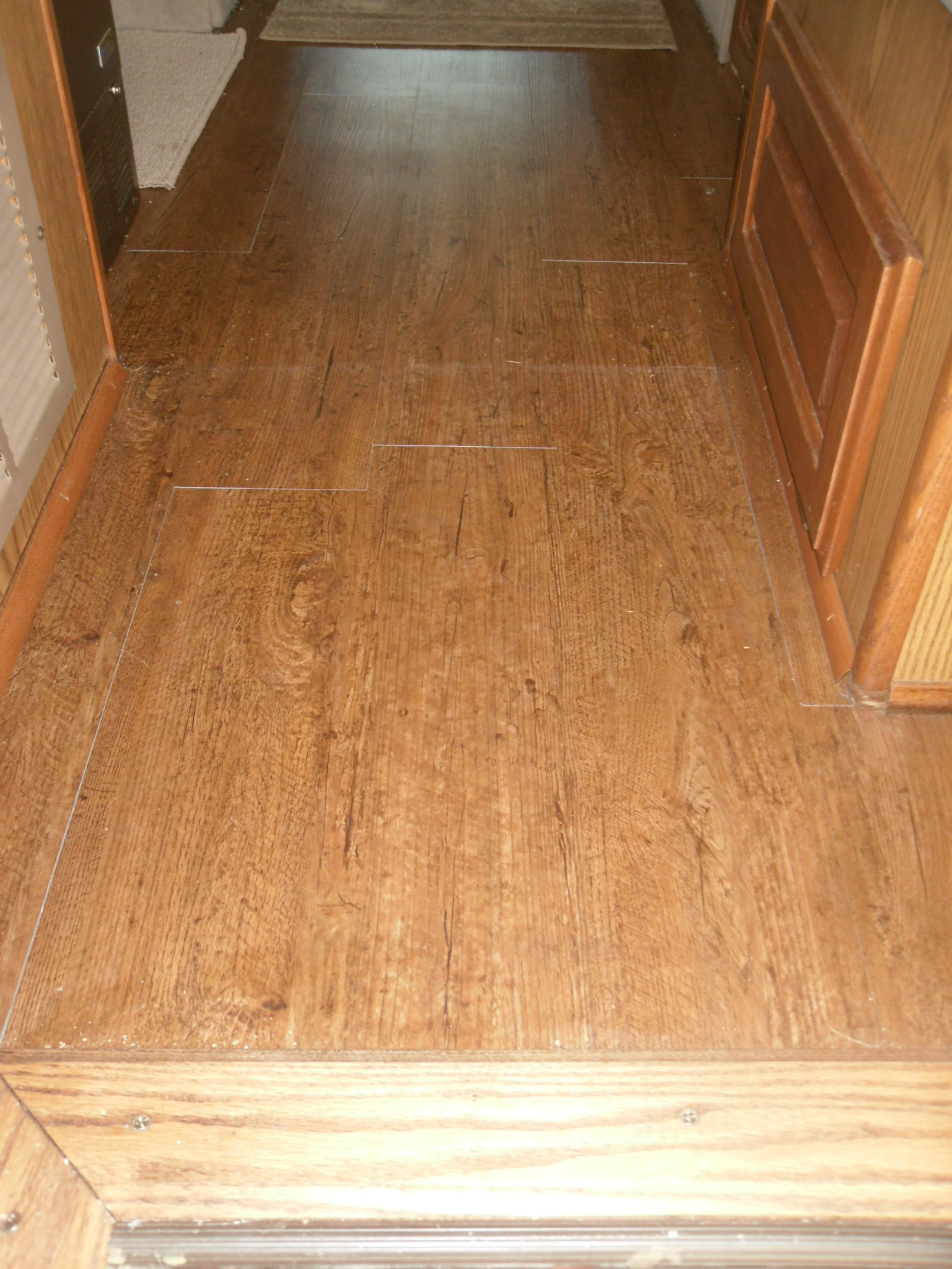

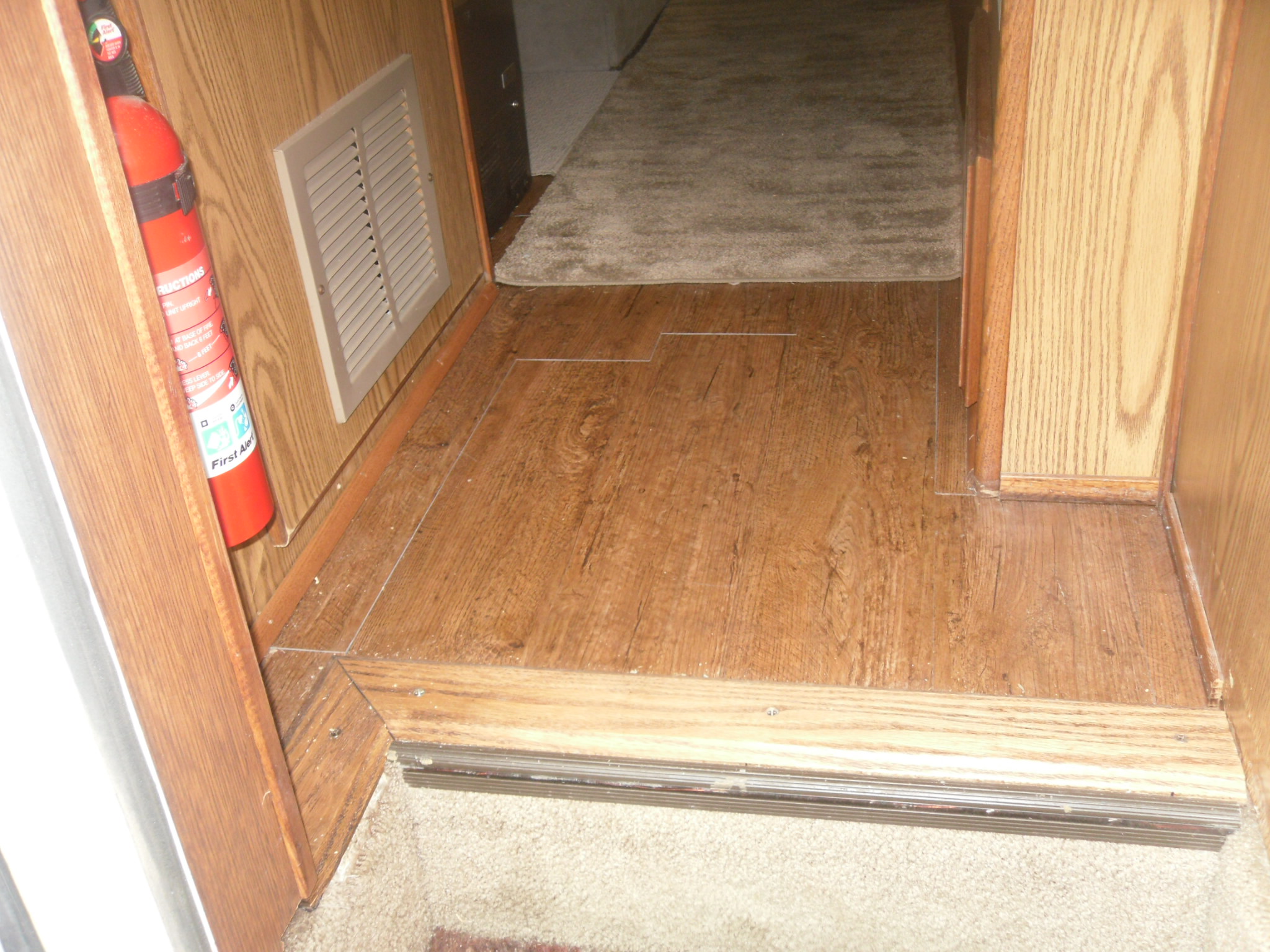

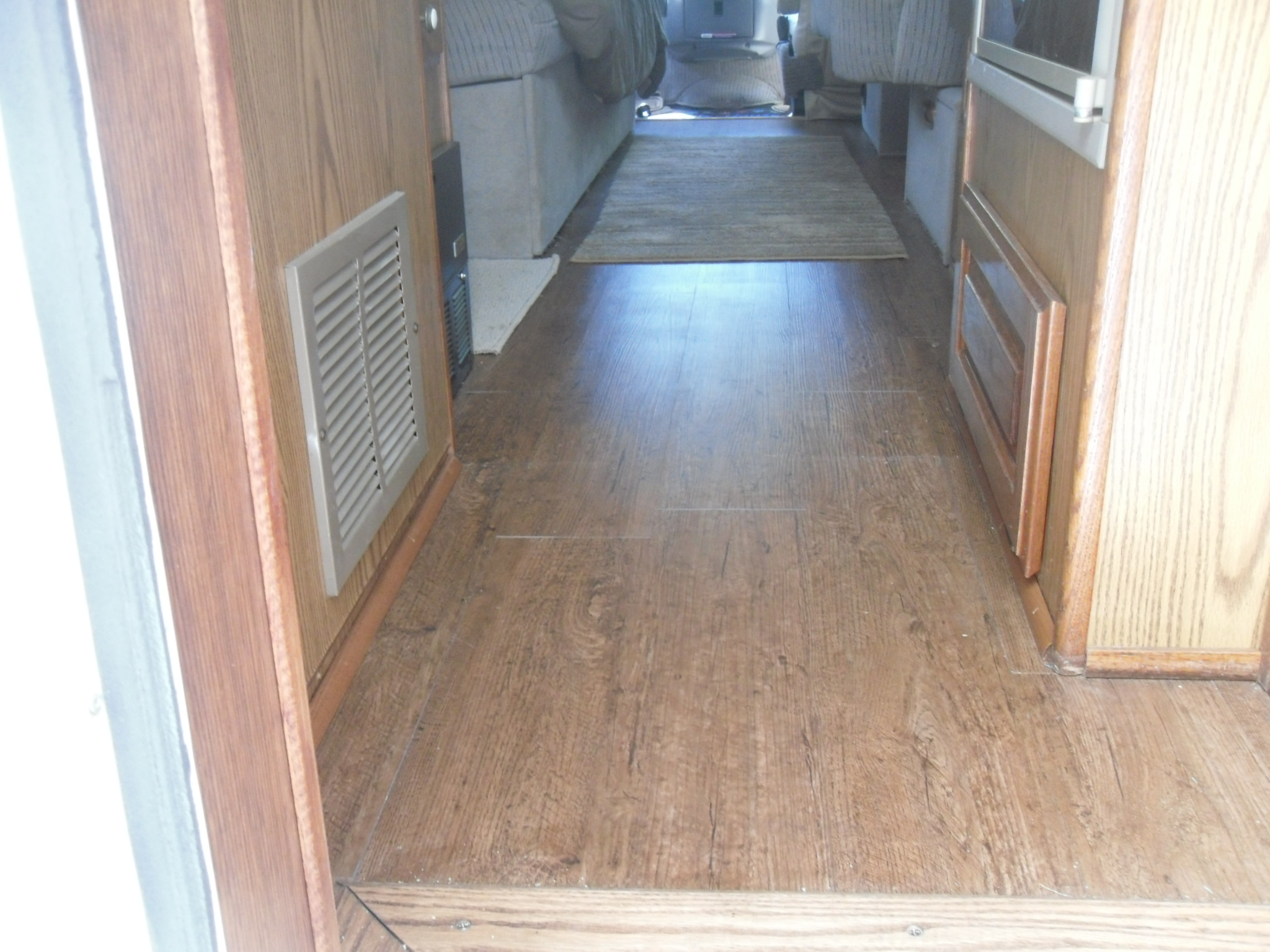

Vinyl strips from Home Depot. They stick together and can be trimmed with razor knife. Going on my 3rd year with no problems even after dumping the dogs water bowl a few times.

Tim, that looks really nice and it's good to know that the "non room temperature" of an RV hasn't made it buckle or shrink (as they warn).

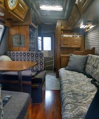

As for wood or vinyl, I did both. Wood planks in the rectangular living area, and easy to cut sheet vinyl tile in the rear kitchen/bath area. Best of both worlds.
Two portrait photos stuck together side by side:
