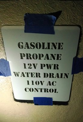

Anyway, now I felt the need to create a color legend underneath the middle floor, for repairmen and the next owner. So I ordered a custom plastic stencil from an eBay supplier. About $14 with first class postage.
The tan is the fiberglass bottom of the coach. I painted a black background yesterday and let it dry overnight. This afternoon I made a mask to allow me to spray paint each line:
Hmm. Looks like I'll have to touch up a few letters.
And yeah, perhaps I've gone off the deep end now :lol: ... But boy, my undercarriage layout is now easy to figure out !
