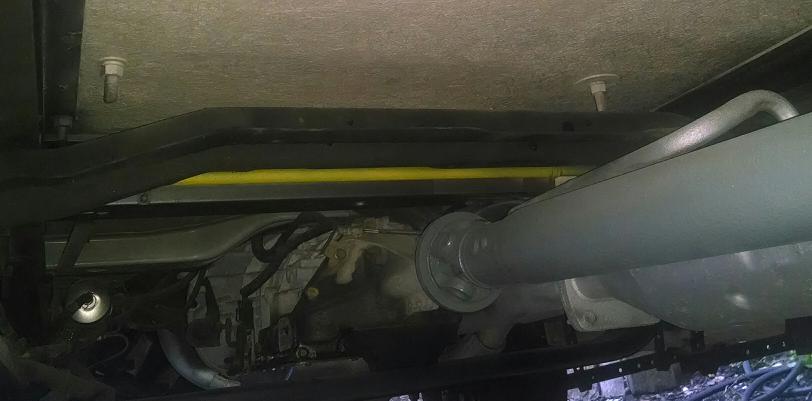

Each nice weekend I spend a couple of hours a day under the Chinook, cleaning up the undercarriage. I clean off oil with a degreaser, wire brush or sand off any surface rust, spray rust conversion treatment, then use high temperature / rust proofing paint to keep it protected.
I figure getting it cleaned up helps me keep an eye on things (like a new small trans fluid leak), plus I think it helps when taking something in for repair if it looks like it's been taken care of ;)
It started with wanting to check and paint the propane tank, which looked like a rusted mess... but turned out to have just slight surface rust and was perfectly okay. Instead of white, it got painted silver, btw.
Then while working on the shocks, I started doing the same with the driveshaft, exhaust and frame. The driveshaft I painted engine light grey, the exhaust pipes and mufflers got a shiny aluminum, and the rest got a combination of shiny black for suspension, flat black for frame, and BBQ grill dark grey for thinner cross members.
This past couple of weekends, I've also done the fiberglass shell's bottom in beige, and started marking things like the water tank drains in blue, and the propane gas lines in yellow Plasti-Dip, using Navy / public service style pipe color coding.
Propane line
Propane line
The next owner will find it very easy to trace out various parts of this Chinook!
And I've discovered a LOT about where important lines are routed underneath.
Next up, marking wires with a label maker! (Which I recently did inside the refrigerator access panel.).

Sounds like a great idea. How are you getting underneath? Are you jacking it up? I can only get my head and top part of my chest under there.

I'm slim enough to slide under pretty well, but I still sometimes drive it up on leveling blocks front and/or back to give me a couple extra inches clearance. (Oh what I would do for a drive-over concrete pit like at oil change places!)
The blocks make it high enough that I can almost sit upright underneath next to the driveshaft on the driver's (non exhaust) side. A utility light or lantern helps a lot, btw.

Back to the undercarriage... marking the 110v shore line was interesting, the way it goes around the outside on mine just to go back inside by the generator and switch.
Also interesting was following the generator gas line. I'm learning a lot. We should create our own detailed map of various Chinook models and their wiring etc.

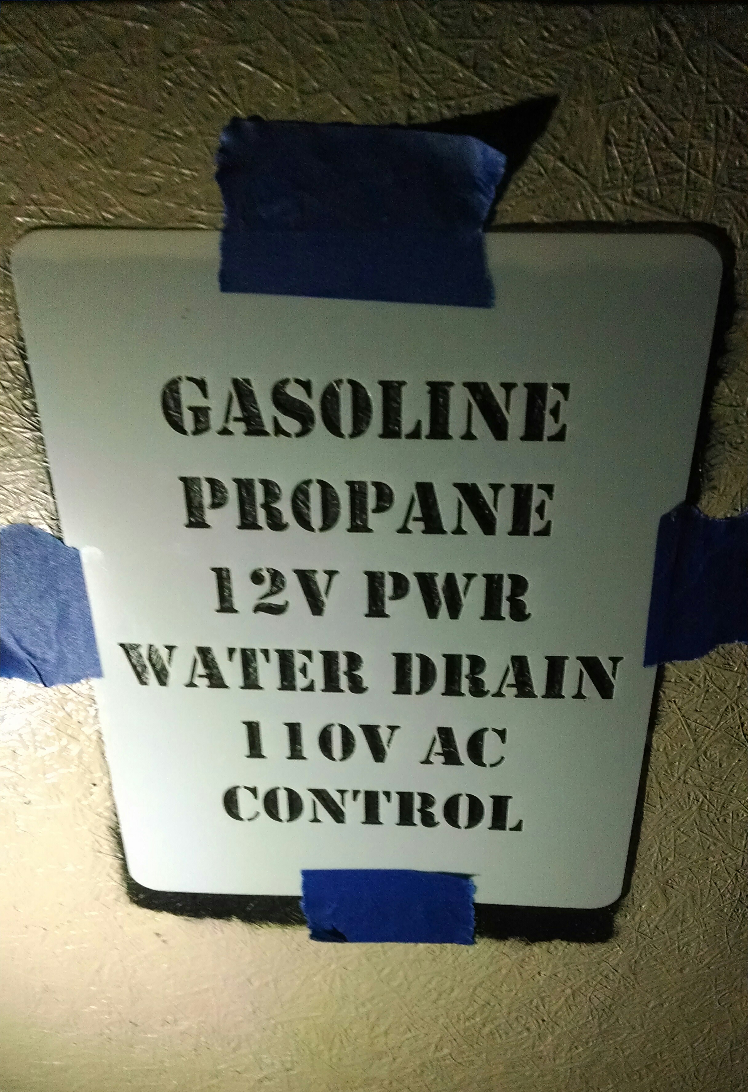

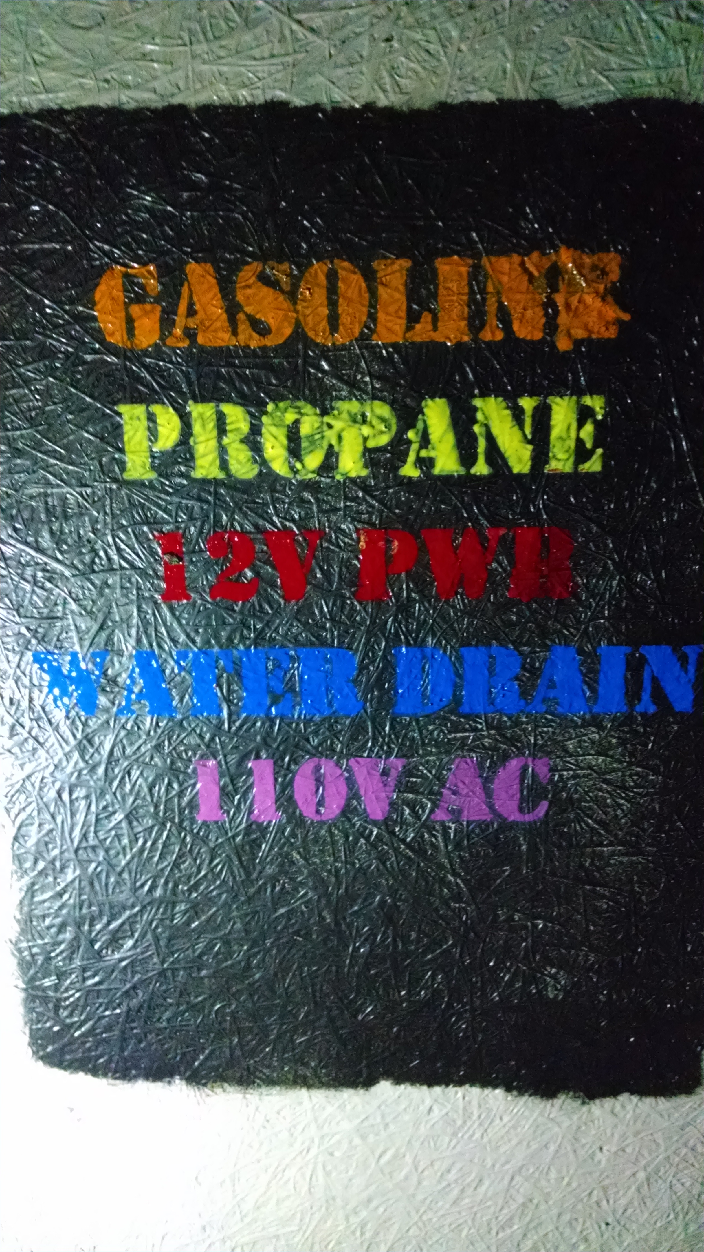

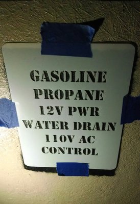

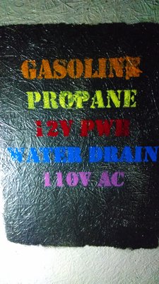

Anyway, now I felt the need to create a color legend underneath the middle floor, for repairmen and the next owner. So I ordered a custom plastic stencil from an eBay supplier. About $14 with first class postage.
The tan is the fiberglass bottom of the coach. I painted a black background yesterday and let it dry overnight. This afternoon I made a mask to allow me to spray paint each line:
Hmm. Looks like I'll have to touch up a few letters.
And yeah, perhaps I've gone off the deep end now :lol: ... But boy, my undercarriage layout is now easy to figure out !

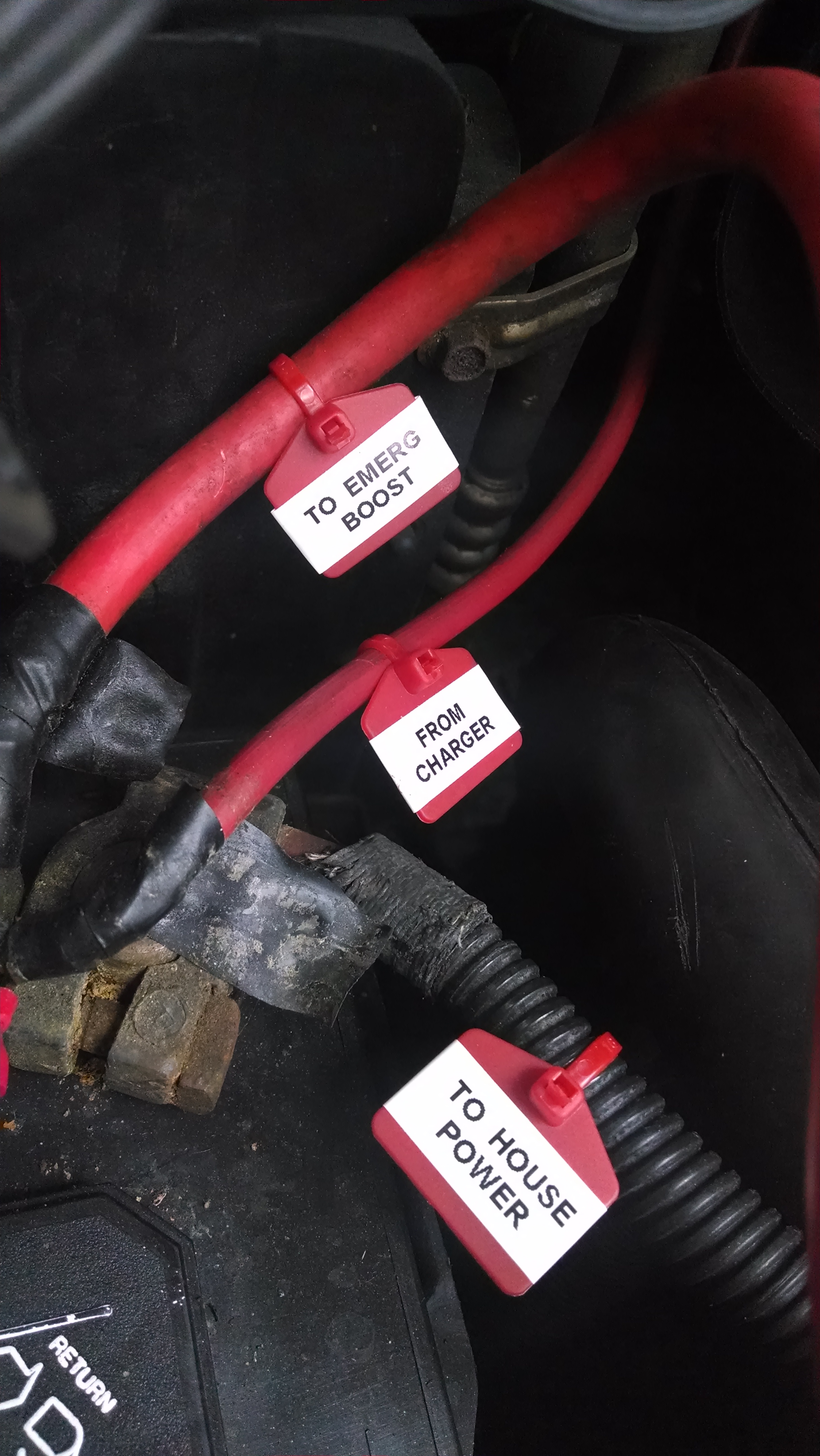

As mentioned in another thread, I ordered 100 zip tie tags off eBay the other day to help with labeling things. Cost about $13.
Along with a $14 Dymo electronic label maker:
Here's what the wires on my house battery (94 = single one under hood) look like now:
I plan on labeling all the usually unknown wires and hoses and/or ones that I have to look up each time in a manual (like the wires for the fridge control).
I just wish a PO had already done all this :lol: . Would've saved me tons of guesswork.
