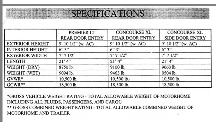

It's in the back of the owner's manual. See the forum's Reference section if you don't have one.
Here's the 1998 version:
Towing something? Tongue weight could be more important, due to how closely loaded to the rear limit that most Chinooks are.

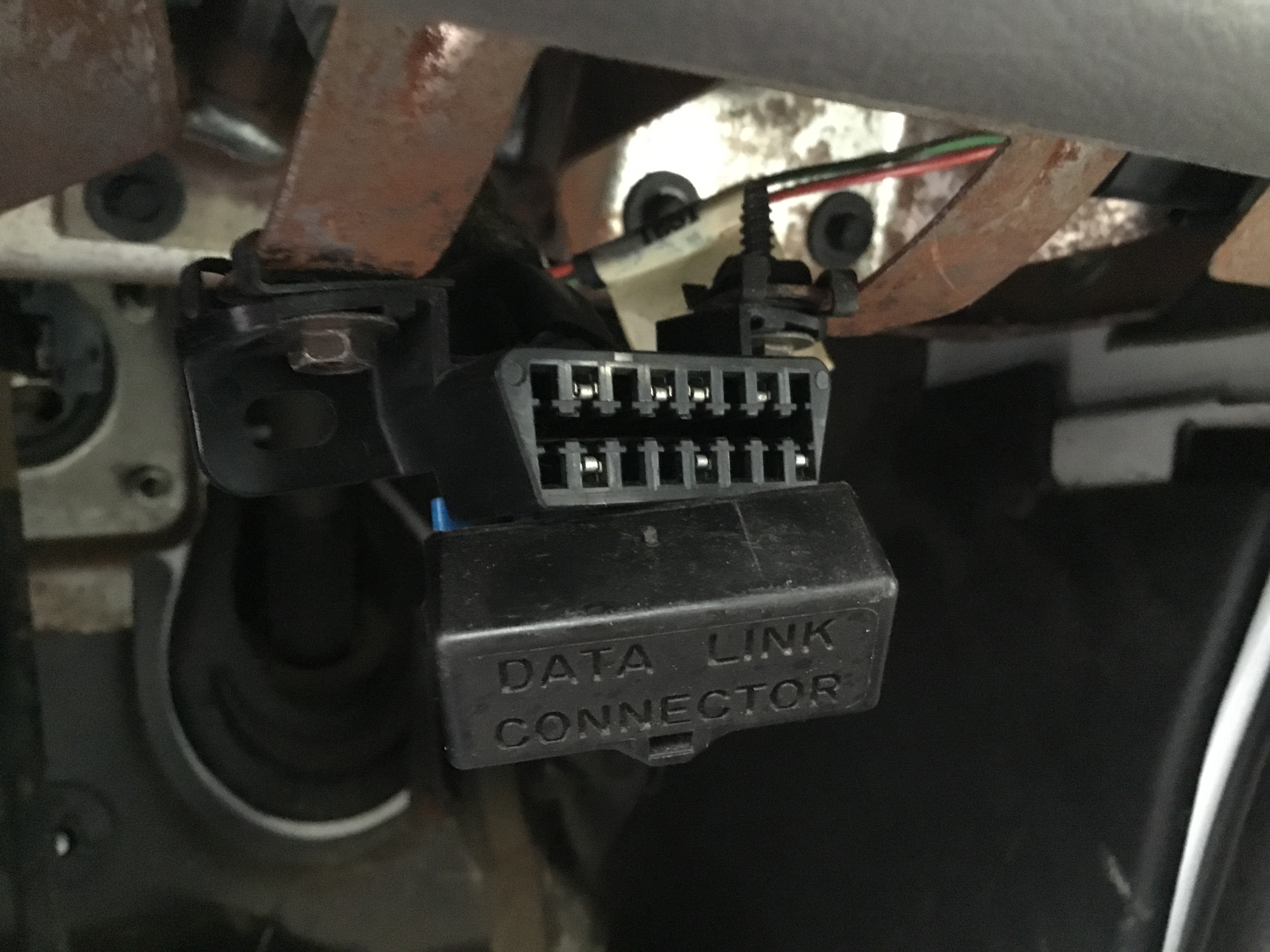

Thanks Blu-Go for the Scangauge info. Found the data port location, as seen in the photo. This is being added to the “must have” list. I also just realized you gave the Blue-Ox link for the exact toad we are getting...thank you!
