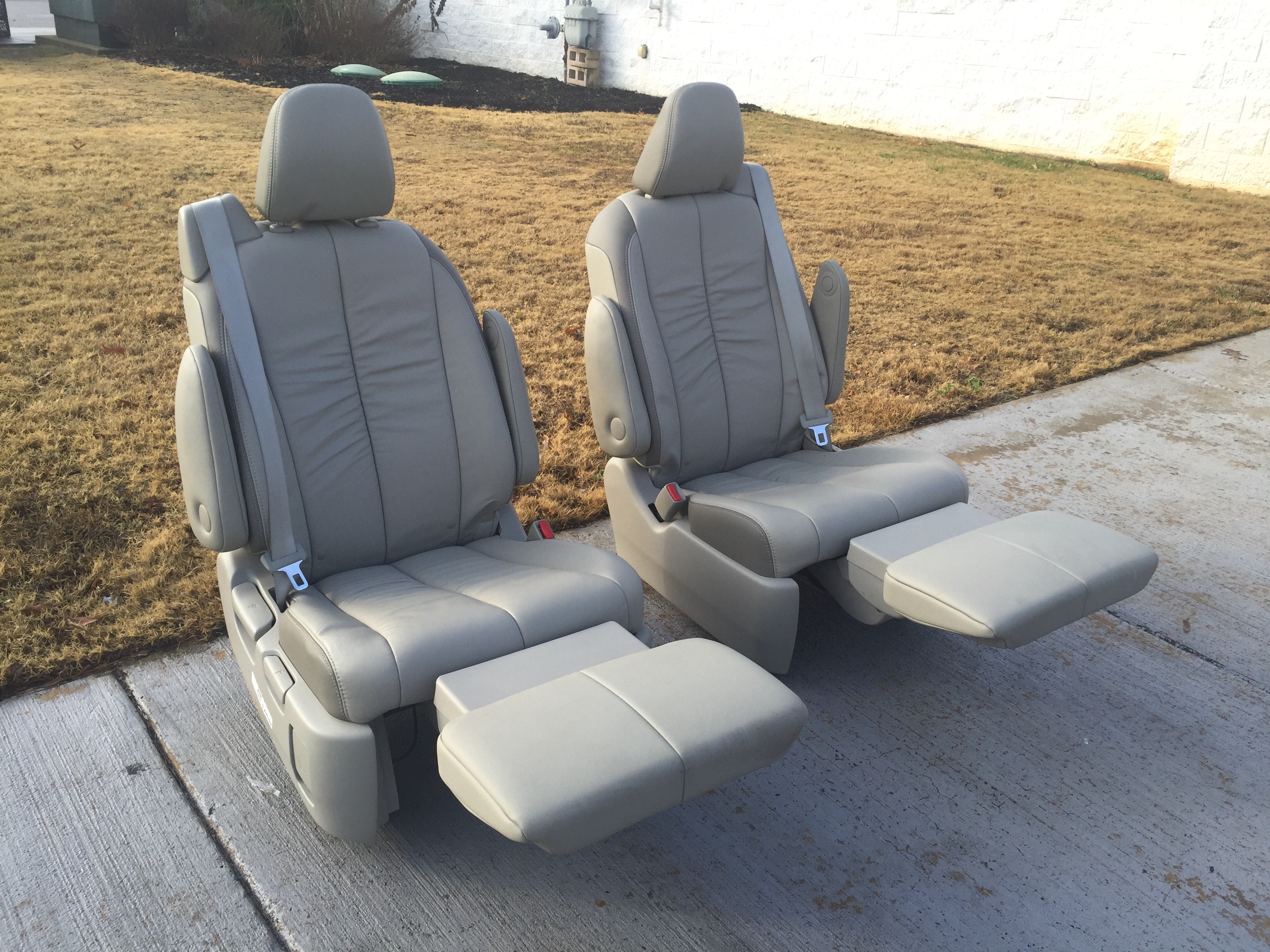

A seat out of a Toyota Sienna Mini Van. Going to be replacing my ugly front seats with them!pdemarest wrote:Hey Willy - what's a Seanna Seat?

Nice! Will you be able to install the passenger seat so that the footrest extends? My wife would love that feature and I would love to have leather instead of cloth. "Harvest Gold" is not really my color and cloth isn't forgiving for coffee/food spills.
Keep us posted!
Keep us posted!
Re: Willy's Mods Phase 2!
I'm not Willy, but I can say that yes, the Sienna passenger seat can be installed so that the footrest works. Obviously it doesn't extend much when facing forward; would extend further when swiveled around. On the driver's side the footrest is typically disabled.
Reason I comment is that I had purchased a pair of Sienna seats and driver/passenger bases for my Concourse. I ultimately decided not to install them for various reasons, but I had done a bunch of research on them, tried them out in a Ford van where they were installed, and of course looked them over when I had them in hand.
