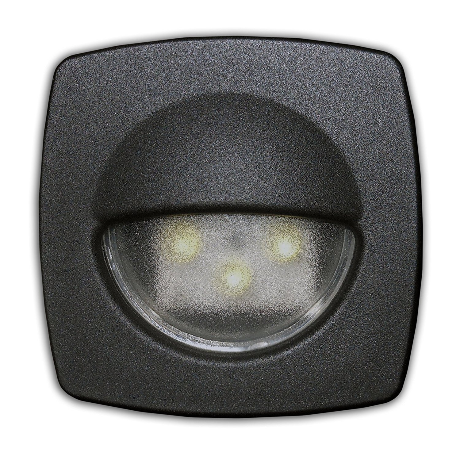

On my '01 Concourse, the wiring for the strip light starts behind the wall next to the rear entry door (driver side) and continues to the rear step where it terminates at it's end (toward the closet side of the step). Mine was beyond repair, so to replace it, I'm installing this marine LED courtesy light. Using existing wiring, it will mount higher up on the vertical "oak" wall that meets the driver side of the rear entry door, giving out much more overall light in that step area.

Thanks a lot for this info, Hoosier. Husband loves the light you're installing so I just ordered one.

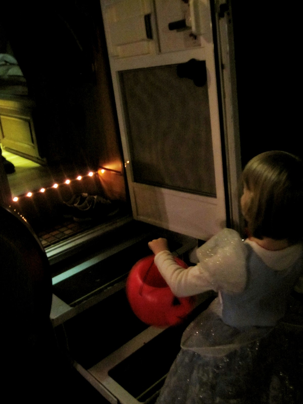

Just for info, I think most "latter years" Concourse owners won't need to run wires (or not much anyway). Not sure when it started, but I have this on my '99: The metal threshold on the upper step has a built in light strip on the forward edge (switched in the three-switch panel that's on the mini bathroom wall by the door in my rig, above the closet on others), so there is already wiring there for that.
Here is a photo that shows them (from a 2004 Concourse, complete with trick-or-treater).

Yeah my 94 has those step lights too. But you have to remember to turn them on and off, whereas a proximity light is always ready, and can't accidentally run diwn the batteries
Anyway, those step lights are what the OP was talking about. He wanted to go ahead and replace them with LEDs so he wouldn't have to pull up his new floor later on.
