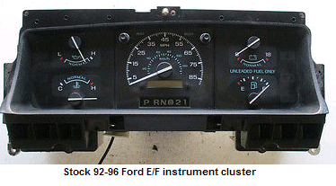

We live around a lot of hills, and the beast is always downshifting to go up hill, and I'm manually downshifting the other way. So I really wanted to know what the engine speed is. Unfortunately, the stock instrument cluster has no tachometer:
1992-96 Ford instrument cluster

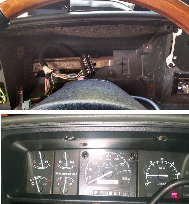

Even better, it turned out that while the E-Series never got a tach back then, the F-Series did have it as an option, and people had written quite a bit of info about doing a swap. Here is my panel open and then with the new setup installed:
Now, while it's close to being an exact swap, there are some wiring changes. Also, about six of the incoming wires change pin numbers between 92-93 and 94-96, so if you accidentally buy a different era instrument cluster like I did, then I had to change more wires than I would've if I'd kept in the same year set. Still, it only took a few minutes to do, using a small screwdriver to release some cluster plug wires and move them to a different plug slot. (There are lots of threads on the topic, and I first sat down with a VOM and wire color guide, and mapped out what wires I had to swap.)

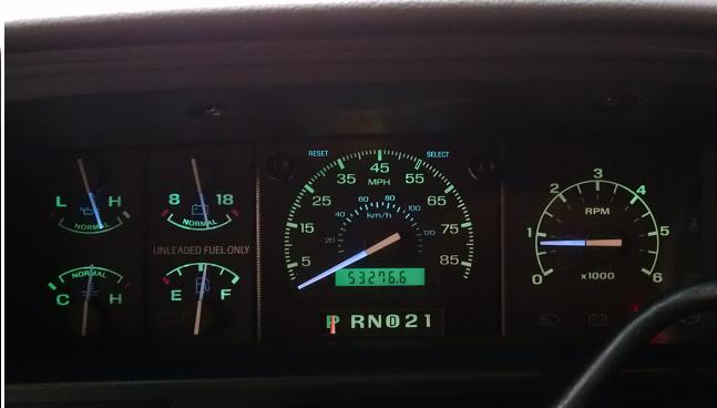

Anyway, I bought a 1994 F150/Bronco tach panel off eBay for about $85 - a real steal, usually they're about $120. I cleaned it up, replaced all the idiot lamps with new bulbs, and changed all the backlighting to light blue LEDs. I also swapped my speedometer for the one that came with the cluster, so I could keep my same odometer reading and tire size setting. Here it is in place running on my Chinook tonight. The writing stayed green, but the needle ends turned blue:

One dumb thing I did was fail to test the panel after I put the plastic window on. I didn't notice that I trapped the temperature needle while screwing it down and thus soon had to take my dash apart again to free it. Grrr.

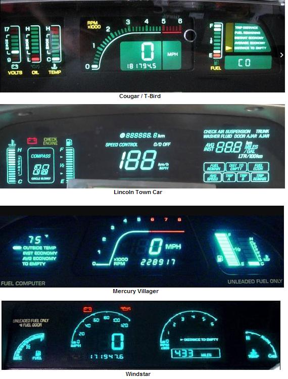

Interestingly, quite a few Lincoln-Ford-Mercury digital clusters of that era have analog gauge / digital speedo inputs and thus can also be made to work (though not quite as easily as the F150 swap, because the digital cluster plugs are physically different).
The Cougar/T-Bird has the most gauges, but is wide and has to be cut down. The Town Car fits almost perfectly, but has no tach. The Windstar actually mounts in the same holes, but tilts a bit more and thus needs some bezel mods. Also the Windstar expects a 6-cylinder engine, so its tach reads slightly high with a V-8.
I've already bought 1995 Town Car and Windstar panels, and worked out most of their wiring. Even got the remote compass for the Town Car one. I'm thinking of re-doing my chassis dash plugs to end in standard Molex sockets in a pattern I'll decide, and I'll set it up so I can plug in any cluster that I've done the same to. Just for fun.
