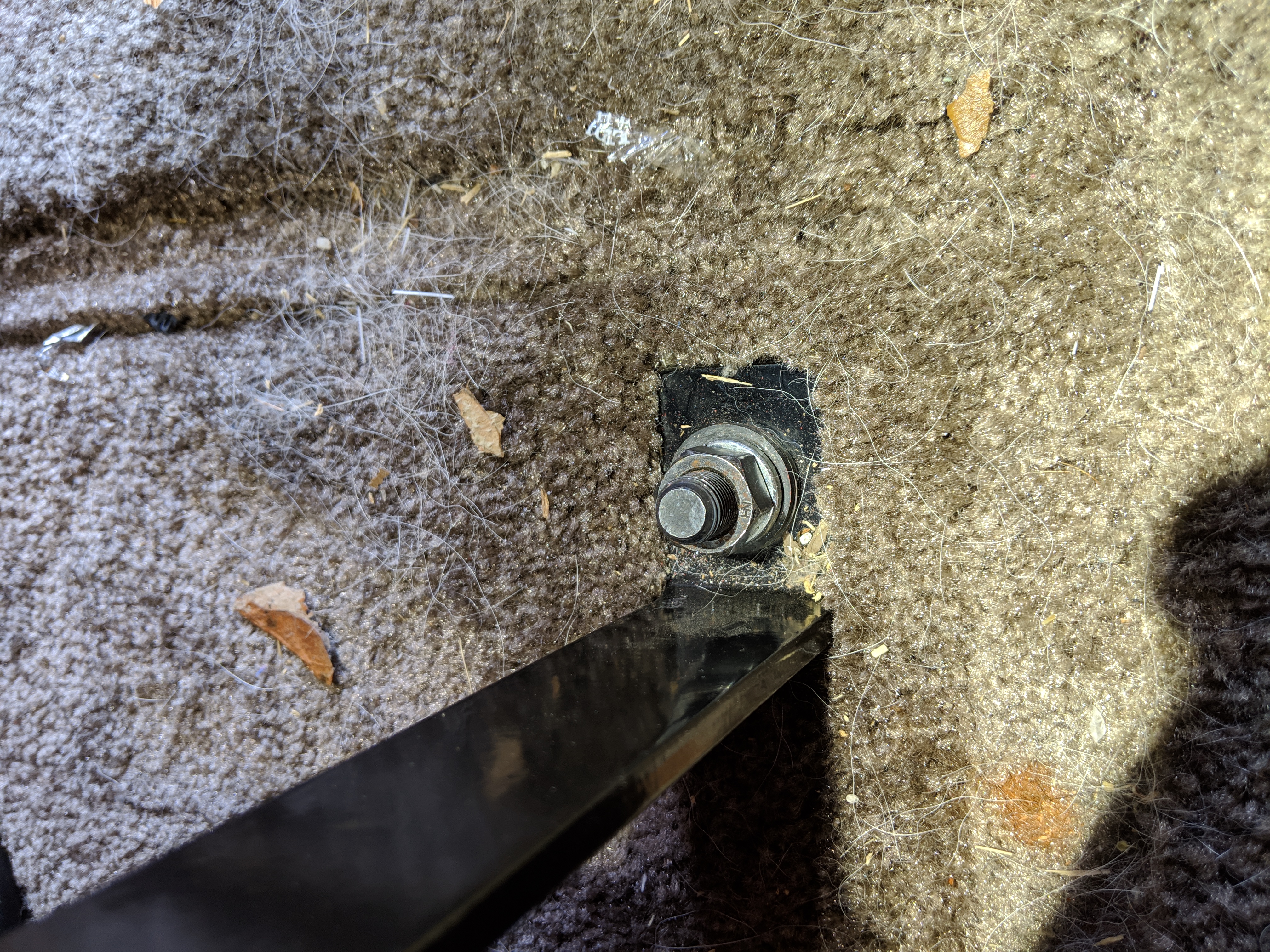

Soooo... Removed my dinette today. Furnace may or may not come out tomorrow. A more urgent problem is a shin-breaking metal frame bolted to the floor, with seatbelts attached to it.
Looking for ideas on how to remove this frame and found this thread, but it's left me a bit confused. Maybe someone has done this recently? Is it safe to remove the bolts, if we can figure out how?

Looks like the dinette frame is similar to the couch frame. That is, it's made of 1" tubular steel and through bolted to the floor. That makes sense as I think the dinette had seat-belted positions? As does the couch. (The Club bases are explicitly not for using in motion and are just boxes screwed to the floor.)
I don't see any reason not to remove the bolts and frame. It's possible they also hold up the propane tank but I highly doubt it since that tank is the same on the club layout. You should just be able to measure from something (or eyeball) and go underneath and look for the bottom "half" of the bolts. I can see all of the couch frame ones in this way.
The frames are just to make the furniture sturdy enough to (supposedly) be safe to sit in while underway. As I said above, the club chairs are not bolted down like this, and from what I have seen neither are the couch/beds in the model that has the built in wooden bed/couch vs. the Flexsteel metal framed one.
As Dougm pointed out above, these are not the same as the bolts that hold the Chinook to the Ford frame (and you should be able to tell which is which, but if not just post some photos).

Awesome, thanks. We'll probably have a go at them tomorrow.
