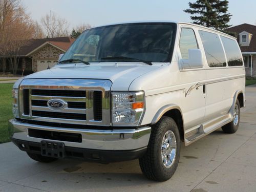

I attached a photo so you can get a idea of what it will look like. Although I choose to go with a black grill as I will be painting the rv this winter and going with a earth tone color with all black accents.

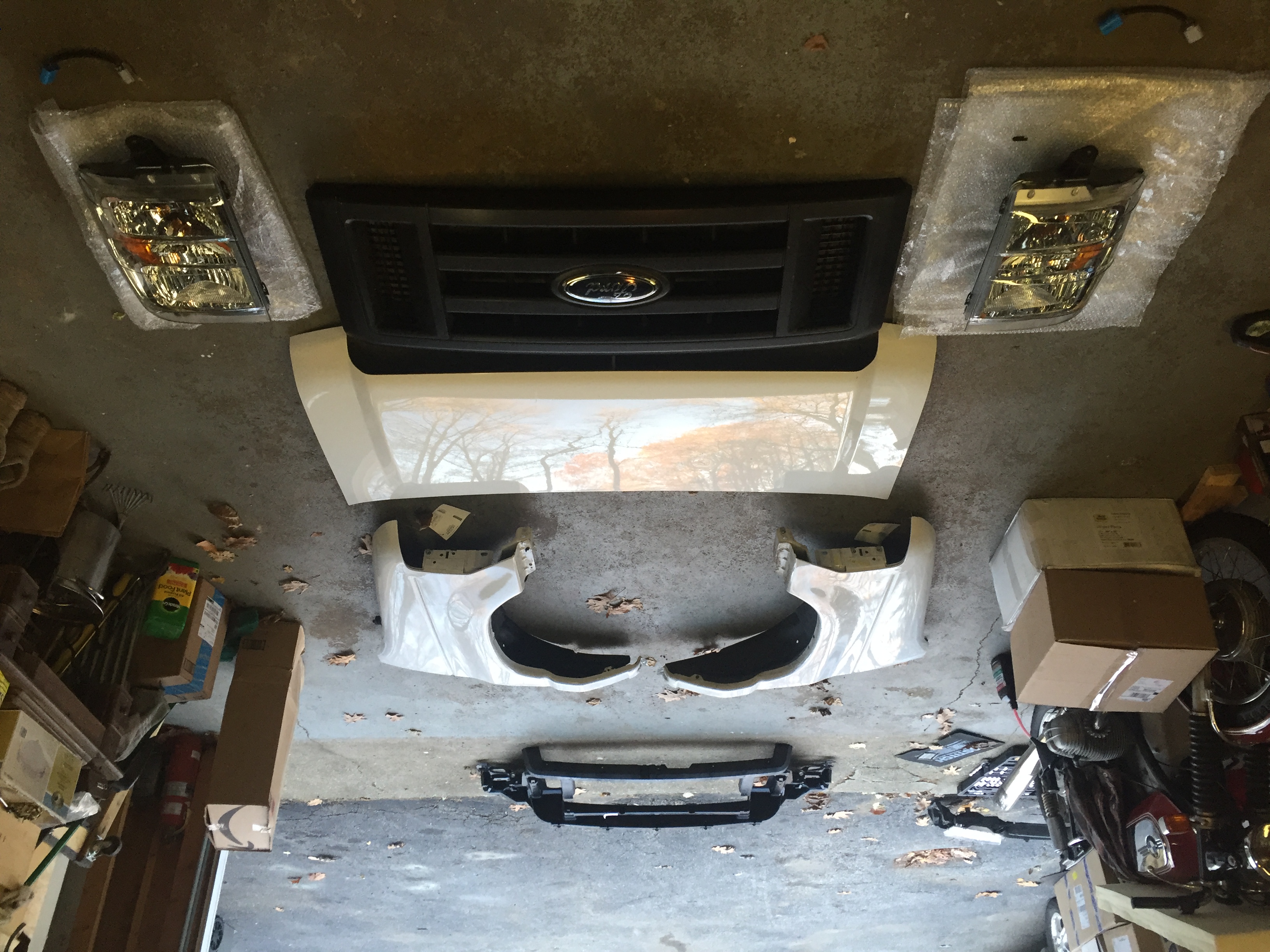

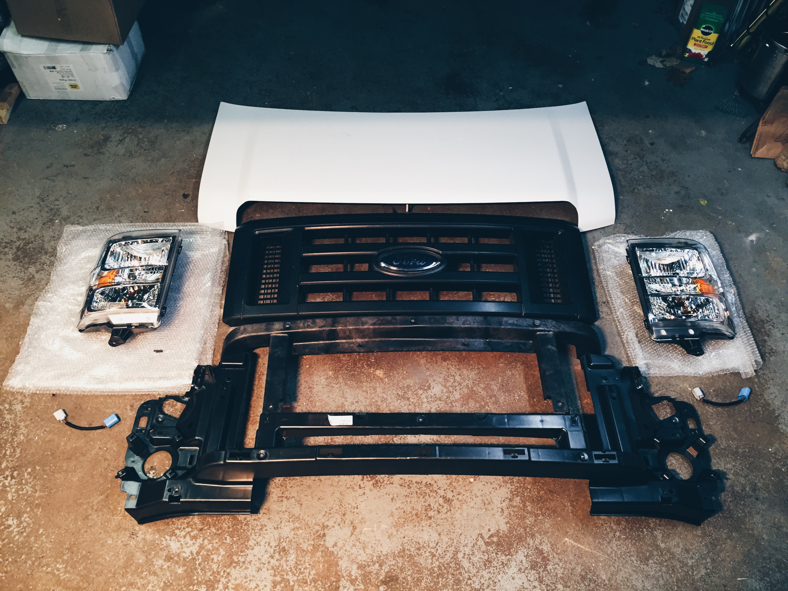

I will be starting the swap this week!!! Picking up fenders tomorrow, for now here are pictures of the headlights, 9007 to H13 adapters for the lights, upper and lower header panels.

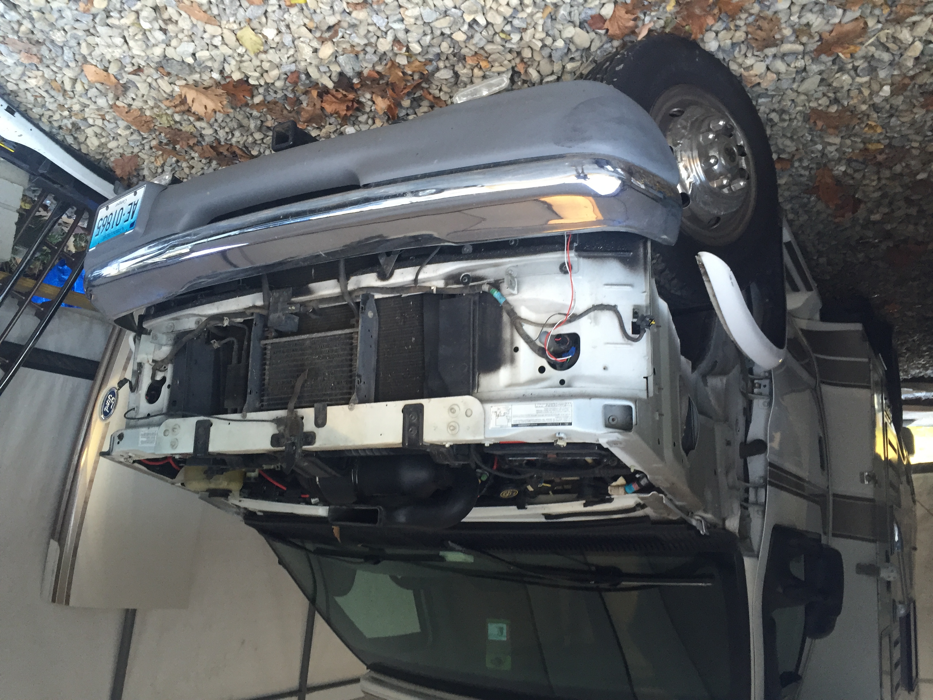

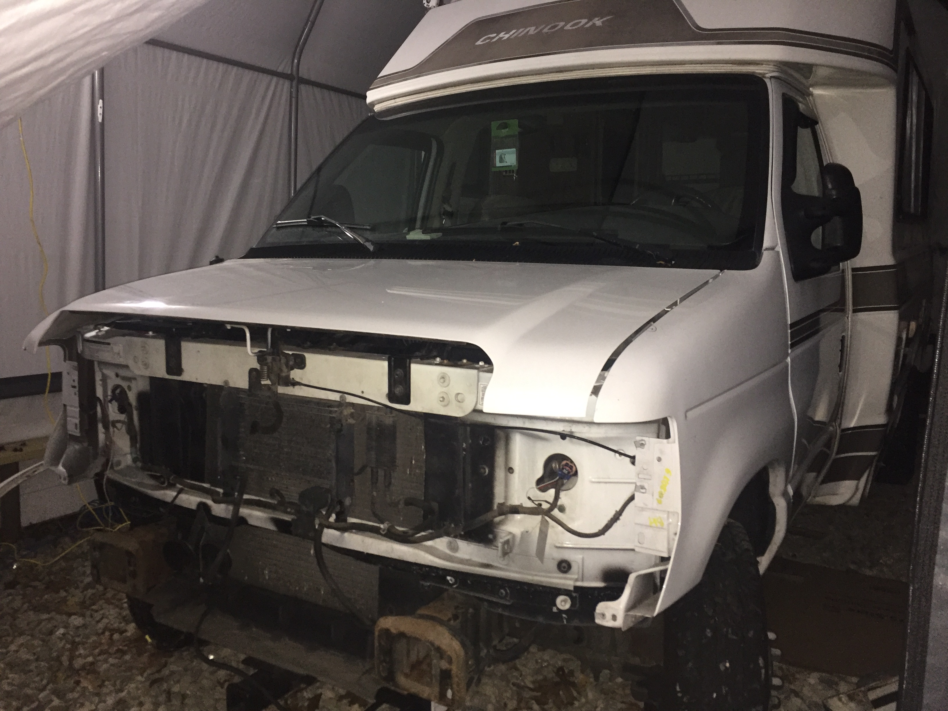

Pulled the front end apart today! Everything came apart pretty easy, had everything off (including the bumper although I took the picture prior) in roughly an hour.

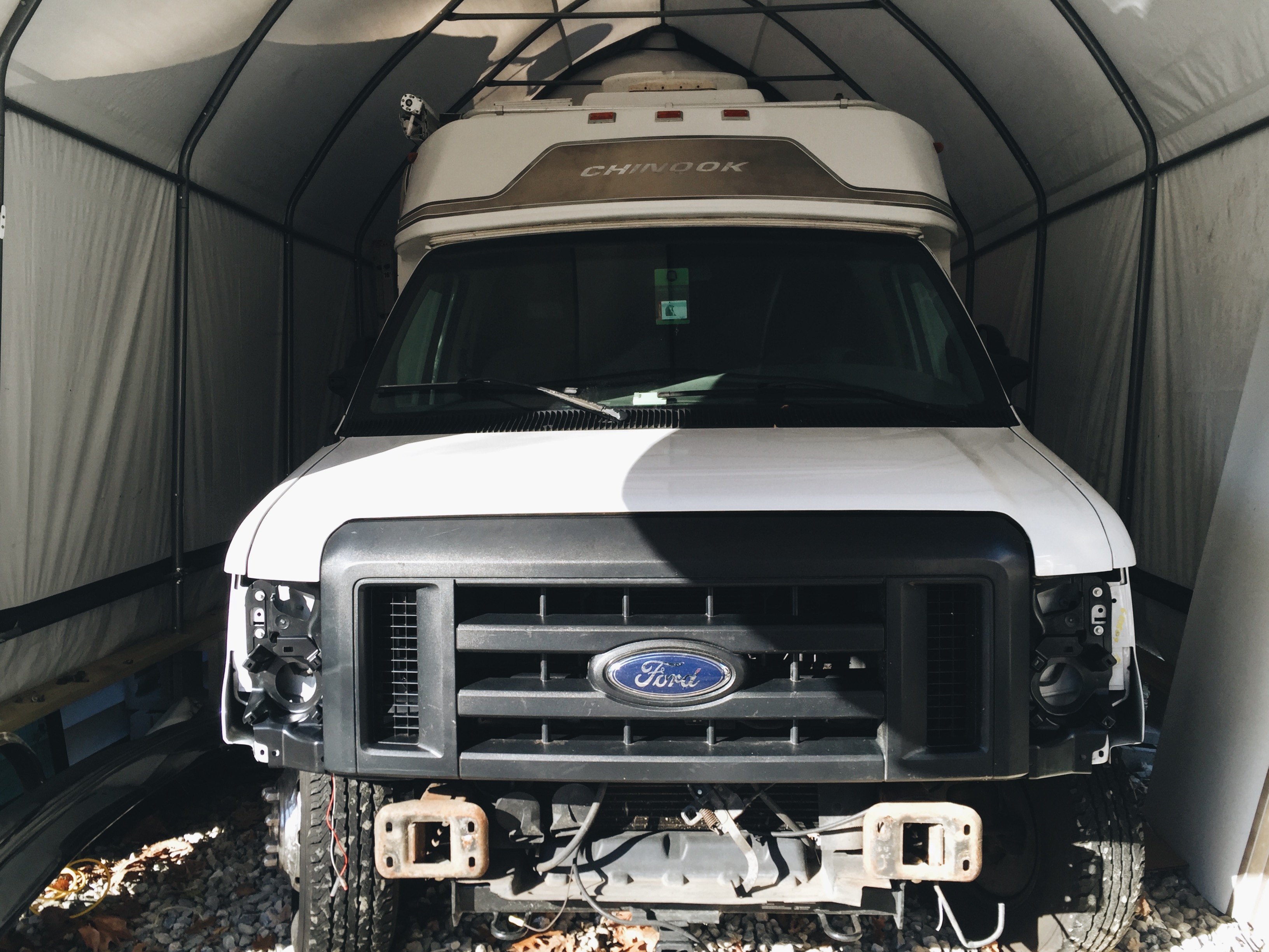

Then I scratched my head for a while trying to figure out how to put it back together haha. Figured it out but it was getting dark so I decided to clean up. Quickly mounted the hood which I had to drill out the hinges and use larger bolts then the original hood accepted. Through the fender on with one bold just to get them out of the garage. Hopefully tomorrow I'll have a few hours to work on her and get it completed!

Got the upper and lower header pannels mounted quick this morning and had to snap the grill in place to get a glimps of what she's going to look like!
