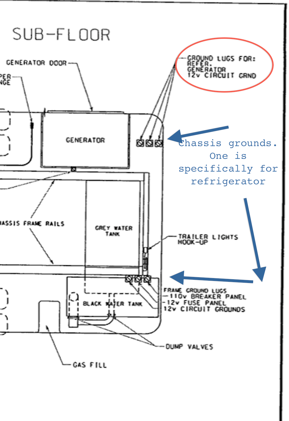

7) Never hurts to check grounds. Have you cleaned up the chassis ground for the refrigerator? It will be a screw/connector attached to the frame (go under the Chinook) back behind the generator. Here is a diagram: (There are three more on the other side for other DC functions - they can get dirty/corroded and then not make a good connection.)

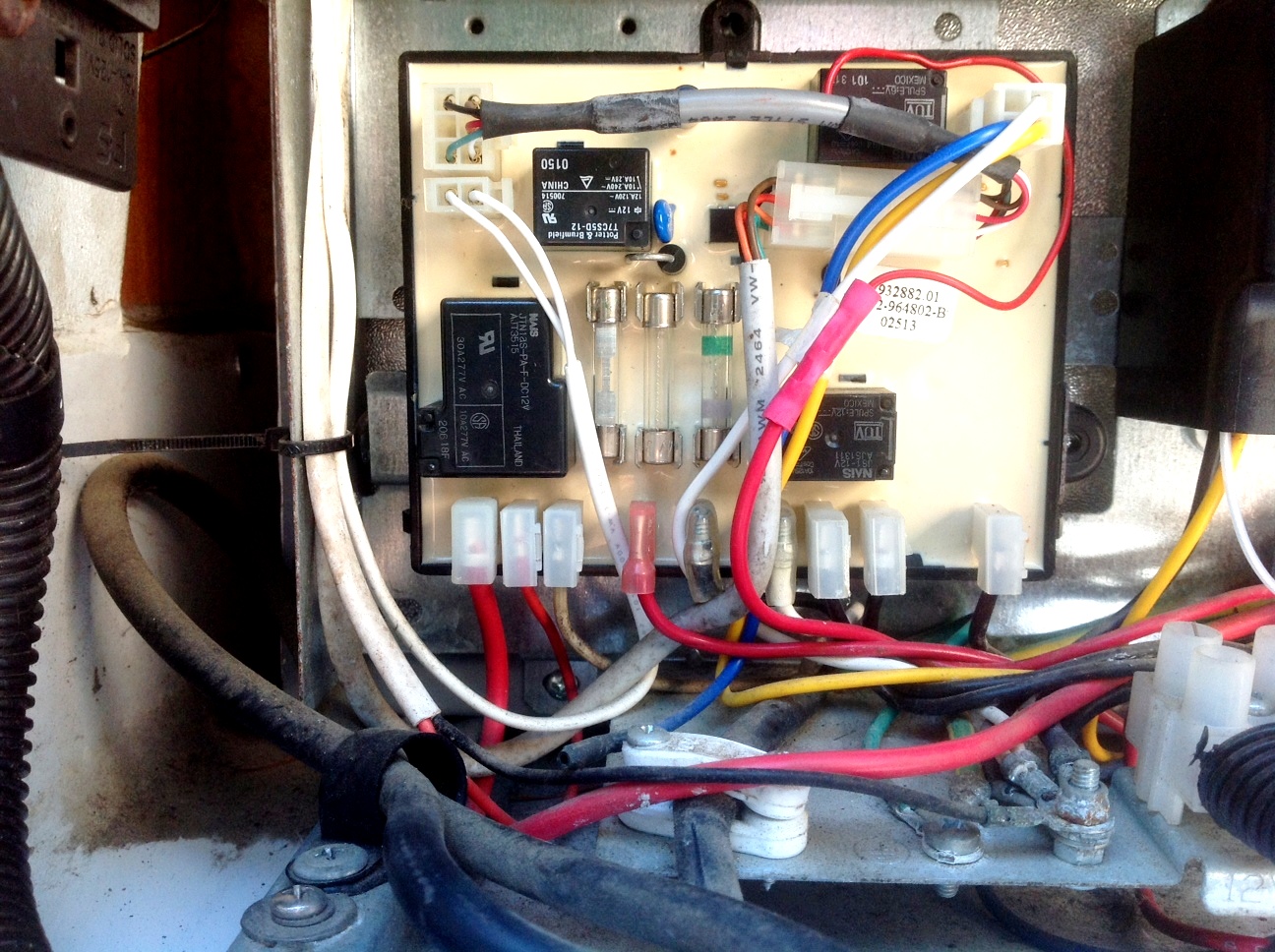

Welcome! Have you checked the fuses on the circuit board or at the house panel? My Dometic board had 3 fuses. Good luck.

I took the fridg panel off....no evidence of pilot.
Replaced one funky looking 20 fuse....nada.
