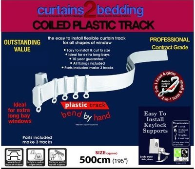

P.S. Here's what I used... $40 from Amazon for more than plenty...
196" Plastic Curtain Track, Strong, Bendable Track, Bay & Straight Windows Wall & Ceiling Mounted, Curtains & Shower Curtains Parts for 3 Tracks. | Free Extra Guide
https://www.amazon.com/dp/B00JQJJRSC/re ... mxbYVB51EN
- Amazon curtain track
Easy to install, and the track can even be removed easily from the seven or eight supports you screw in. I like how smoothly, easily and quietly the curtains slide open by hand.
