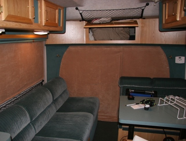

On my Premier I already have 2 snaps on each side of the TV wall (if I understand correctly) for my front privacy cover that goes up to the windshield. Adding 3 more to the bulkhead wall would be simple and attach to that. Velcro could also be an option. I'm interested in what others might have done.

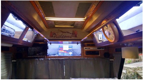

We installed 2 more of the brass hooks (like those that are already on each side) under the large overhead front cabinet, evenly spacing the hooks and putting them in line with the current two. Then we laid a length of small PVC pipe inside the hooks. The narrow pipe easily bends to accommodate the curved bulkhead and it's plenty strong enough to hold the curtains. We made two curtain panels out of acoustic fabric (like used in sound studios) and attached velcro to hold the two panels closed. The panels are heavy and not super-attractive but they completely block out light from the front, do a great job of deadening sound, and are terrific insulators. We have a 15-20 degree difference between the cab and the coach when we use the curtains during cold weather. I sewed narrow pockets across the top back of each curtain panel and threaded the pipe thru them. Removable curtain ring hooks would probably work fine too, but we leave the curtains up all the time, just pulling them back and securing them with velcro straps when they're not in use.

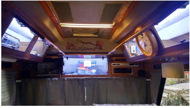

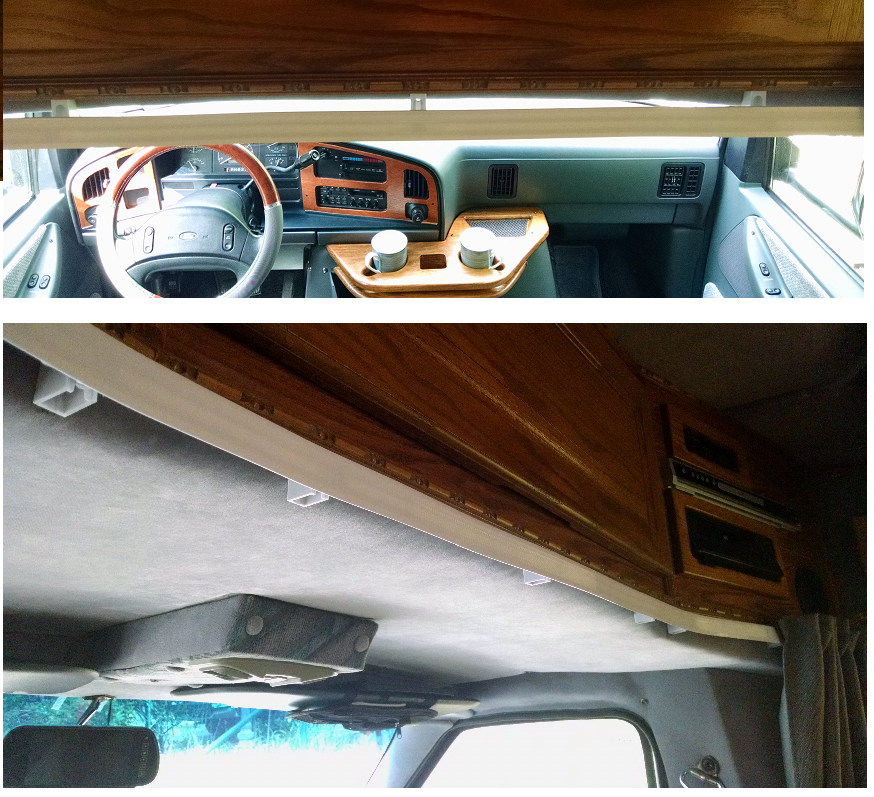

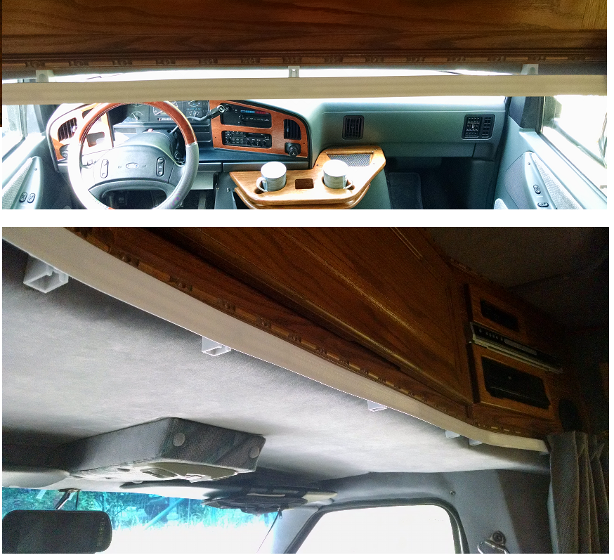

If you belong to Pinterest, my Chinook remodel board at pinterest.com/kkadarling has non-closeup shots of how ithe previous owner put in a copper pipe and shower rod holders to use with curtains straight across.
However, one night of driving with grandkids and the house lights on behind me, was enough for me to buy a flexible plastic I-beam curtain system that hugged the cockpit instead. I then took the grommet based light and thermal curtains I'd been using with the copper pipe, cut them and sewed them to use the new curved rod sliding plastic hooks.
You might recall this recent photo that shows the new curtain track in use (it's not even pulled tight here):
I stll need to add some Velcro in case I want to drive with the front windows open but keep the curtains closed tightly. So far, no need yet.
I'll try to get more detailed pics tomorrow. Kev
P.S. Here's what I used... $40 from Amazon for more than plenty...
196" Plastic Curtain Track, Strong, Bendable Track, Bay & Straight Windows Wall & Ceiling Mounted, Curtains & Shower Curtains Parts for 3 Tracks. | Free Extra Guide
https://www.amazon.com/dp/B00JQJJRSC/re ... mxbYVB51EN
Easy to install, and the track can even be removed easily from the seven or eight supports you screw in. I like how smoothly, easily and quietly the curtains slide open by hand.

Re: Privacy Curtain

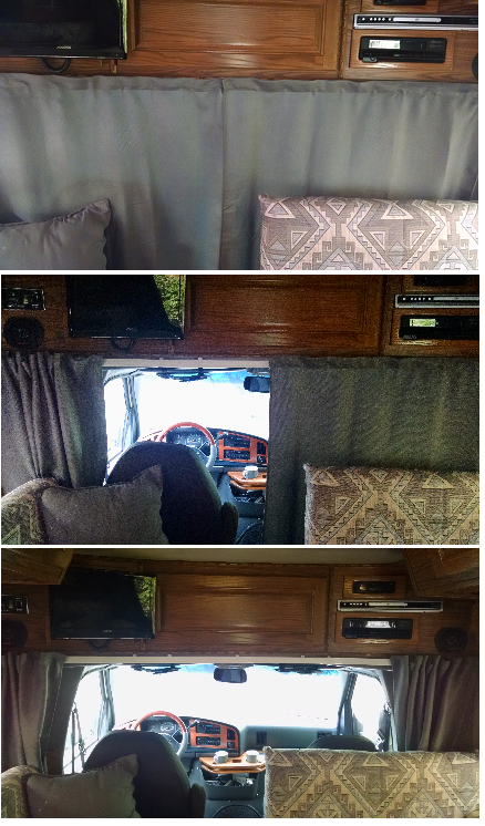

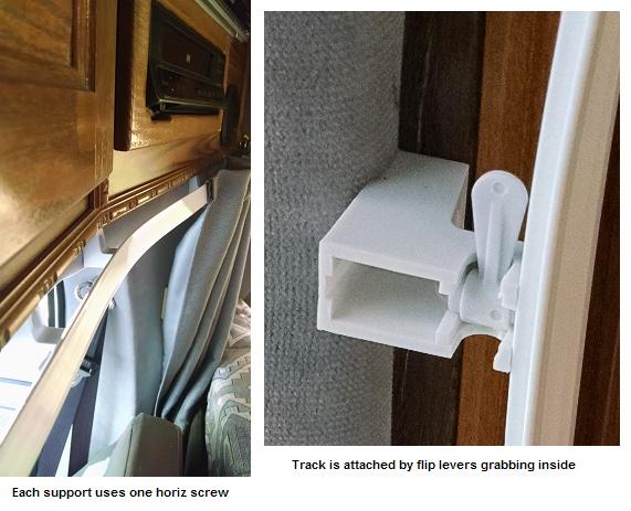

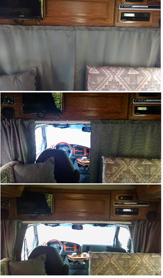

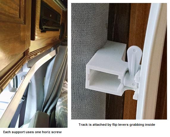

For those who don't want to have to store their curtains and put them up with Velcro, here's the pictures from my installation:
Closed, one side pulled, and both open. Even though the blackout curtains I used (from Dollar General) didn't go quite all the way across (didn't matter, because of the side buffers), I ran the track all the way from side to side anyway. This is so that when I pulled them back, they could go entirely out of the way if I wished. The curve looks like: The curved track itself is held in place by about a half dozen supports spaced to shape the track, each with a screw into the back of the cockpit edging: I attached the curtains to the slide rings (which just snap on the track) in such a way that the top of the curtains closes the gap above, and keeps it fairly light and air tight.

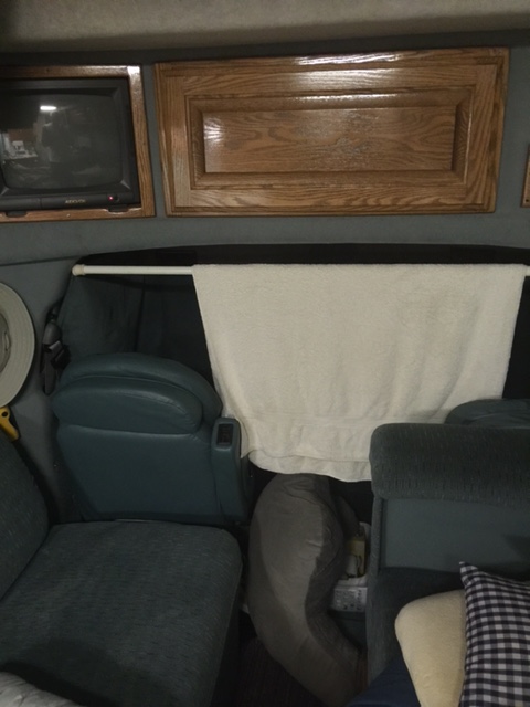

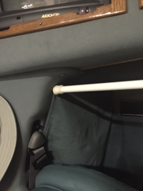

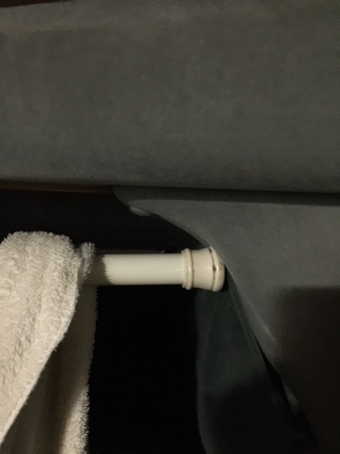

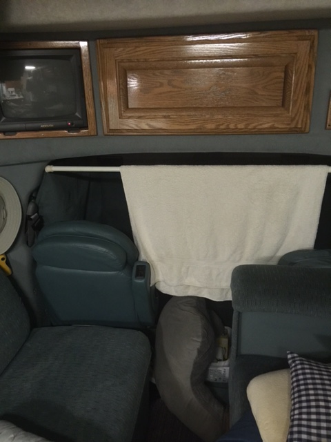

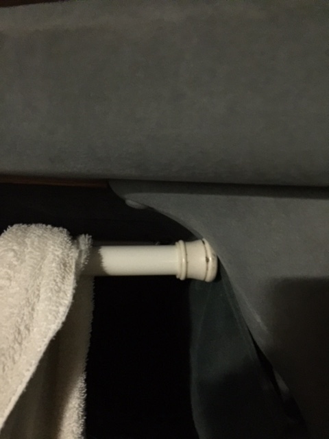

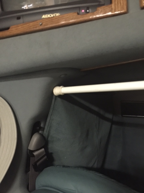

Shower curtain rod fits just fine. It's not as nice as others but it can double as a drying rod for towels/clothes. Store it behind the couch when not needed. Simple, easy, no holes and inexpensive.

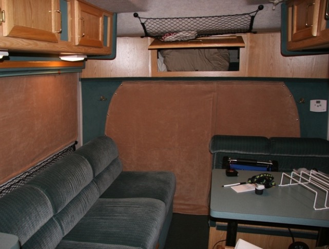

Then there's this method someone posted a while back, with snaps to keep it really warm inside!
