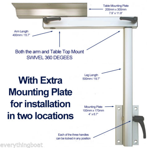

Anyone familiar with this style of table mounting system? A few videos of installs on youtube, but could only find it for sale from UK on eBay. It's similar to what Mike Norris did in his Chinook remodel for a clever "sofa/dinette mod" (two good youtube vids).

Lagun Table Mount delivered!
Took only 3 days from the UK! ("everything boat" on eBay)
High quality aluminum construction, very well made. Now to design some sort of steel plate floor bracket to mount it too. Not confident enough to mount it to the MDF dinette seat "box". Next, is to get a ROCA folding teak table top.....
The plan is to have the advantages of being able to just fold up and swivel the table out of the way, and have a "sliding slats extension" from the aft seat box to support the cushions when using the dinette as a bed, since the OEM table setup will no longer be there.

I have to admit that I'm still skeptical that what is basically a "cantilever leg support" can actually be as sturdy as the old flip-down table leg. After reading several reviews, the results seem to suggest "yes, it does". All the more reason to do a tabletop mockup.
Re: Lagun Table mod
What I can't quite picture is how you would mount it to the floor vs. to a vertical surface. That's not to say you haven't thought of a clever way though.
I'm not sure it would ever seem as "still" as a wall-mounted table, just because it can move by design (laterally). So I would only want one if I wanted/needed the swiveling type features it has (or the quick demountability)
If it's going to be mounted on a settee face, then it almost seems you'd want two settees (aka twin beds), because it slightly "ruins" one settee for a fully open couch while the table is up. I have seen them mounted to the base of a U in a U-shaped dinette, but we don't quite have that space.
Or maybe I should just ask what you have in mind for it?
