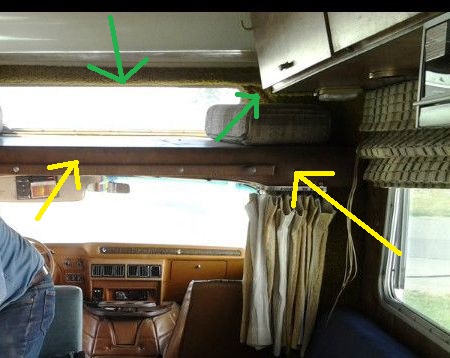

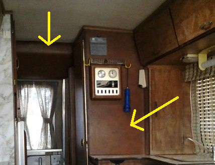

Hi everyone. We bought a new-to-us 1978 Dodge Chinook in remarkably good condition. In the next few months we want to start tackling some inside projects and I need your help!
The cabover bunk area is covered with dated brown vinyl, as well as a wall in the kitchen, and a small bulkhead area over the rear entry door. Has anyone tackled removing this vinyl and replacing it? If so, can you please let me know how you did it, problems you encountered, and how the recovering went? I'm not really sure how to go about doing this, and don't want to rip it all out until I have a general idea of what I might encounter.
Also, the front of the cabover area, and areas around the walls and windows of the cab area are covered in lime green shag carpet. This has to go--non negotiable, and will be replaced with something....anything really. I'm just not sure what. Any thoughts?
I've attached two pictures to show you what areas I'm talking about. Yellow arrows are the brown vinyl, and the green arrows show the green shag carpet.

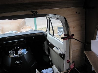

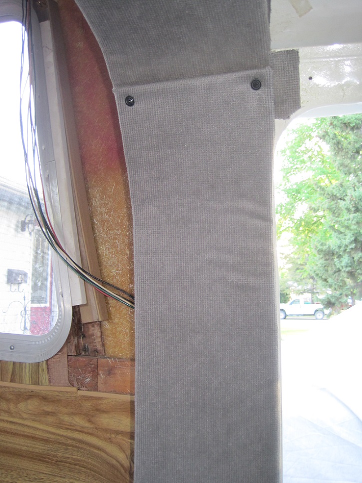

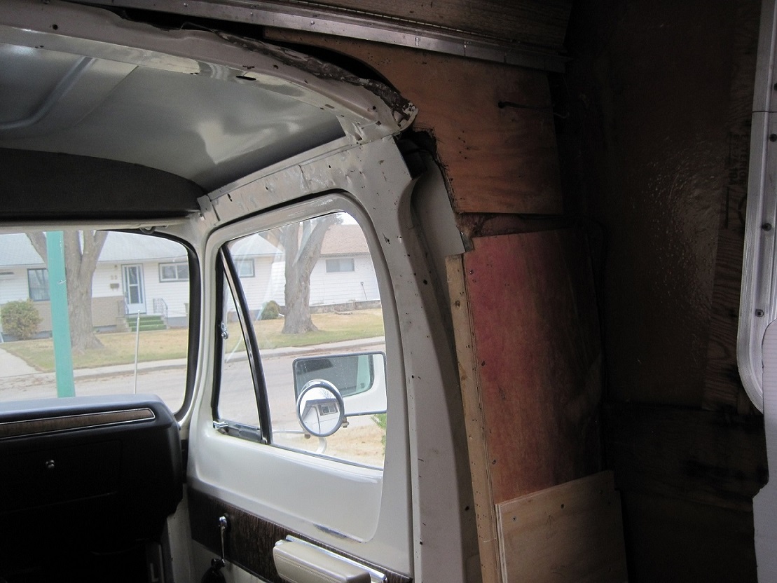

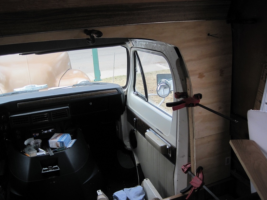

My 77 doesn't have a bunk with a window above the front but is a storage compartment with a hinged door. I'm not finished but these photos might show you what you're getting into. Not a difficult job but will require some playing around to get right. I bought some upholstery material, thin foam, and good quality spray glue from a local upholstery shop. Buy the best hi-temp glue you can- the cheaper stuff won't last and you'll end up with sagging material. Foam and upholstery material was glued onto some thin flexible board I picked up at the local Home Depot.
Re: Replacing Vinyl/Leather in cabover bunk, kitchen, and en
Continued......

Nice job !!Davecar59 wrote:I bought some upholstery material, thin foam, and good quality spray glue from a local upholstery shop. Buy the best hi-temp glue you can- the cheaper stuff won't last and you'll end up with sagging material. Foam and upholstery material was glued onto some thin flexible board I picked up at the local Home Depot.
Because I had already remodeled two bathrooms at home this way, I _almost_ went with wainscoting for my walls. Either painted or stained wood. The idea was to go for a late 1800s custom railroad passenger car look, with wood panels, velvet cushions, brass and green victorian lamps, etc.Blue~Go wrote:I still haven't decided what to do on the living room walls. They have the headliner material now, but I'm not that into upholstered wallsSo I've been considering other options. One contender is "wall liner," which is essentially a thick wallpaper that is meant to be painted. It comes in either plain or textures. Just painting the luaun wouldn't be very satisfactory, as it's very open-grained.
But in the end I stuck with the original walls, except for covering the original 1994 horizontal wall trim panels made of upholstery material, with tin and new fabric.

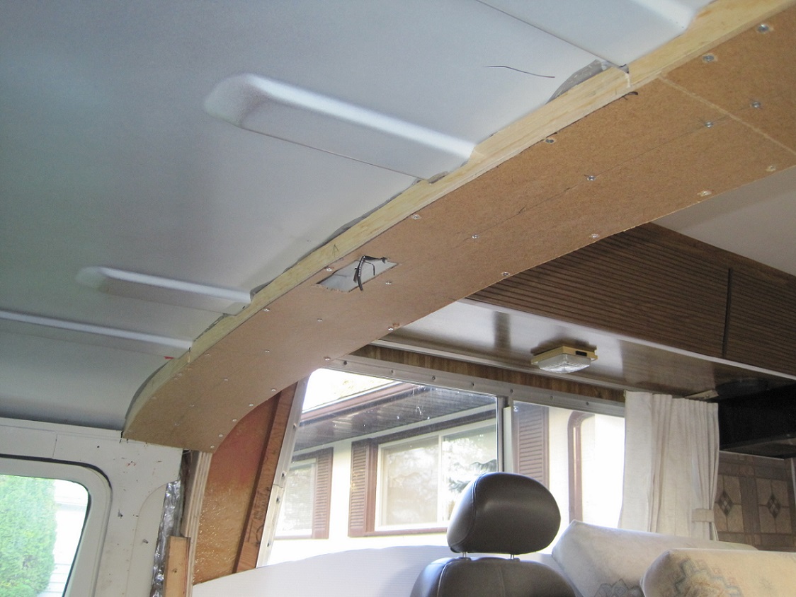

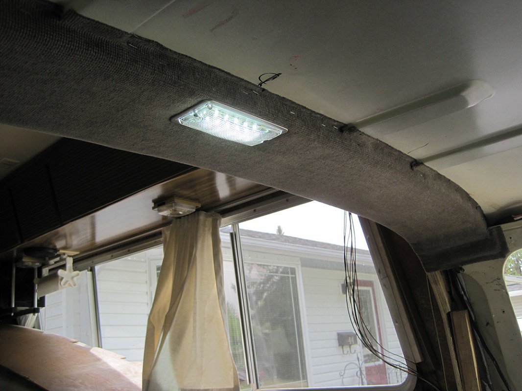

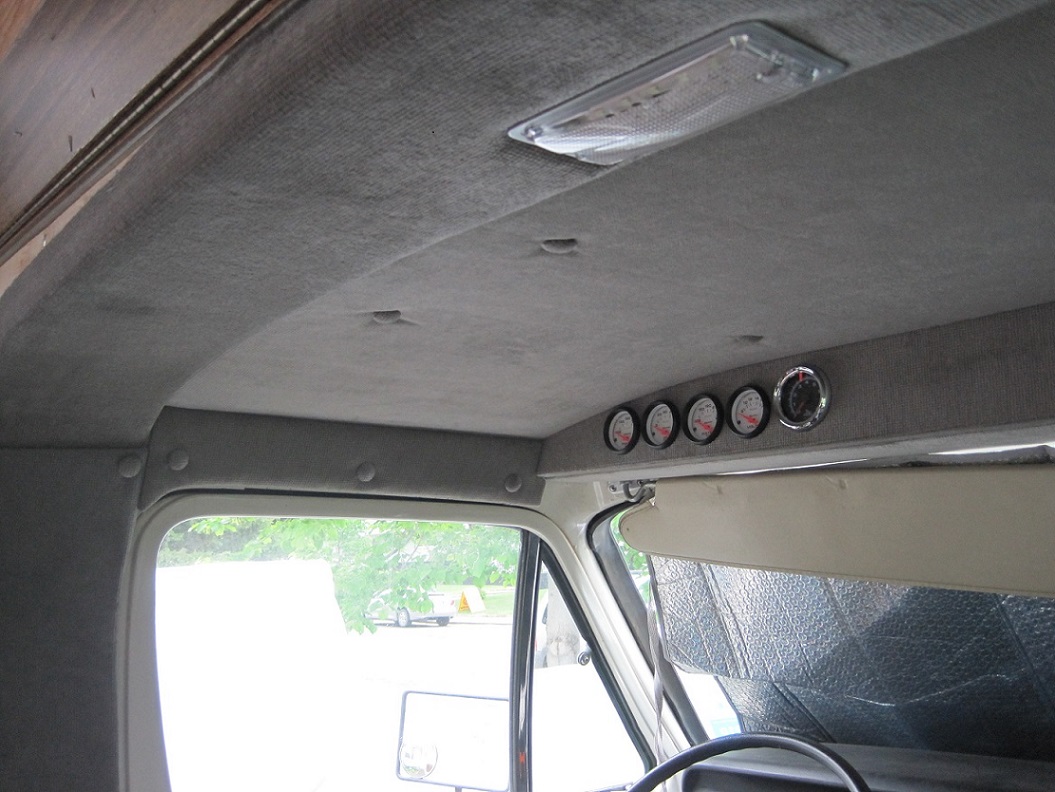

I considered some type of thin wood covering, but I thought that might make the window trim rings come up short, depth-wise. Although the foam-backed wall fabric is 1/8" - 3/16" I can see the foam is pretty much totally flattened by the trim rings. So my current thought is still the paintable wall liner paper, which would make it basically like a Premier or side-door Concourse (only they used the pre-bonded vinyl wallboard like the Concourse of my era has in the kitchen, but just throughout). Haven't decided completely yet.
Interesting on the "hatchet job" on the Dodge cab. I guess Dodge must not have supplied cutaway cab chassis models, so Chinook did it themselves? The Ford came as a cutaway, so the edges are completely finished and painted just like any other edges of Fords (like you'd see inside the doors or etc.). Actually, you can still see the tape that I presume Ford used to secure the plastic over the back cutaway opening in transit. Half of it is still on the metal of the cab back
(This is all under fabric covered, molded fiberglass panels in the '99 - one running across over the overcab storage, and two side pillars.)
But to the main point: Nice job! I'm impressed!
I had a go at "re-fabricing" the side pillars this winter (using replacement foam and high-heat-resistant spray glue) and there is definitely a learning curve. The "plain" areas were simple, but at the bottom of the pillars are some compound curves/bulges and after two tries to get it right I ran out of fabric and need to get more. I think maybe I have figured out a plan to get those areas smooth - will try again when I have more fabric... (on the other hand those areas are at the very bottom facing the sides of the driver/passenger seats, so I guess a little wrinkle wouldn't hurt, but darnit, Chinook got it smooth so I want to figure out the trick).
