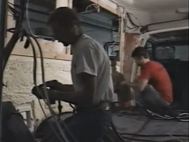

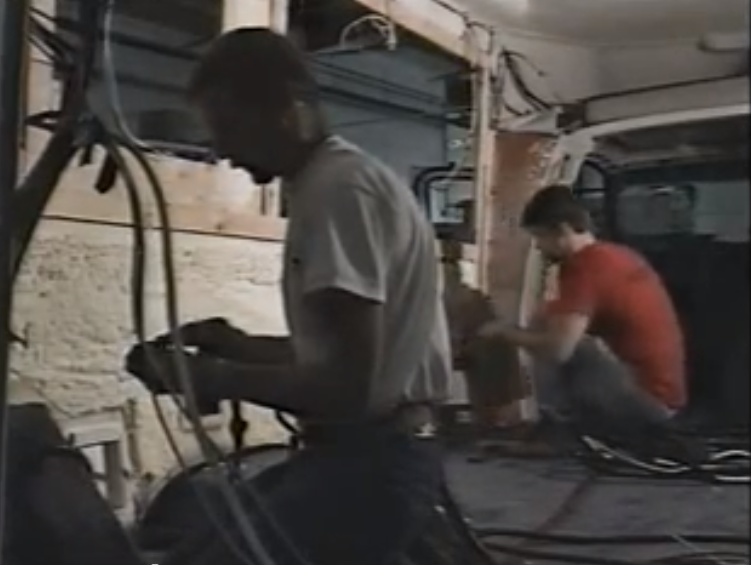

I had assumed the the Premier was similar, but another forum member recently re-did his windows and we discovered that instead of largish areas of plywood around the windows, it's more like a perimeter frame of flat-laid 1 x 3 (or similar) pine-ish boards. I have a really bad photo that shows it, and I will include that here for comparison.

Driver's side wall, Premier, circa 1998 (sorry for the very poor quality but it shows the difference from a Concourse wall):
