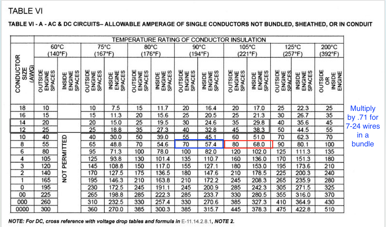

Okay so just a bit more data on the 8AWG and a 40 amp fuse. You can do that and stay within ampacity. I'll show my work.
1) ABYC ampacity chart.
Here you can see that with 105ºC rated wire (my Chinook had this), and not in an engine space, 8AWG has an ampacity of 80 amps. But we have to do more calculating.
2) A good rule of thumb to build in some safety factor, is to go down to the 90ºC rating. That's 70 amps.
3) Now there is a bundling factor (heat related). For 7-24 wires in a bundle, you have to multiply the ampacity rating by .71 The refrigerator wire goes across the Chinook in a gigantic tight bundle of wires so .71 X 70 = 49.7
Hence I would feel okay about a 40 amp fuse on that circuit. But just not an ATC fuse, and especially not in a 20-amp rated fuse block. Hence I would go with something like a Maxi fuse in a block (see Blue Sea 5006100 or 5068 and Blue Sea 5139) or a Midi fuse in a block (see Blue Sea 7720 and Blue Sea 5251).
