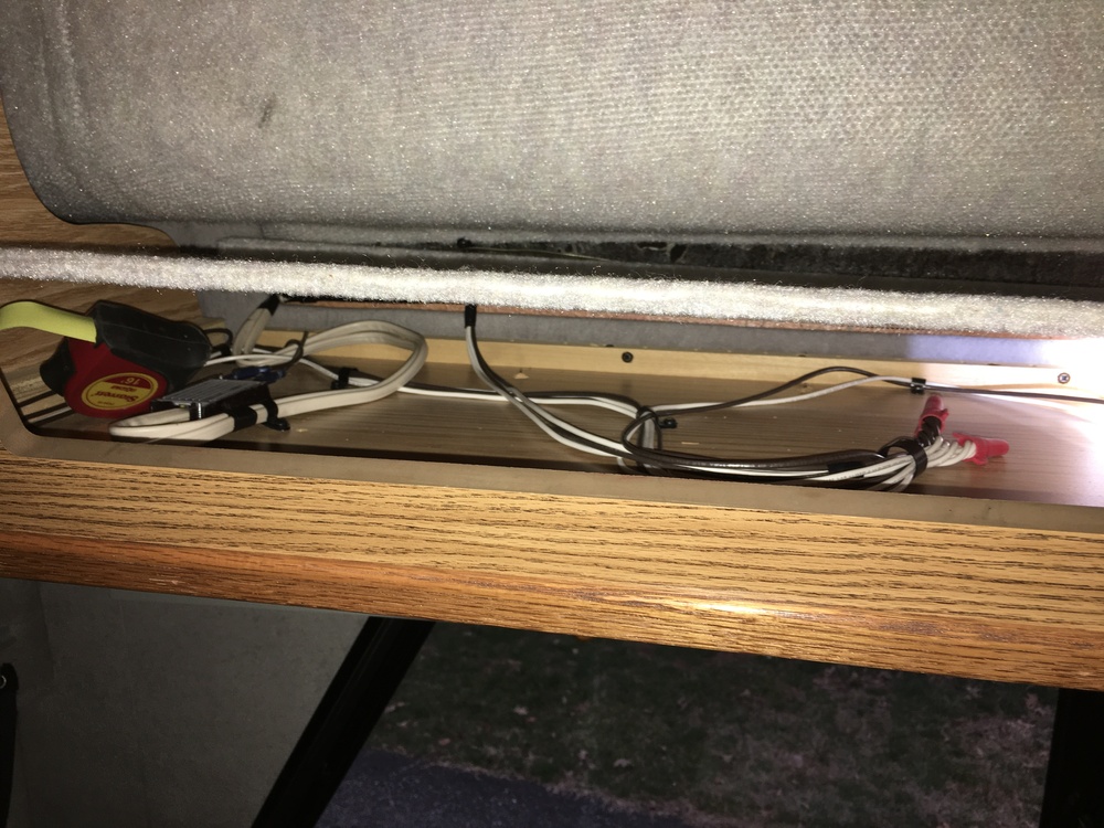

No fabric cutting is required to access the outlets. Below are general instructions, along with some photos from my Concourse (only 4 per post, so the last 3 are in a second post after this one).
1) Empty the overhead compartment.
2) Unscrew the wood dividers and remove them.
3) unscrew the carpeted floor (there are flat white head phillips screws that almost match my carpet).
4) unscrew and remove the 2 end pieces (one covers the entire end, while the other just has a shape following the ceiling).
5) unscrew and remove the long slender back piece. You'll find cabling back there running along the wall.
6) now you can finally lift up the near end of the carpeted floor and brace it open. There is no way to remove it, it is just one large solid piece.
7) I included a photo of the back of the outlets used in mine. I've never done anything with them, but it appears kind of solid to me - maybe the middle which is sagging for you clips in place? or the screws are dark or too small to see in my slightly blurry photo (it is a crop of a larger photo, the lens was not focusing on the outlet).
