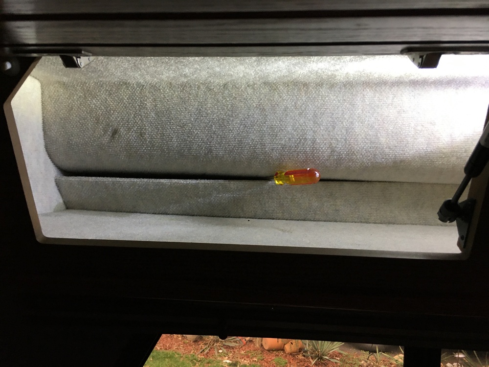

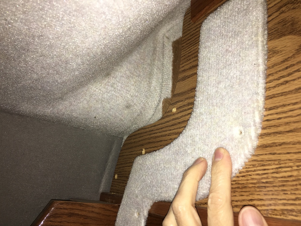

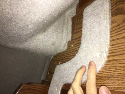

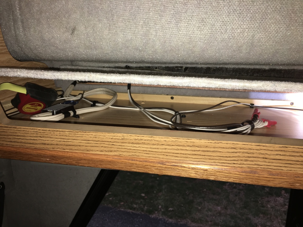

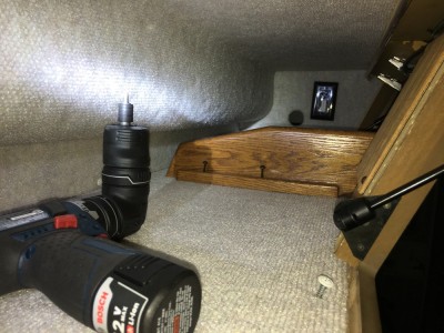

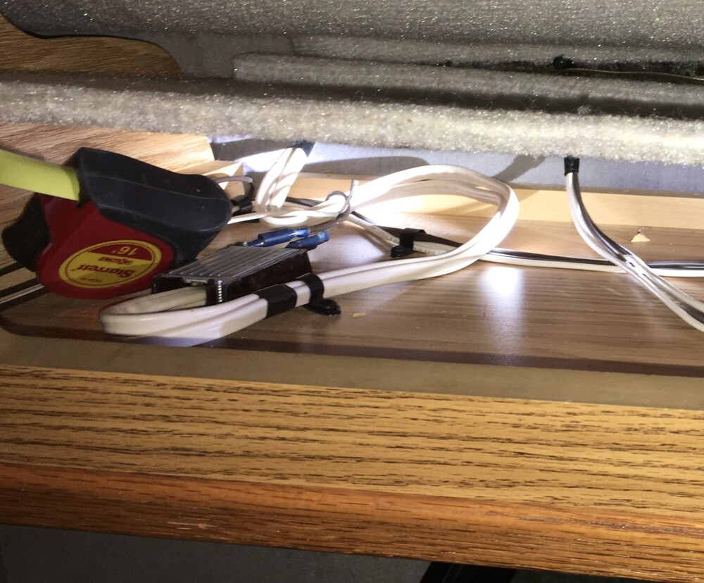

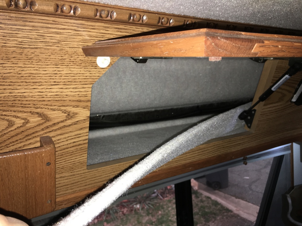

No fabric cutting is required to access the outlets. Below are general instructions, along with some photos from my Concourse (only 4 per post, so the last 3 are in a second post after this one).
1) Empty the overhead compartment.
2) Unscrew the wood dividers and remove them.
3) unscrew the carpeted floor (there are flat white head phillips screws that almost match my carpet).
4) unscrew and remove the 2 end pieces (one covers the entire end, while the other just has a shape following the ceiling).
5) unscrew and remove the long slender back piece. You'll find cabling back there running along the wall.
6) now you can finally lift up the near end of the carpeted floor and brace it open. There is no way to remove it, it is just one large solid piece.
7) I included a photo of the back of the outlets used in mine. I've never done anything with them, but it appears kind of solid to me - maybe the middle which is sagging for you clips in place? or the screws are dark or too small to see in my slightly blurry photo (it is a crop of a larger photo, the lens was not focusing on the outlet).
BobW9
Posts: 263
Re: 2000 Chinook Premier Loose Outlet
Post by BobW9 »

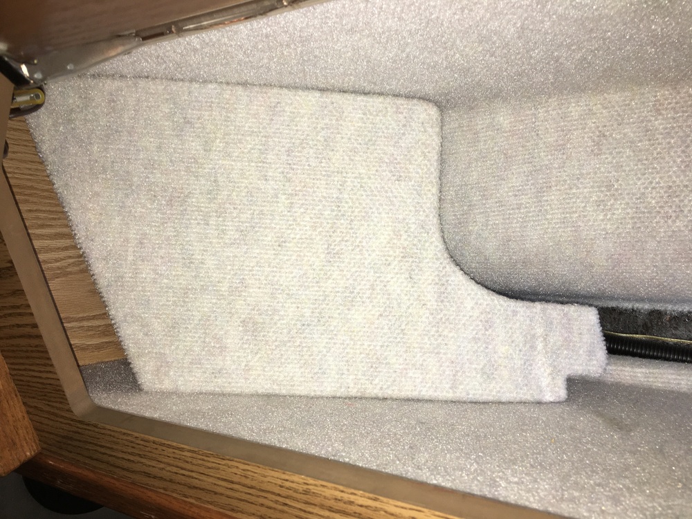

Here's the last 3 photos.

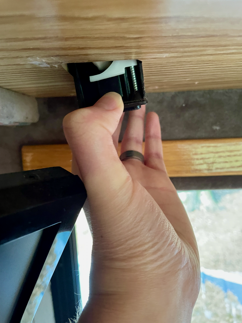

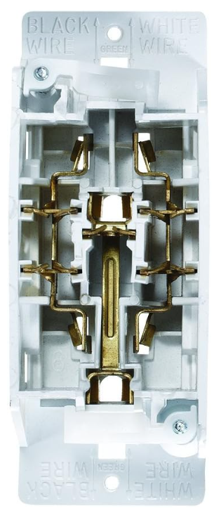

In this pic you'll see a rotating clip at the upper left and lower right. These hold the outlet in place. From the OP's pic, it looks like one of those has broken or maybe the screw came out.
In these panel-mount RV-type outlets, the box and receptacle are one unit. The solid core wires go into the "vampire" terminals with a press fit, and the back cover snaps on. The whole scheme is a bit sketchy if you ask me, but it was the standard.

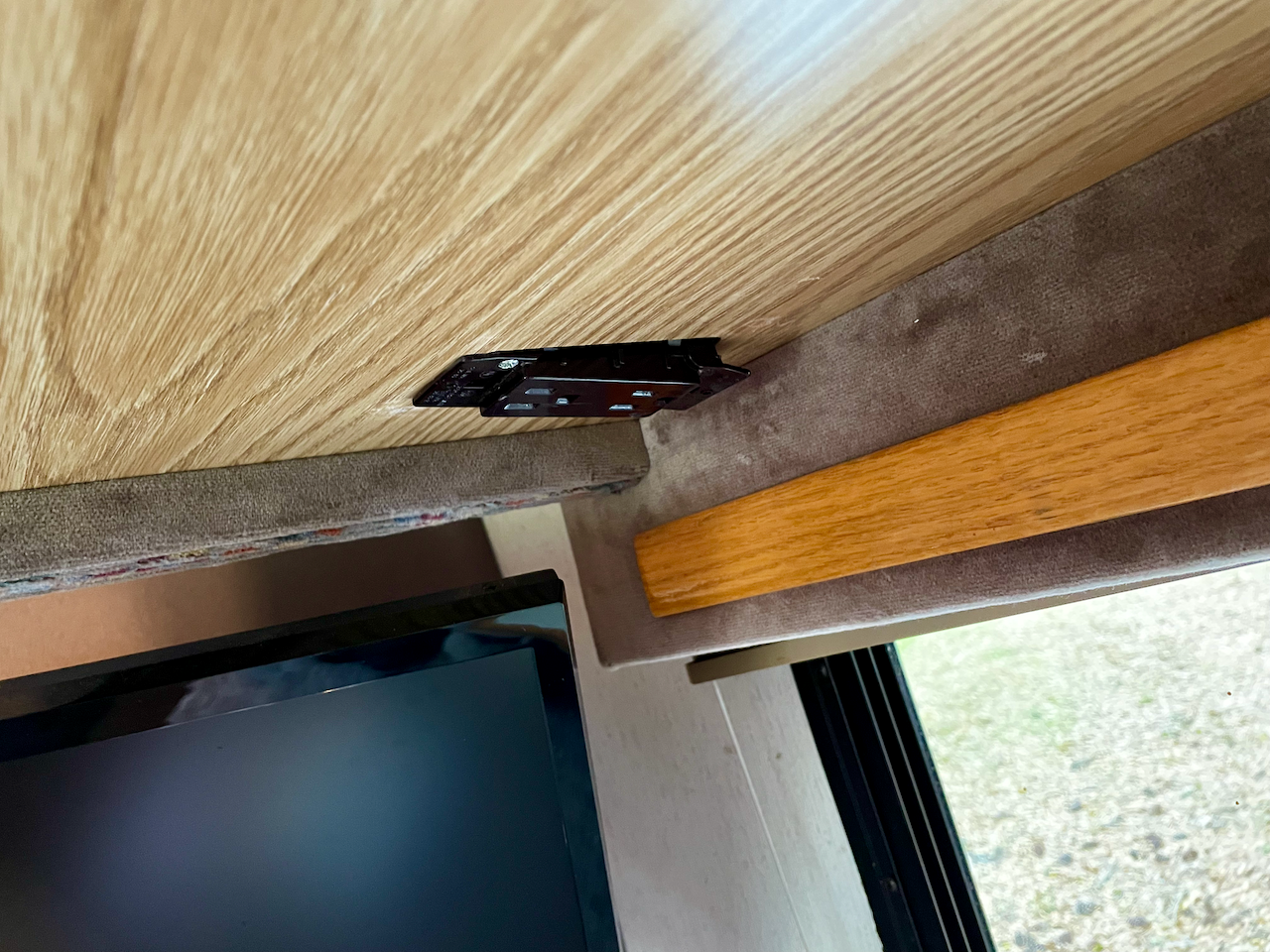

orionsauter
Posts: 2
Joined: February 23rd, 2024, 1:03 pm
Post by orionsauter »
Finally got around to looking at this more – Thanks everyone for your suggestions! Scott had the key point: Those arms that swing out were not catching the ledge. Turning the screws to the left swings the arms in to remove the outlet, but if you keep turning, it also adjusts the arms to leave a wider gap. Similarly, if you turn the screws to the right, but the gap isn't big enough, the arms will hit the wall and the gap will get smaller. The method for getting the plug secure then is, turn left until you're confident the gap is big enough, then hold the plug in place and turn right until the arms grip the ledge. The picture attached will show what I mean (I hope). Thanks again!
