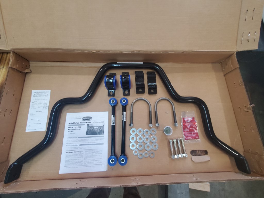

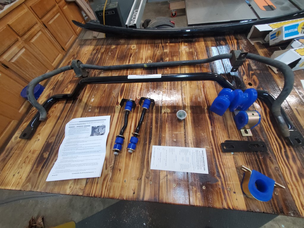

The biggest issue we found was the handling. It handled horribly. Almost to the point of regretting my decision to purchase it. After a close inspection I discovered the front sway bar bushings were shot and almost non existent. The shocks were also worn out. I did confirm the steering linkages and other components were fairly new and in good shape.
I decided to bite the bullet and replace the front sway bar along with installing a rear sway bar and all new shocks.

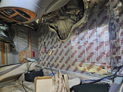

While waiting for parts to arrive I removed the crappy and poorly installed security system. I also pulled out a bunch of other unused wires a previous owner had installed. While at it I also pulled all of the old cable tv stuff out. I ended up with a 5 gallon bucket full of wiring and electrical components. I actually got about $5 for it at the scrap yard. Since doing all that work I have not had any electrical issues on the camper. (I had a photo of the wiring I pulled out but don’t can’t find it now)

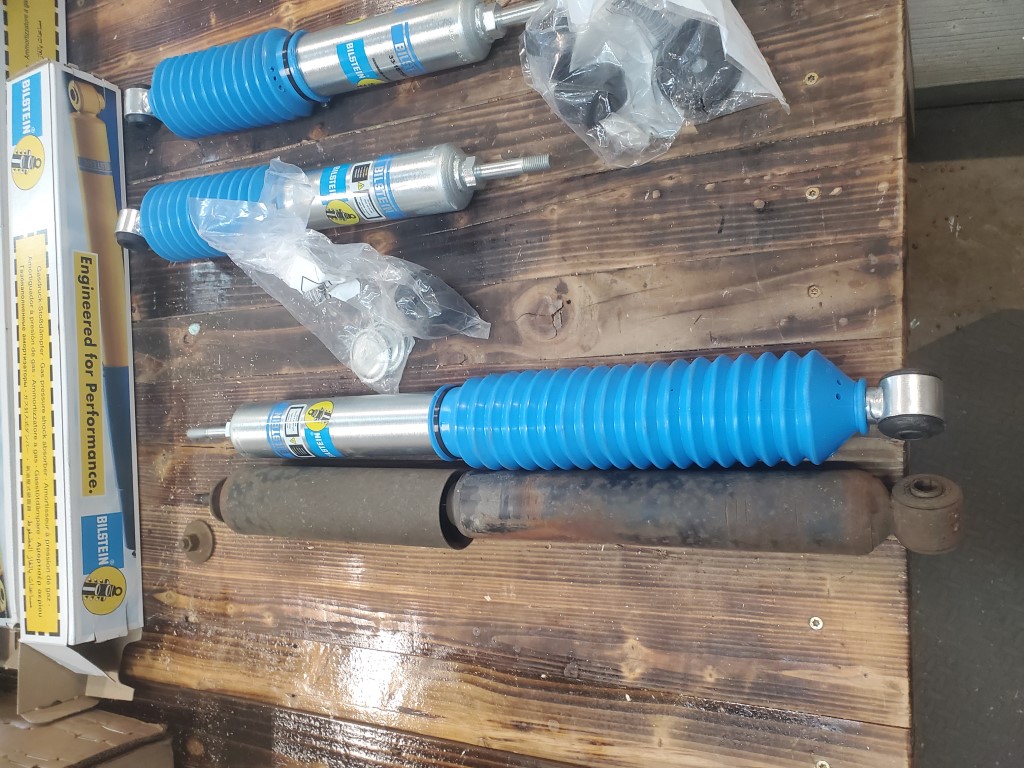

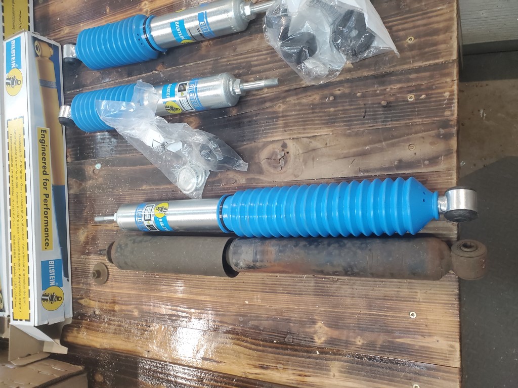

I have worked on Econoline vans before but somehow forgot how cramped they are (thinking back I may have blacked it out of my memory). Due to poor access to the top of the shock tower and rusted bolts (and lack of patience) I ended up carefully cutting the front shocks off with a torch.
Old shock compared to new shock.
One of the old front shocks was completely shot and had no pressure behind it. The other front shock still had some resistance. Here you can see the old front sway bar next to the new one. Note it is significantly beefier Here is the rear sway bar. After installing everything, I took the camper out on some local roads and it felt much better. Still a little bit of floating feeling in the steering but I think I just need to tighten up the power steering box. The tires on the camper are wider than the stock tires and rub on the front sway bar at full turn. Not sure if I am going to leave it or put on a spacer.

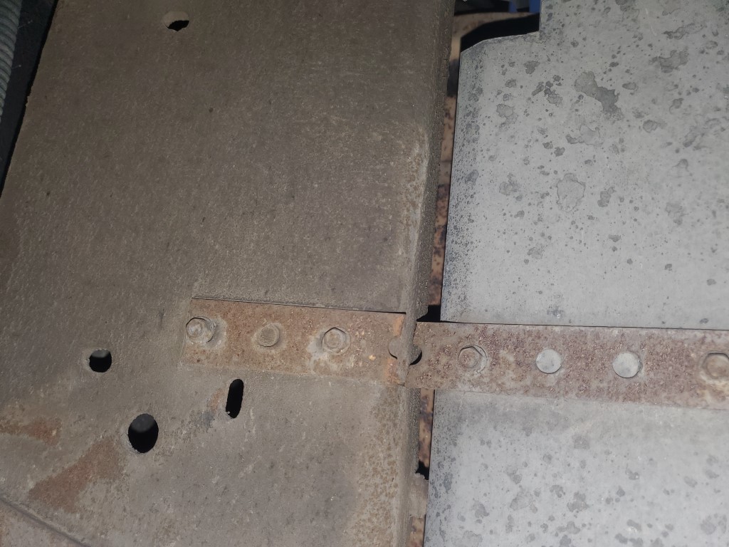

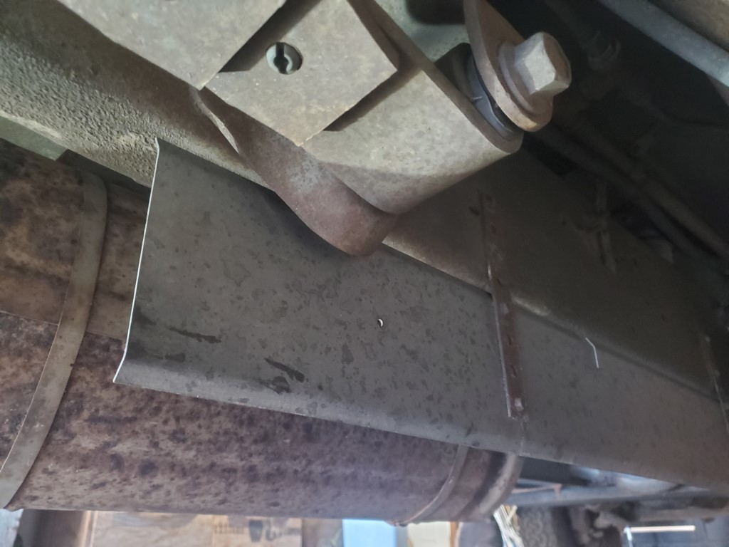

Also while crawling around under the camper I found the source of a really annoying rattle. Sounded a lot like a cymbal. The metal strap connecting the heat shield to the truck had sheered in half. This is between the exhaust and propane tank on the passenger side.
So I took it off and welded it back together. I carefully went through the rest of the chassis looking for any other loose things but didn’t find anything else loose. But I did find some more questionable wiring...
