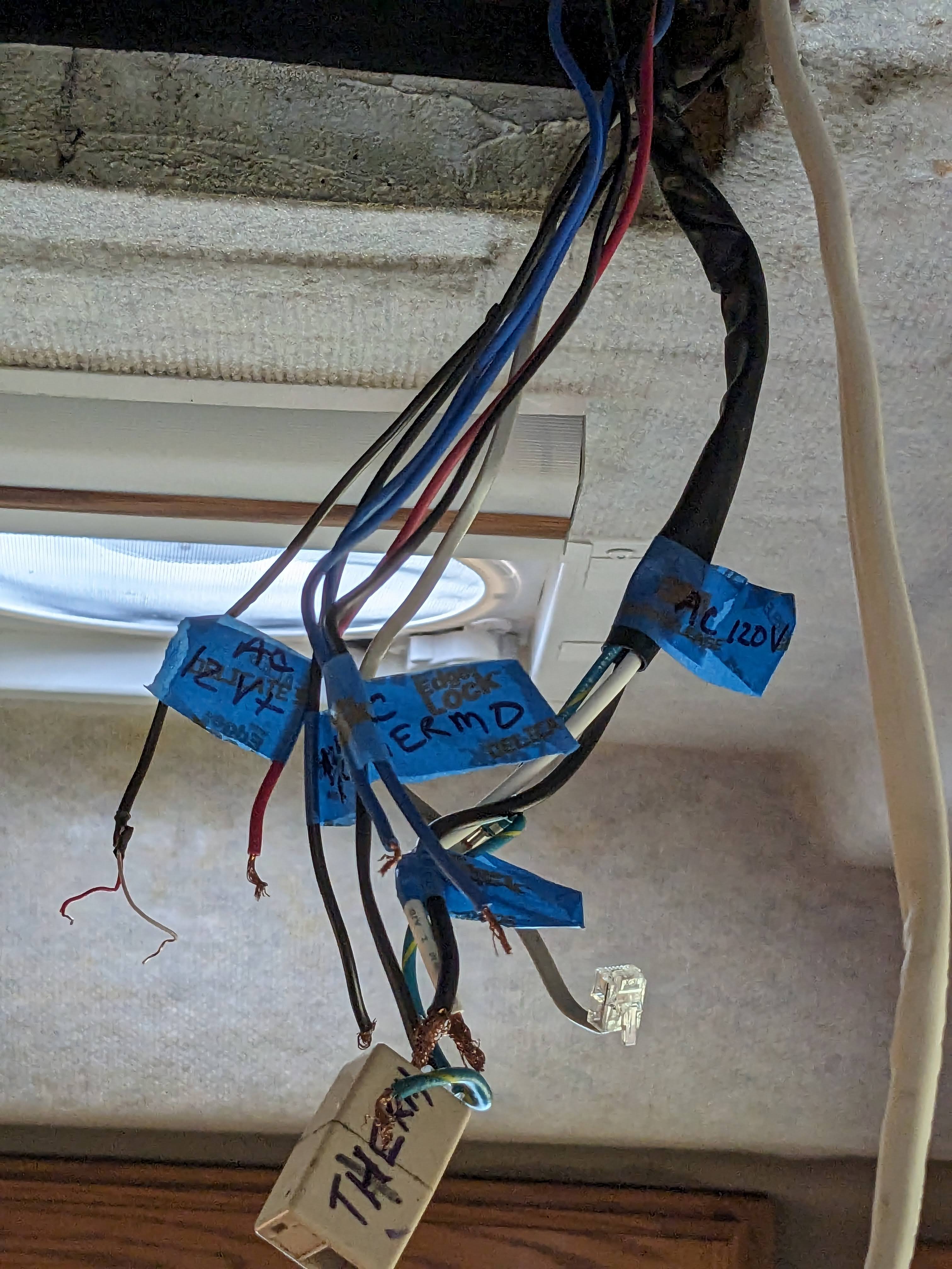

I've pretty much come to the same conclusion. Fortunately, I took pix before I dewired the old Dometic. Along with the phone type cable were several other individual wires. Two blue and a red and black which I labeled (see pic). After watching a boatload of You Tube vids on installing, upgrading and fixing Dometic RV heating and cooling systems, I'm pretty sure the red and black wires are DC power to the furnace and the two blue wires are for the thermo stat. So, as you mentioned, I'm going to reconnect the power wires to the DC source that they had been connected to in the ceiling. I'm going to strip and use 2 of the wires in the phone cable to get to my new wall mount, heat only thermo. I will then power on and see what happens.

OK, got it sorted. Here's the skivvy. If you look at the pic I posted previously you'll see a cable with 2 small wires (red and white). The pic makes it look like those wires are labeled 12 V+, but that is actually on the large red wire in front of that cable. Anyway, it turns out that these are actually the thermostat wires for the furnace. I confirmed this by holding the two wire conductors together. The furnace started to cycle! These wires had been connected to 2 blue wires coming out of the Dometic control board. (similar to what you were saying Blewett).
