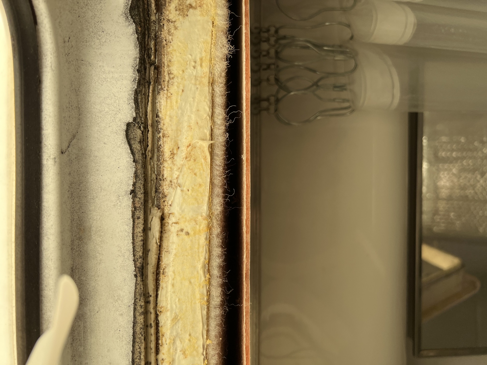

Oh, and I believe the outer fiberglass shell is 1/8" thick (maybe 3/16", but I think 1/8" is standard). Then it has foam core in some places and the plywood in others, followed by the inner fiberglass shell, which I think is either 1/16" or 1/8" thick. I removed the cover for my bathroom fan in the picture below. You can see the shower fiberglass shell, a small gap, then the roof. It is kind of hard to see in the picture (click on it to see it larger and in correct orientation), but the bottom where the carpet is has what looks to me to be 1/16" fiberglass, then 1" white hard foam core, then 1/8" fiberglass. I opened up the main coach fan vent also, but the shell comes down too far and covers everything - about all I could tell is that it looks to also be 1" foam core with the same thickness fiberglass, but I could only barely see it.
