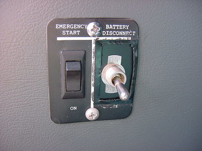

Hi, I need to find a pre 1997 Chinook Concourse owner, preferably 1995. I need to get some information off of your battery disconnect switch. I am trying to find a switch for mine. Hopefully you could find the manufacturer of the switch, and a part number. You would have to take the switch cover plate loose fro the dash, but mine only has two screws attaching it to the dash.
Any help would be appreciated.
Alan in Ohio

Okay, sorry, but me again with the '99. Just in case you don't find another person with that year Chinook (or in the meantime). That looks like a fairly common switch brand. Like maybe a Carling? Most parts like these are made by common manufacturers. Is there any info on the other (non-lighted) switch that you do still have? If so, you'd have the brand and could perhaps find a lighted one. Here are a few links that might help. I think these would be called "rocker switches." They should be 12-volt type. Another option would be to get two new switches of the same size, that match and fit the hole. There are some fairly standard sizes. Actually, looking at the "good" switch panel in your first photo, the lighted/red rocker switch is not even the same style (exactly) as the non-lighted one. They are just both the same "standard size" and basic type.

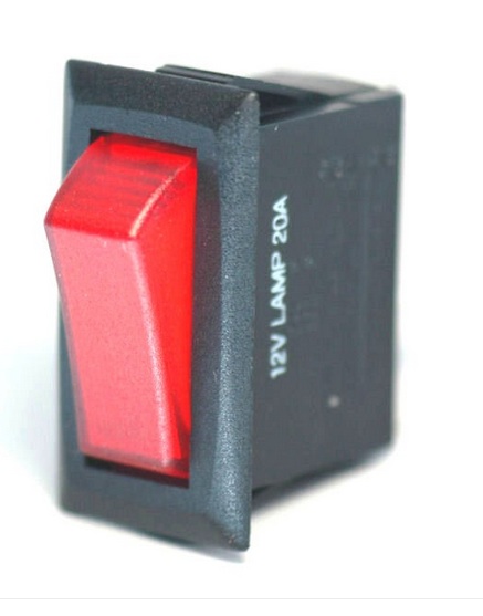

I can't measure yours, of course, but just going by eye here is one possibility from the links above. Presuming it's the correct size (they are usually somewhat standard), it would snap in to your opening (although it looks like your opening is a bit cut up - but then maybe you are going to make a new panel out of black ABS or something? Or just a slight "cover panel" for that one switch area):
K-four:
http://www.k4switches.com/switches-12/i ... witch.html
Pardon me if I'm giving you more info than you wanted (and not from a pre-'97 rig); but I just was thinking that when I first started doing this sort of thing, I didn't really realize that most of this type of part came from "suppliers" and were not really unique to the vehicle. (Of course there ARE custom parts, but not typically this sort of thing - maybe the switch panel backing was, for example.)

Thanks BG, I checked my emergency start switch and it was manufactured by "Arrow England", I looked at their website and they have several red lighted rocker switches, but I was hoping that if I could find the part number I could maybe get the right switch. I had previously corresponded with "Kevin Darling" who had the same switch setup as mine, so I have been trying to contact him. He was the one who sent me the front and back pictures of his switches, but his wiring had been replaced and was all red wires. By the way I finally got my emergency start switch hooked up, and it activates the solenoid, but haven't figured out how to check if it is doing anything other than clicking the solenoid.

Is it anything other than a single pole, single throw on/off switch? On my rig there is a little additional circuit, because there is a light and buzzer that tell you to "turn this switch on, dummy" if the generator is on and the switch is off (because in my rig if the switch is not on the generator charging will not get to the house bank). I don't see anything like that on yours though (do you?), so I would think it is just a simple on/off switch (lighted). It must be controlling a relay of some sort, because you would need a really heavy duty switch to "actually" turn the house bank on and off (like the Blue Sea Marine switch I showed, which is in a whole 'nother league from a little rocker switch).
So if it's just turning on/off, then the switch I showed (or similar) should be fine. It's rated for 20 amps, and I wouldn't think you would have anything like that running through it since it is clearly not directly switching the big battery cables (which is what the Blue Sea type switch would be doing).

You're probably right about the switch, maybe I'm trying to make it more complicated than it has to be. I had ordered and received a red lighted rocker switch and received it. It has 3 posts, now I just need to figure out what wires need to be connected to it, and on which posts. I'll have to do some more checking but if I remember correctly I have a loose yellow wire that goes to the positive post of the house battery, an orange wire which goes to the other solenoid as purple, and maybe a white ground wire. Like I said, I need to check again.
