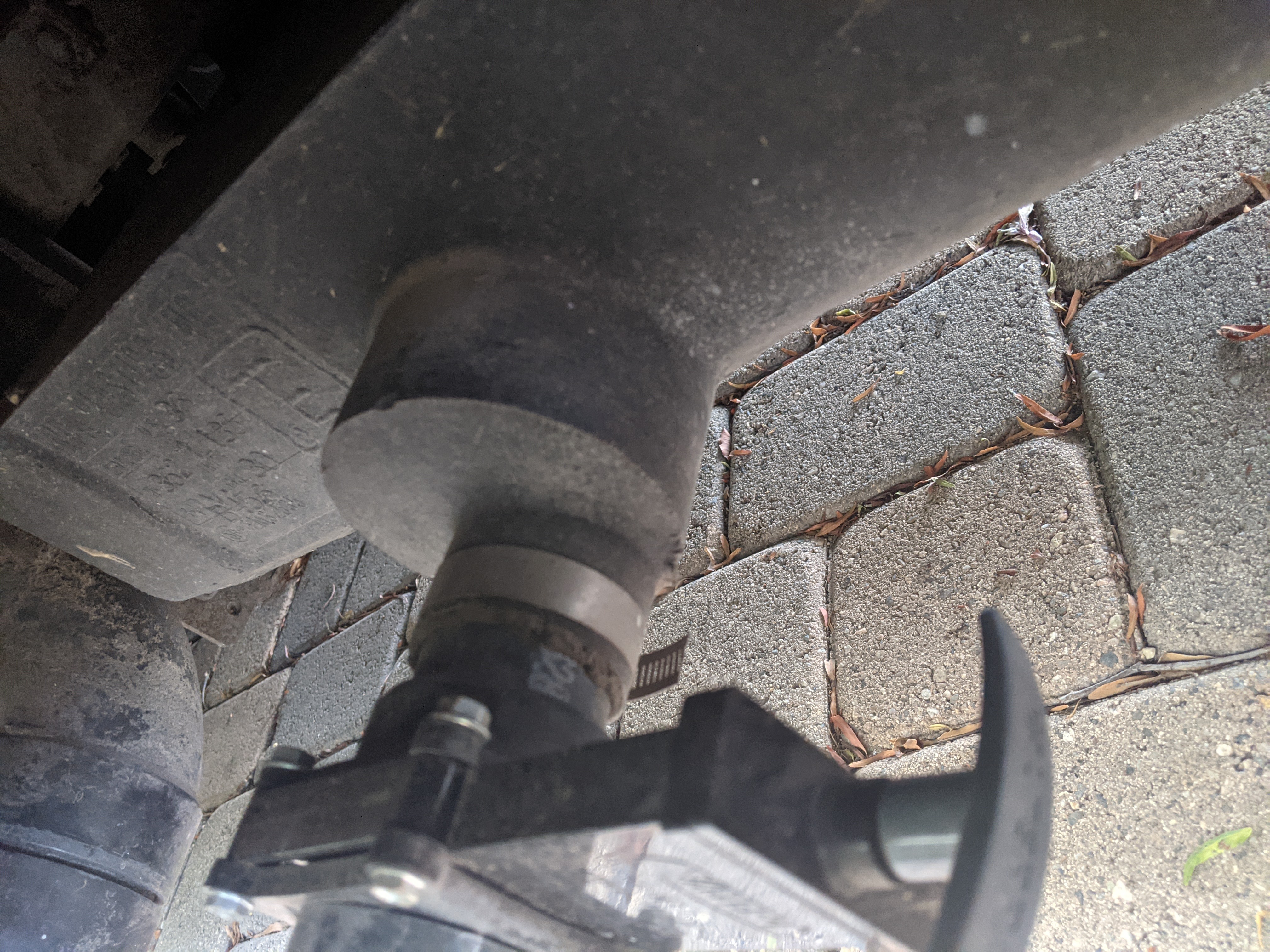

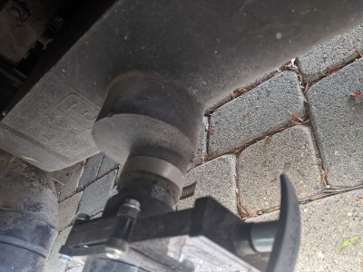

Here are a couple of pictures from the passenger side showing the tanks and brackets over the MorRyde stabilizer bar. Here is a pic of the gray water drain pipe exit

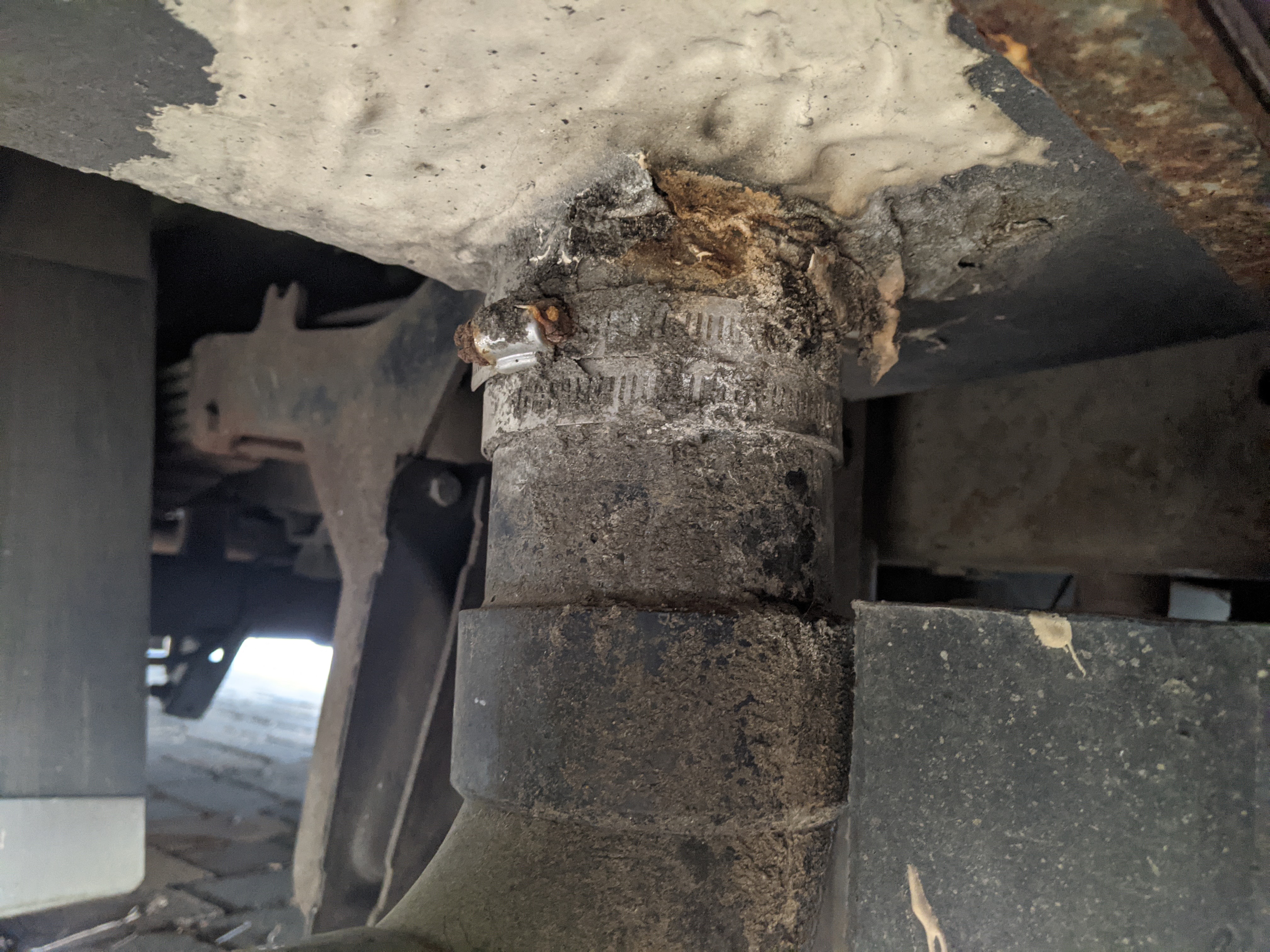

This is one of the black tank exit, but I hope yours looks much better. My blank tank had cracked and this was the previous owners repair. The main pipe recently cracked, but my repair doesn't look much better.
If you have the black cleanout port, the pex tube runs down from the rear storage behind the rear bumper and up into the side of the blank tank. I thought I had a pic of the valve connections, but I can't find it. I changed mine a bit when I fixed the latest crack, and my gray valve handle now sticks out at 45 degrees.

Thanks, Clay. Actually, my black tank had a leak in that same area, and the patch(es) was equally ugly. And it didn't last more than a year. Problem is our tanks are LDPE, not ABS, so only plastic heat welds work. Glues will just not hold over time. I'm putting in a brand new set of tanks this time.

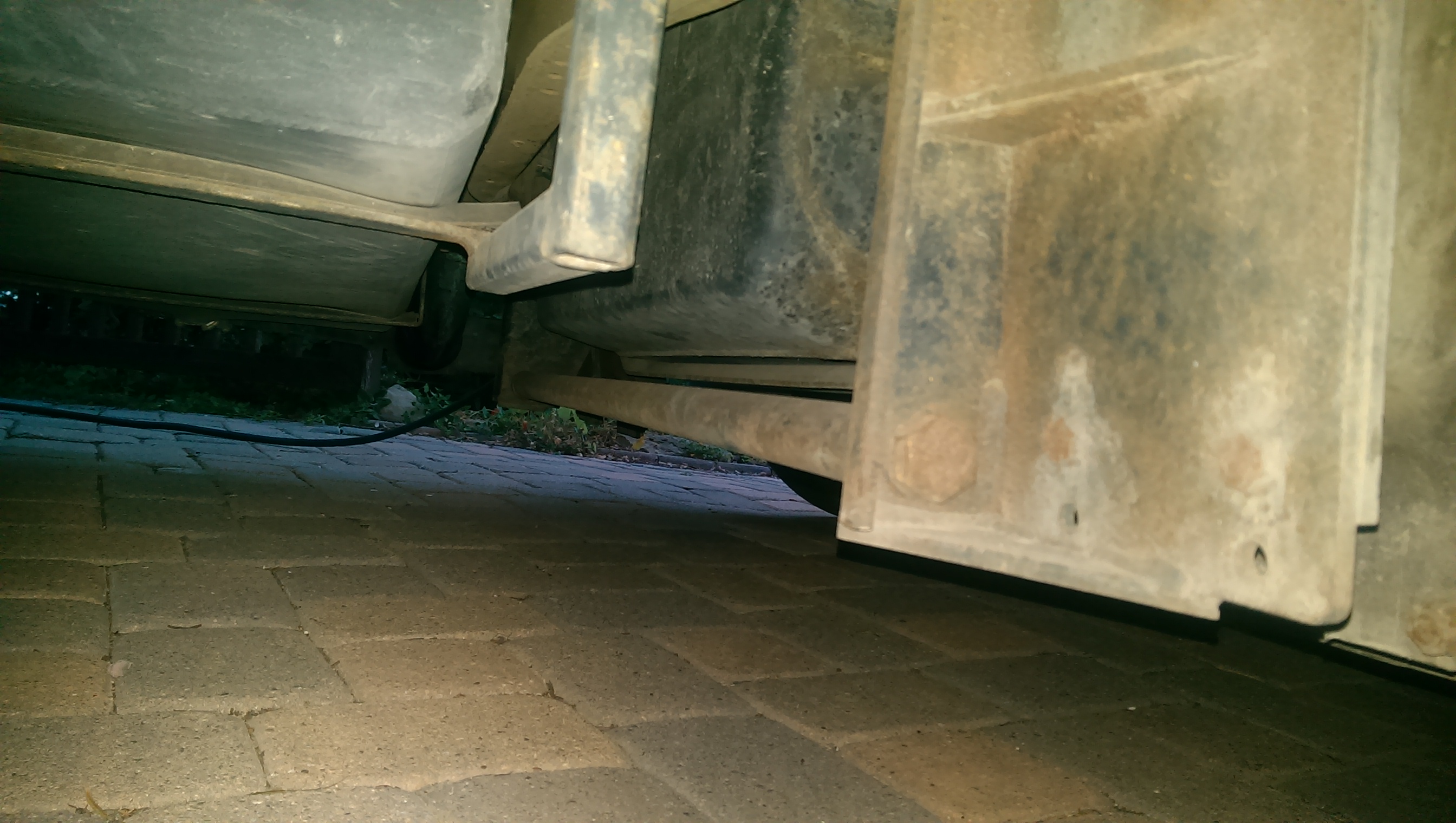

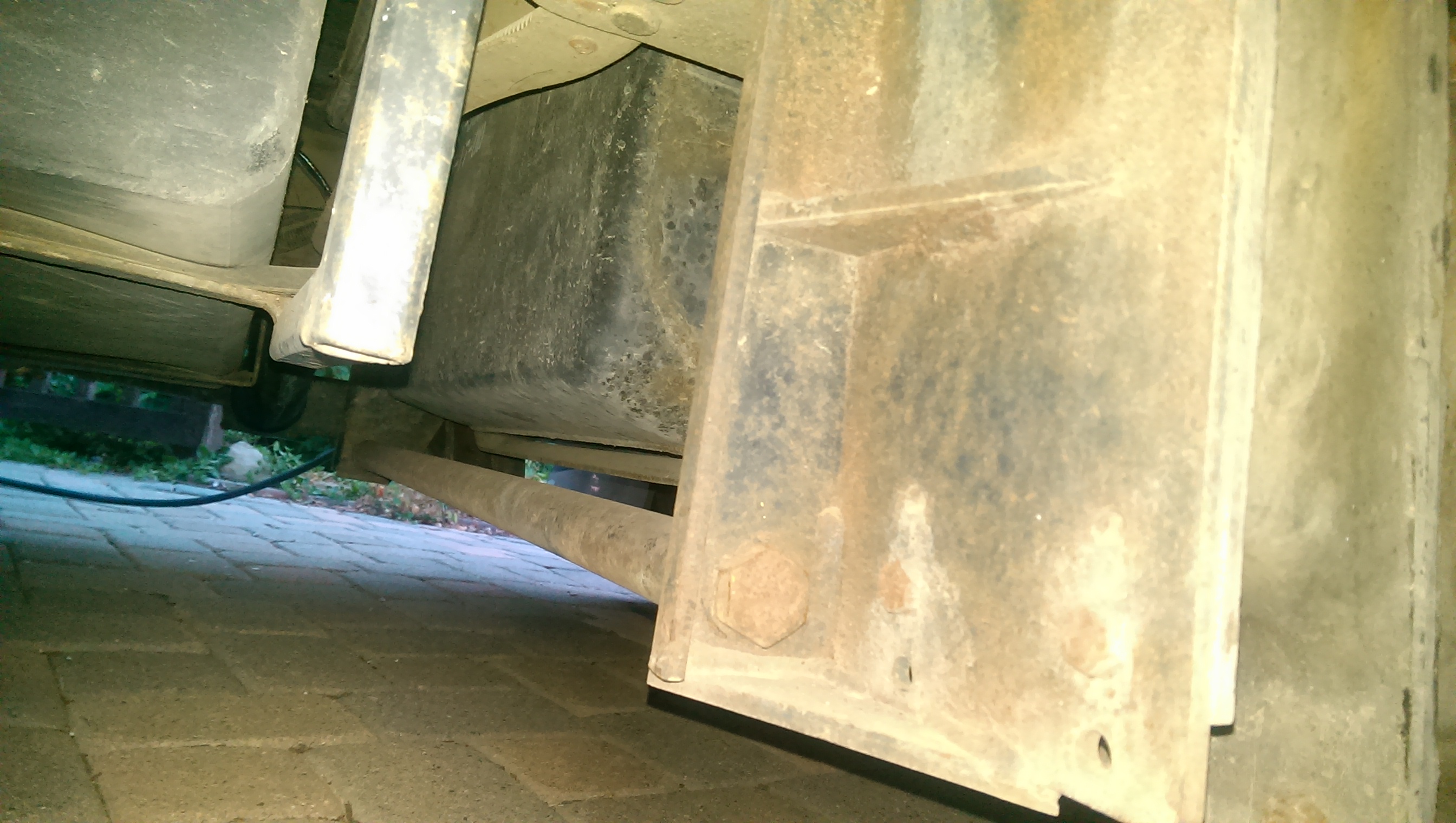

Hope these might help.

Thanks, Terri. Looks like both of you have just 2 bars holding up the gray tank. I have those (kind of rusted, but they still look strong), just didn't seem enough for what must be 250lbs or more when the tank is nearly full.
